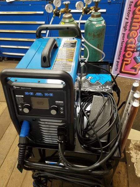

All three! Miller Multimatic 220 AC/DC Multi-Process Welder 907757 I bought this in 2021 at Carlisle from the guys at Airweld Inc. At that time they were hard to get. If you plan on using a welder for a long time it's a great investment. You can do it all Stick, Mig and Tig. I still have my Miller 35 I bought around 1990. I have had Miller 180 tig, several 110 Migs and huge Hobart on a boom. I have liked most even the cheap ones have their place. You would be happy with a Mig but if you want to try Tig and do you will want both. If you look at used check to see if parts are available. A 35 like I have can be bought cheap but if the gun is original you will need to upgrade, I had to add a gas solenoid and a Benard gun. If you're not looking to invest in a Multimatic and looking at new look at the duty cycle when comparing welders. I am not a fan of flux core welders but they can work. With tanks there is a cost. You can rent/lease or own. Either way you pay, either a lease payment or for hydro testing. Another thing to consider is resale. In a year or so you decide a welder isn't needed, you don't want to be stuck with the cheapest one or something that is unknow in your area.

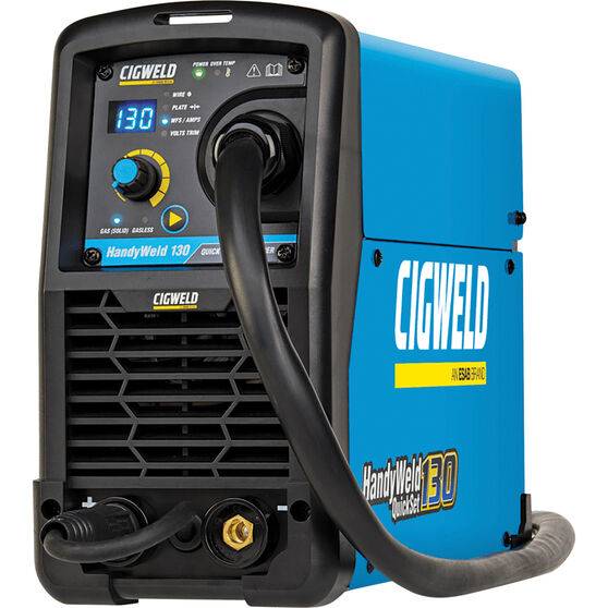

Supercheap has a special ($399) on for club members who buy this small 130 MIG. It's good for small jobs. I can't weld for crap...I give small jobs to my 15-year-old daughter who likes making go-cart frames.
You can sign up for membership instore before you buy and still receive the discount.
