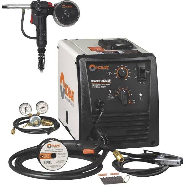

Bought the Hobart 210 MVP. Multi voltage and a spool gun for aluminum. It works awesome.
