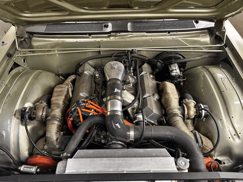

Looks like it will cost you about $14k and a trip to MN
NOT MINE
