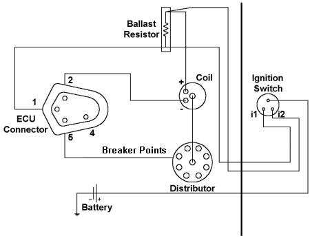

I've never tried it but you can use the Mopar ECU with points:
Oh that’s interesting. Thanks for the suggestion! I’ve already gotten all the parts to do a HEI with an electronic. I’m pretty excited about doing this, it’s something I’ve never done, so the research and thinking is fun!
Also the "shorting" wire inside the ballast need not be any lower gauge than the wires connected to it.
Actually that’s what Mercedes SL’s using d jet use. They have a points distributor, that fires the ECU.
