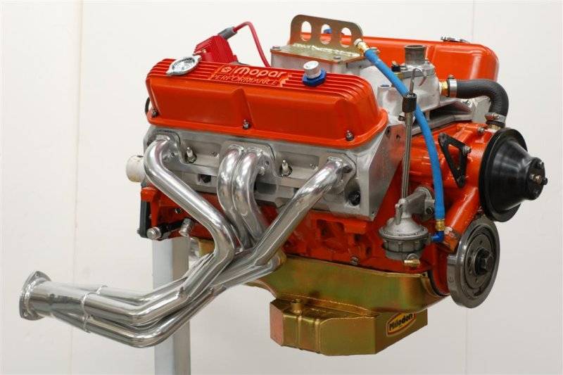

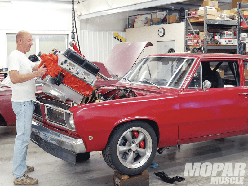

BTW, the small block stroker buildup on that car was covered in 1 (2?) issues of Mopar Muscle magazine written by AndyF (and built by AndyF).... R-block, 4" stroker, Edelbrock based heads, Dougs headers, milodon road race pan, and more.
https://www.motortrend.com/how-to/mopp-1106-1968-plymouth-valiant-427-engine-swap/

Yeah the engine in Tim's car was a 427 inch SB with fully ported Edelbrock heads. It had a small cam and a small carb since it was a street driver with 2.94 rear gears. It made more torque and more hp than a Viper engine so that was good, but it wasn't at its potential. His car really needed a 5 speed transmission. With a 5 speed he could've gone with deeper rear gears and we could've put a bigger cam and carb on it and moved the power curve up a bunch. It was just super hard coming up with a combination that would pull 160 mph on the top and still be able to drive to work.

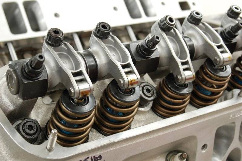

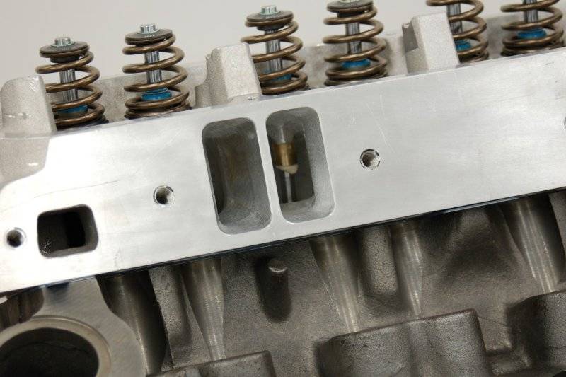

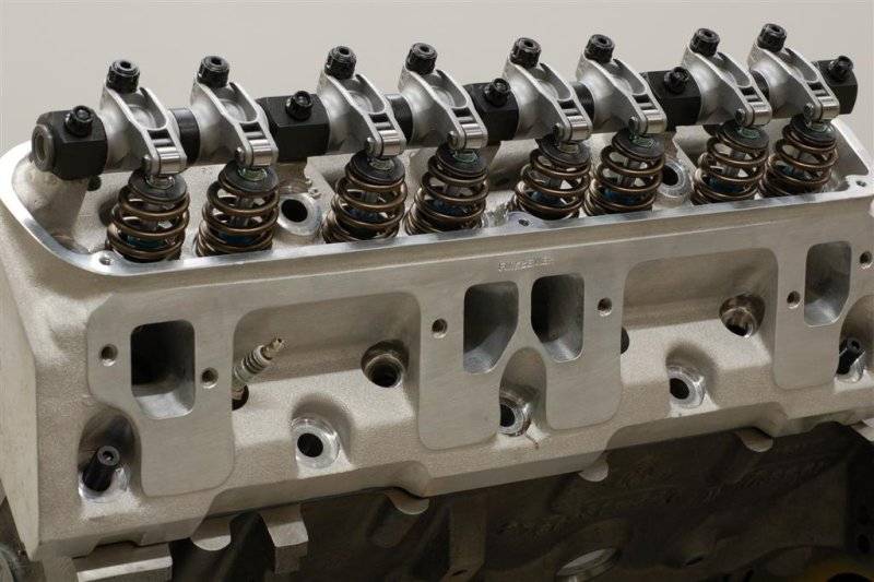

Where the heads on Tim's Valiant the Edelbrock castings that someone were machined to be a T/A offset rocker setup? And got rid of intake push rod pinch.
No, they were what Hughes called a Stage 3 port. I think it was before they started doing the "big mouth" head or else we would've gone that way.

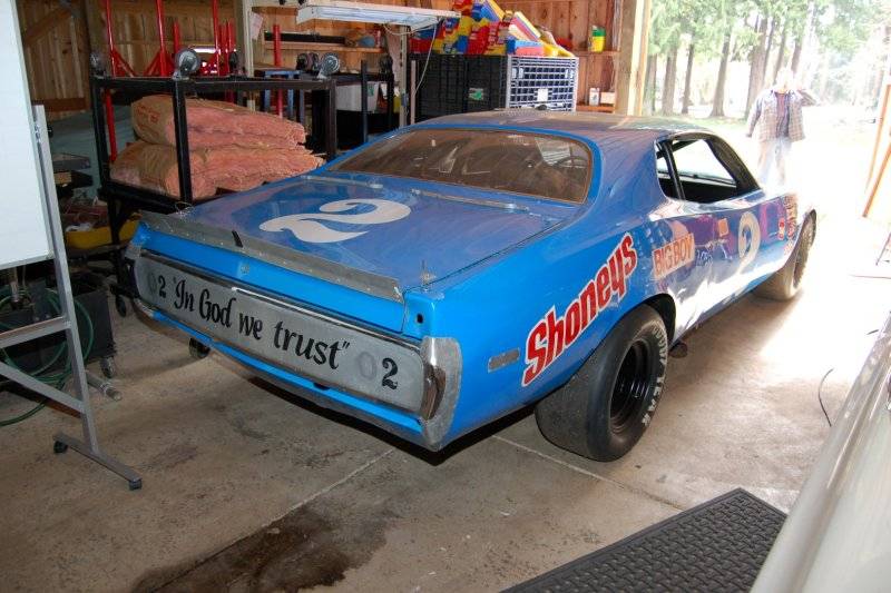

The guy who owns that car lives in the area. The car is complete but I don't think it has run in many, many years. It just sits in the garage. I tried to get him to get it fired up and on a trailer so we could take it to PIR for a club day. I think it would be wild to see that thing out running laps. But he just never wanted to spend the time to get it going again.

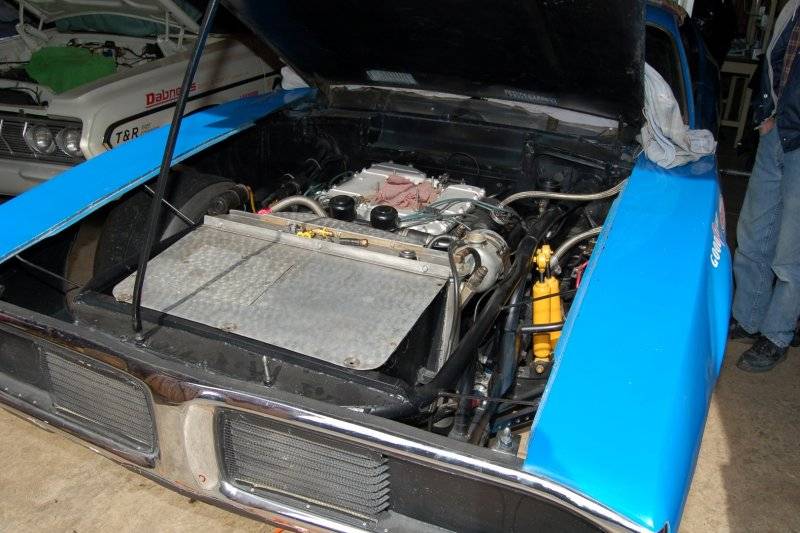

If you look in the background you can see an original MW race car. I think it is an aluminum front end car but I'm not positive. It has been a few years since I took these pictures.
I'd take a very good guess it's a aluminum nose MW knowing that owner.

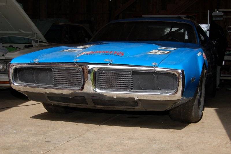

So the blue Charger racecar has been sold since that pictures and it's down in So Cal-ish area? Or still of in PIR area.
The Shoney car could be sold. It has been several years since I last talked to the guy who owned it when I took these pictures. He retired and I moved so we just don't see each other anymore.
