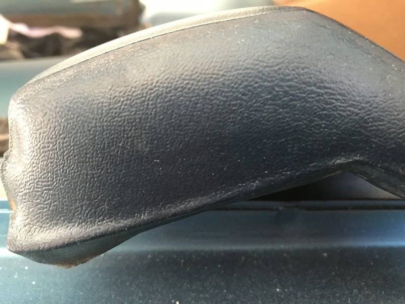

I am still trying to get the correct color paint for the dash pads, arm rests, console, etc.
Here's a close up picture of the lower dash pad color.
Any idea what the color code is and where I can purchase it?

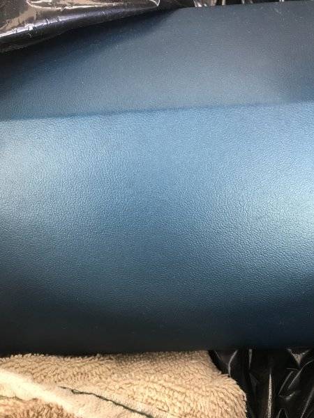

Here is the color of the glove box. I took a picture of the side of it since it was quite worn out on the front.
I'm not sure what this color code is either though I think it is a Teal Blue from previous discussions.
Anyone know who sells it?
The dash is what's called Suede finish... If you read the little header it tells what components got what texture..
Bahama Blue Poly

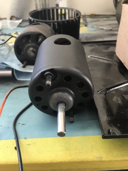

Okay, another question for y'all.
The old blower motor on the heater box was seized up solid. I ordered a replacement for it but the vent hole on the motor points in the wrong direction when installed.
In the picture notice that both motors have the vent up toward the top, yet the mounting studs are pointing in different directions.
The original motor mounts so that the vent hose installs, the new motor makes it impossible.
Since I cannot find a part number on the original motor I am having difficulty finding a replacement that will fit.
I had the same issue but was able to find a NOS motor... But I found that probably 18-20 years ago... I'll see if I can dig up a pt #...

Hello! Yeah, lookup a place in Marrietta Georgia called Vinyl Pro, and the guy that mixes the SEM colors will fix you up!
I used a Dupont product called SpectraMaster. Came in a dizzying array of choices.
I can’t speak to the accuracy of the color match, but OER only offers vinyl paint in light blue and dark blue for ‘68 Dodge and Plymouth. Your photo looks like the light blue, the dark blue is more of a navy blue color…
Light Blue
68 Dash pad photos, if you need any other details let me know.. BTW the angle in the last photo is ten degrees
Thanks, I saved the pics in my reference photos folder.
When I get around to doing the other dash pad, I will spend some extra time to try and get it perfect, if possible.
If it turns out great, then I will paint it and swap it out for this one.

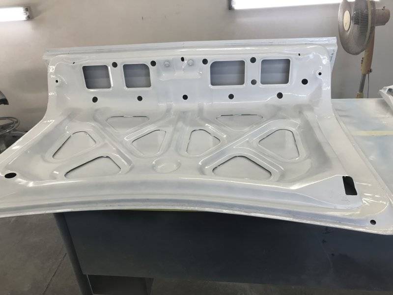

While waiting for parts on the heater box, I decided to paint the trunk lid and quarter panel extensions. Here's the inside shot with reduced epoxy primer as a sealer coat. By the way its 97 degrees out and about 90 degrees in the booth. Ugh!
Lights and sun reflecting make it look like there are issues.
So I took a close up with lights off just before the sun set.
I plan to paint the other side tomorrow.

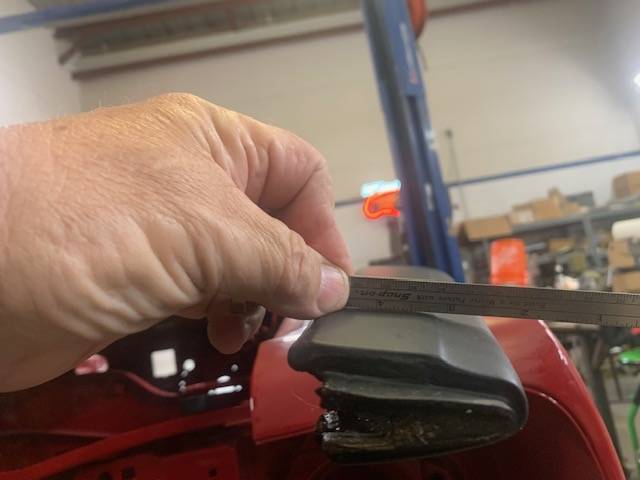

Installed the trunk lid and seal.
The lid looks fine side to side and along the rear deck panel but it too high at the rear.
Raised the catch on trunk lid as high as it will go but still need about 1/4" to get it in the right position. Any suggestions?
