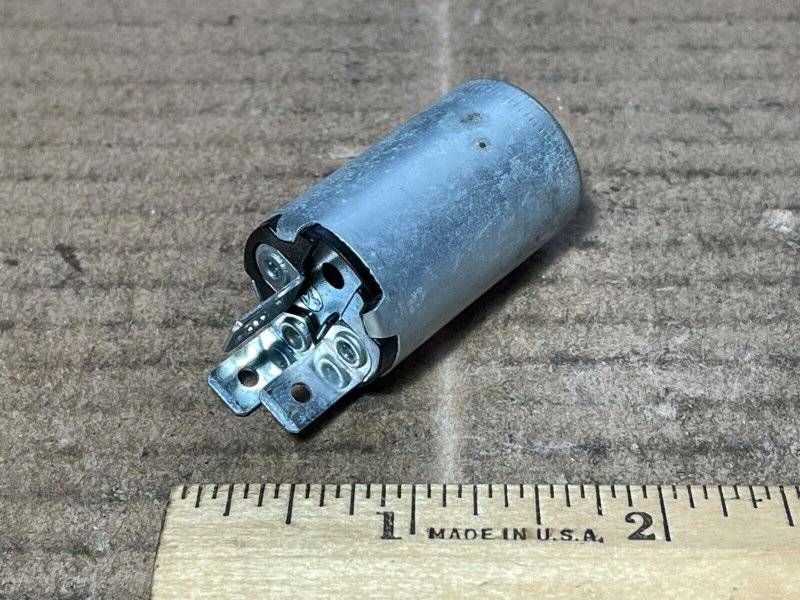

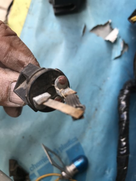

Can someone identify this for me?
My guess is wiper circuit relay for 3 speed wipers but after looking at the wiring diagrams so long I cannot see straight, I still am not sure.
My guess is that it is the timer for the ignition switch light. Should be an aluminum can around it similar to a turn signal flasher switch.
Oh, that's what your asking about... Three wires, the yellow wire powers the ignition switch light that the red arrow is pointing at... BTW that's a 68 only light...
Found one on eBay:

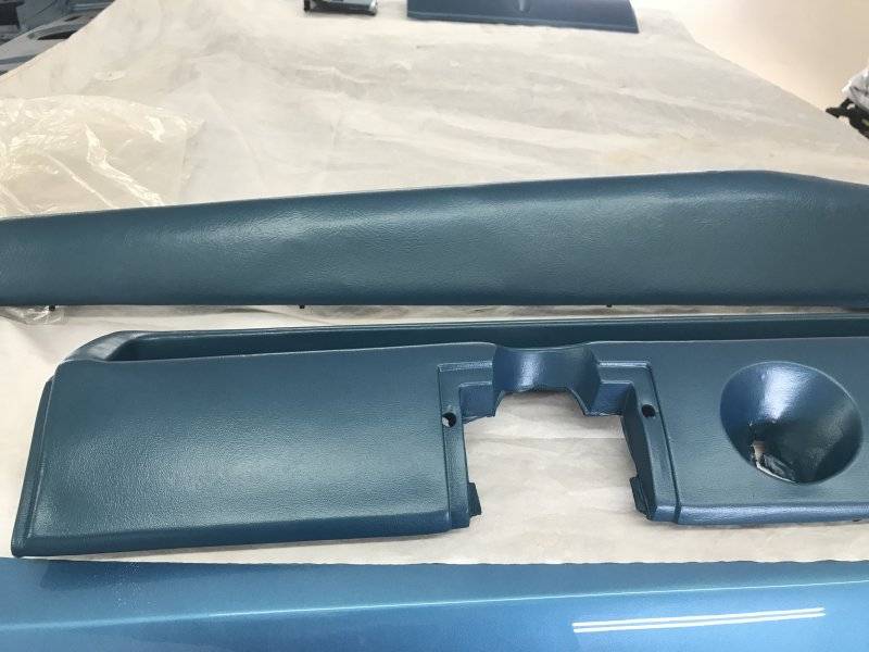

A couple of pictures of freshly painted pads.
The metal on the ashtray is painted with the same Bahama Blue Poly Suede paint as the dash structure is.
This teal Vinyl Paint goes well with it.

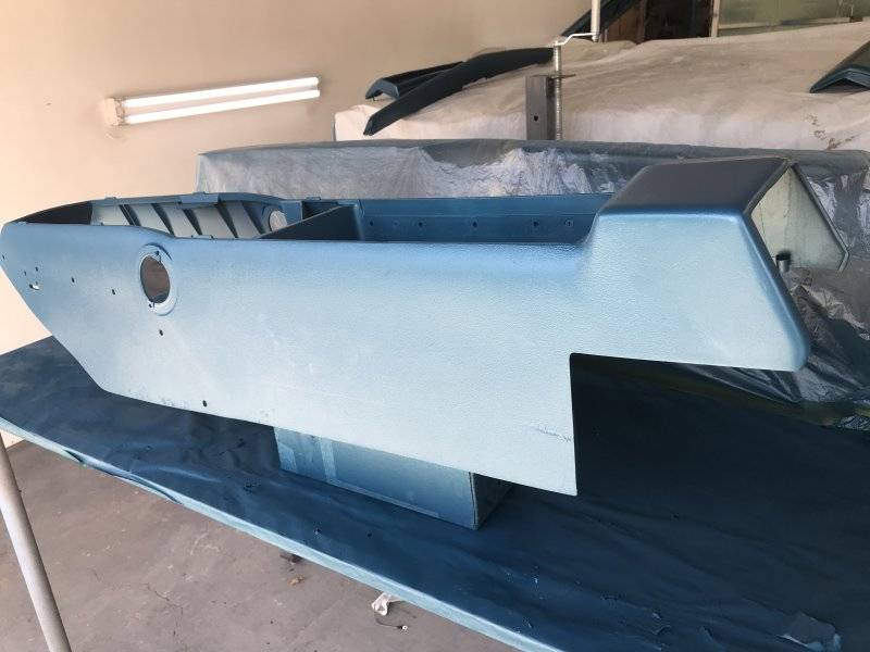

Repainted my console with this as well:
Once everything cures I can start assembling the dash and console.

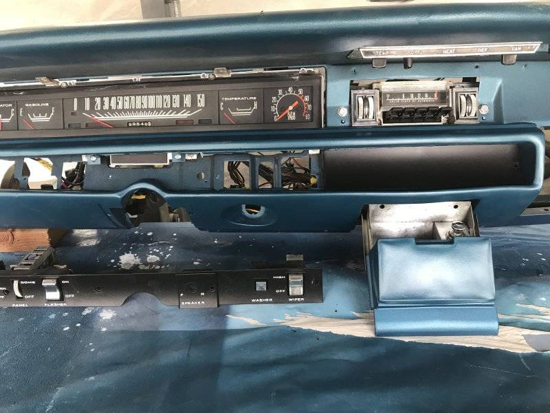

Working on reassembling the dash a little at a time.

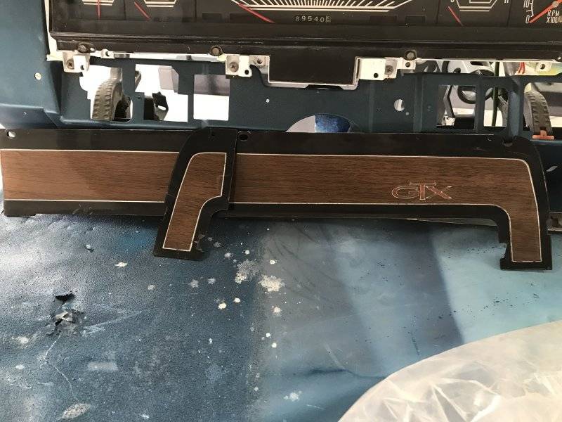

Looks like I will have to go with a '69 radio bezel as I cannot find the correct '68 one.
Sorry if you mentioned it, but do you have the 69 "hockey stick" and end caps too? The color of the wood between 68 and 69 are different IIRC.
The 69 bezel is more reddish. The 68 is more brownish. Ill try and take a pic of the 2 when I get home after work.
The one in your pic looks to be a 68.
Im going all by memory, so I may be way off. LOL
