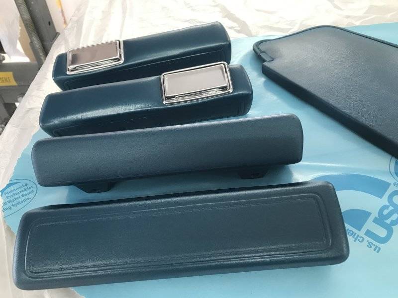

Painted everything Teal blue today using the SEM Vinyl Pro paint.

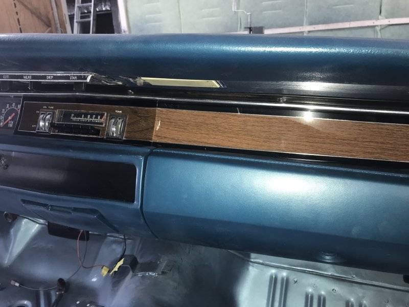

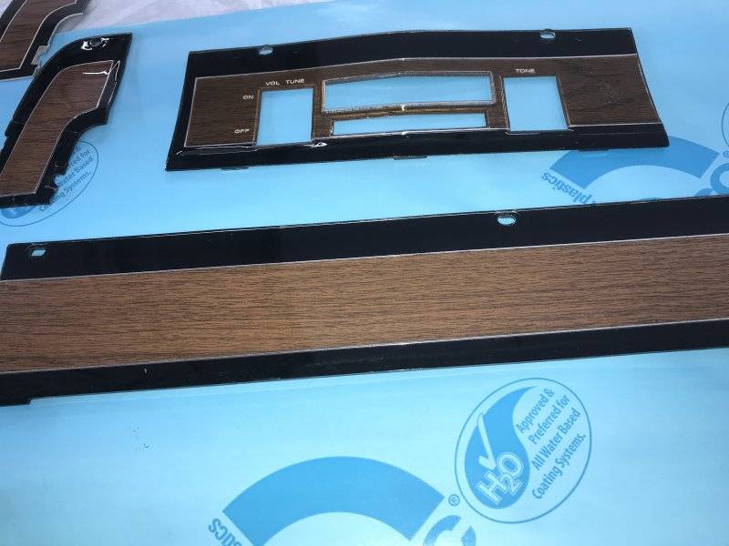

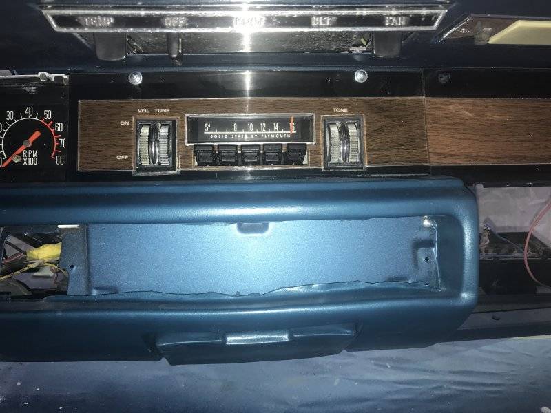

Tomorrow I hope to get some clear sprayed on the woodgrain dash trim. Trusting that will make it look better.
Cleaned it up and sprayed adhesion promoter then two coats of clear.
Of course it didn't fix the mismatched color of the radio bezel but at least it shines now.

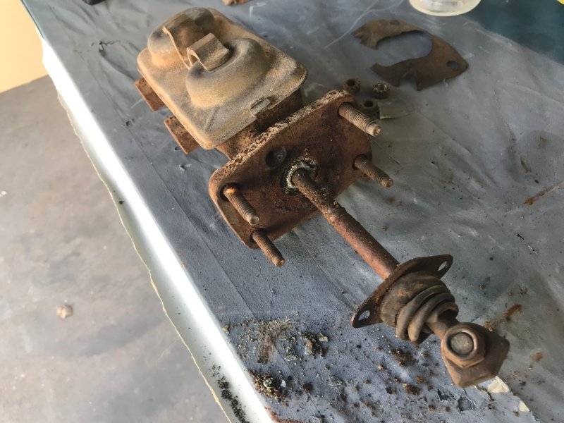

Pulled the brake master cylinder out of the crate today and it looks pretty bad.
The washer that protects the shaft bushing was so corroded that it disintegrated when I tried to remove it.

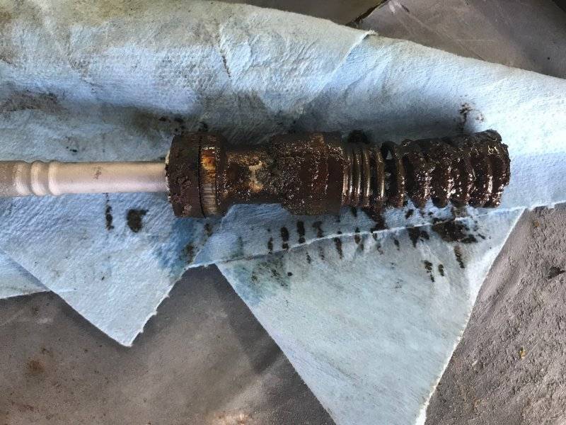

Inside was a layer of goo that used to be brake fluid.

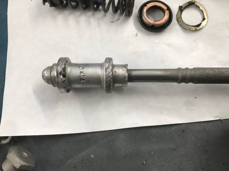

Plugged the outlet holes with proper sized bolts and put it through the blast cabinet.

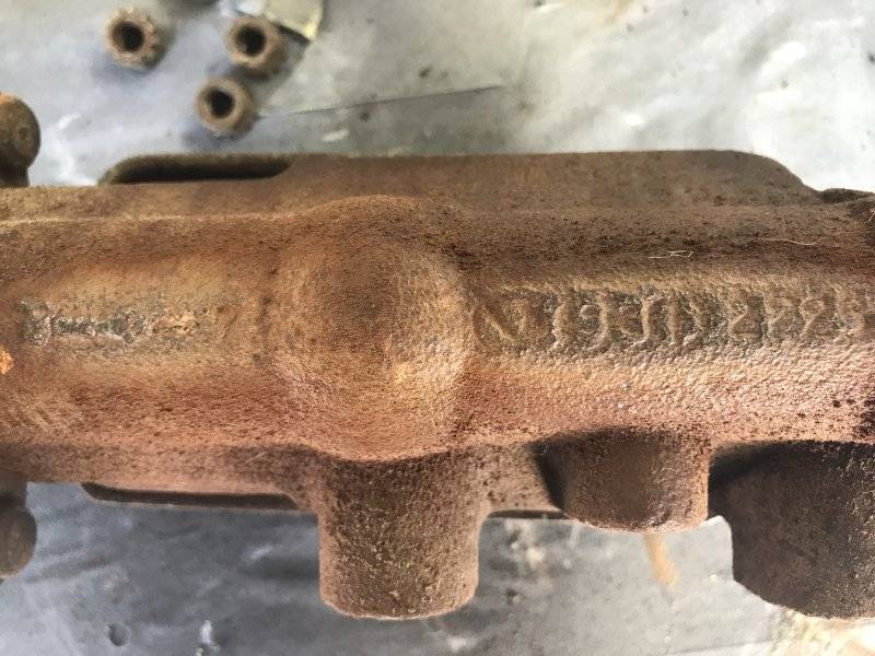

The number looks like it's 2225601 but I cannot say for certain if the fifth digit is a 6 or 8?

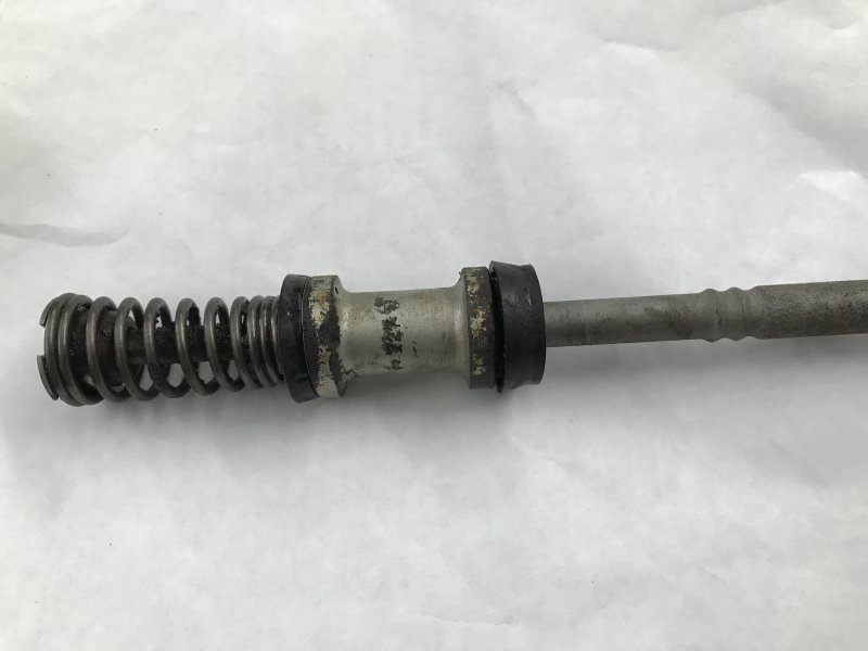

Here's what I have:
Looks like just two seals on it. Can someone tell me how to dismantle it?
Okay, I am now doubting if this is actually the original master cylinder for my car.
The ramman stated the 2225601 was for an A-body if I heard him right.

The Master Cylinder you have is a 68-70 Drum Brake unit...
I think if you measure the depth of the bore in the M/C you'll find it's much deeper than what you have removed... There should be another piston still in there....

There is another piston inside and I have yet to find away to get it out. Also I cannot get the push rod out of the first piston which is pretty eaten as you can see.
