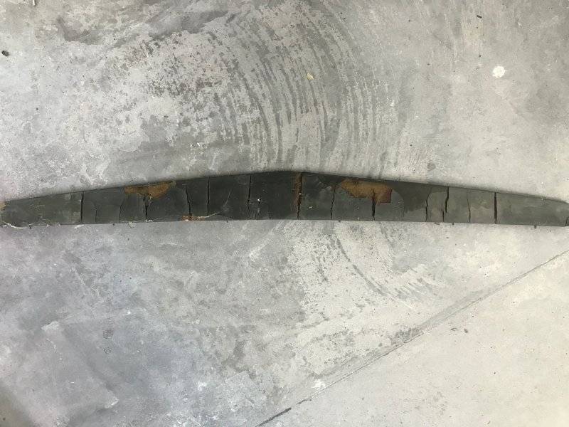

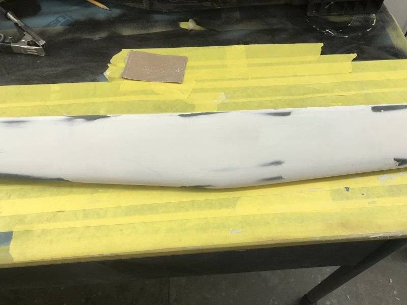

Some progress on the dash pad restoration.
Started with this:
Removed the loose vinyl and foam (a dirty and time consuming job) and then filled the cracks and voids with expandable foam. Removed the excess with a saw blade and sanded the foam level to the surface.
From there I applied filler and sanded everything flat and smooth. It took repeated coats of filler due to deformed areas through out the pad.

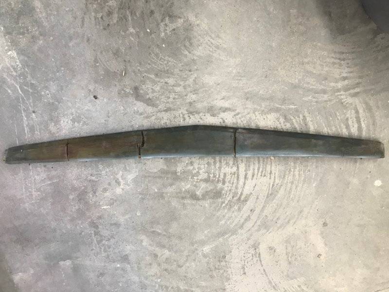

I have enough vinyl for three tries at getting it right. If everything goes as I hope it will, then I plan to restore this other old pad I saved from my signature car and then selling it.
As you can see it is in much worse condition and may require installing new foam as well:

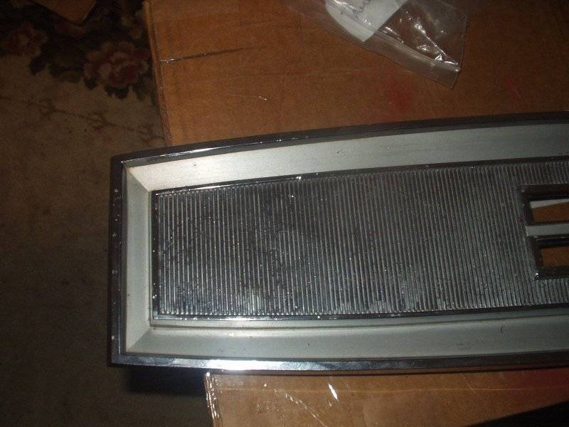

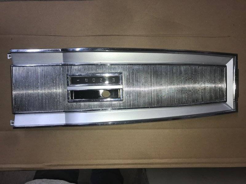

Yes, Silver Argent..
Looking at all the reproduction tops, I didn't see any 1968s with black on them.Now, how to paint the black in-between all the ridges LOL
My original in Baby Blue didn’t.I don't think the 68 console has any black in the ribs...
