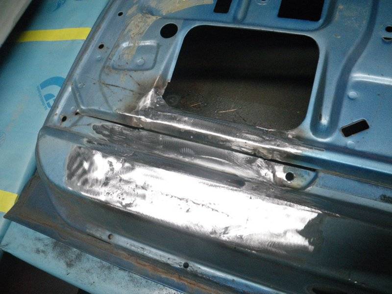

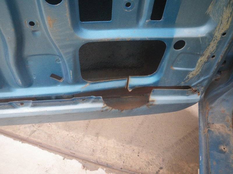

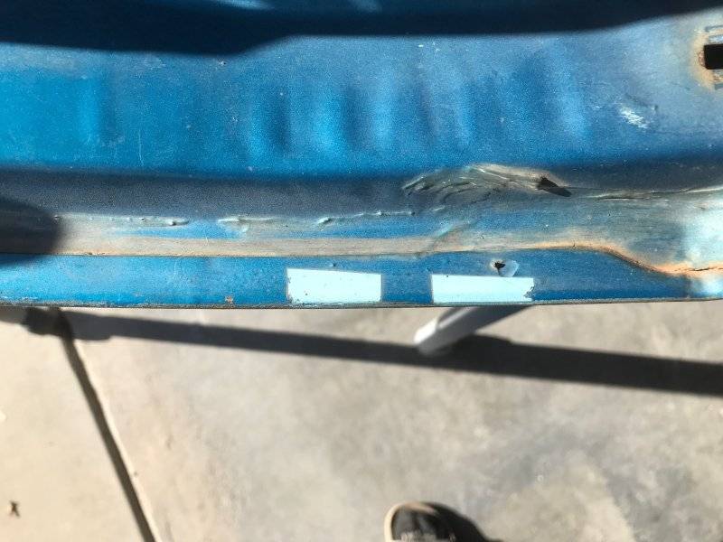

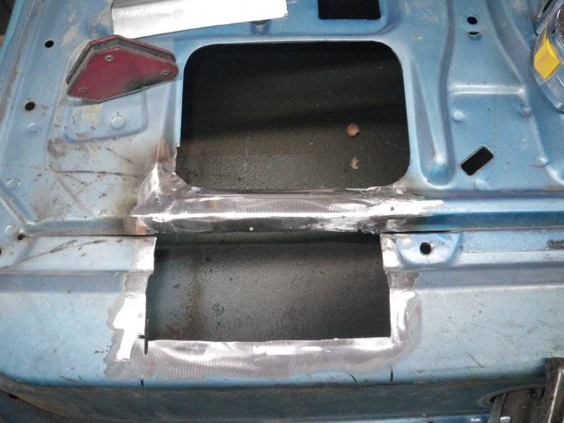

A pic of the repaired metal.
Driver's door:
Passenger door:
I'm not the greatest welder but I try.
They did the same thing on my rag top, I couldn’t believe the radio shop up the road did that and then covered it up with the door cards, and of course a nice set of rear interior panels got hacked too... you will have a beautiful car when done!

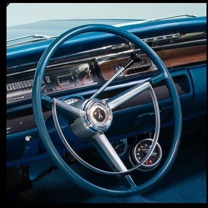

I did a search for 1968 Plymouth GTX then browsed through the pictures. This was one of two pictures I found with the same horn button. The other picture was in a weird format that I couldn't save on my computer.
Close up:

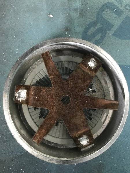

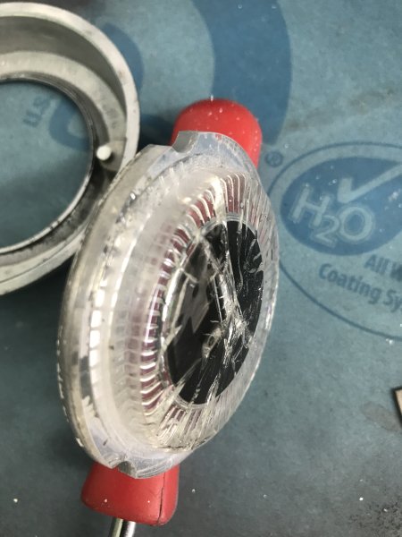

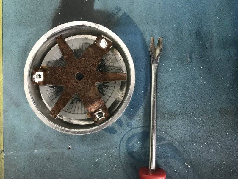

I took the horn button apart today to see what I am dealing with.
First, I had to grind off the retainer heads:
Next I gently pried the metal off.

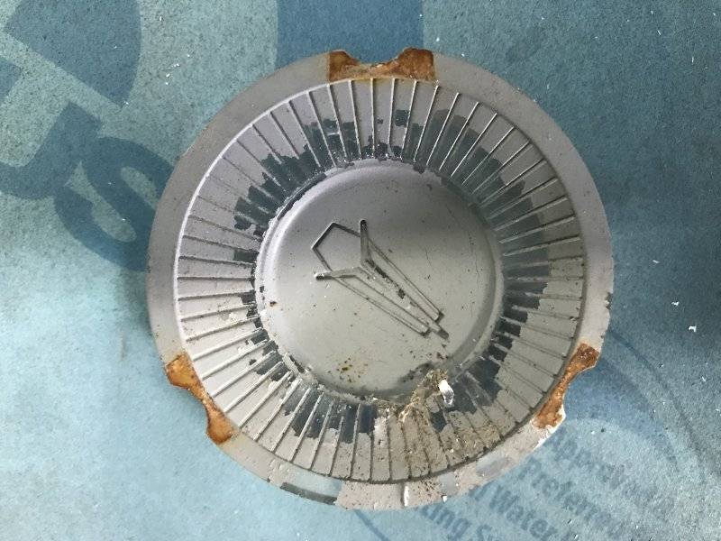

The areas that looked black turned out to be clear. The chrome paint and grey backing material had flaked off in those spots.
I tried buffing the surface to see if I could remove some of the scratches. Turned out most were way too deep.
The problem with trying to mold a new one, is all the slotted indentations. That and trying to find a true Chrome paint to fill them with.
My '67 Valiant had the identical style, it was upgraded with a 200 series decor package in some areas. Perhaps someone doing a build from a preserved old lady car might have one that would work.
Close up:
I have a February '68 issue of Car Life that featured a comparison between the Hemi convertible which was also a pace car, and a 440 hardtop. The hardtop had the same horn ring, and also had the speedometer with the three digit numerals.

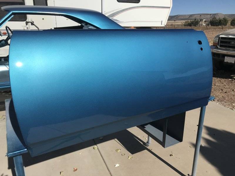

Got the driver's door painted and 3 coats of clear applied. Sitting in the sunshine to help cure the clear:
