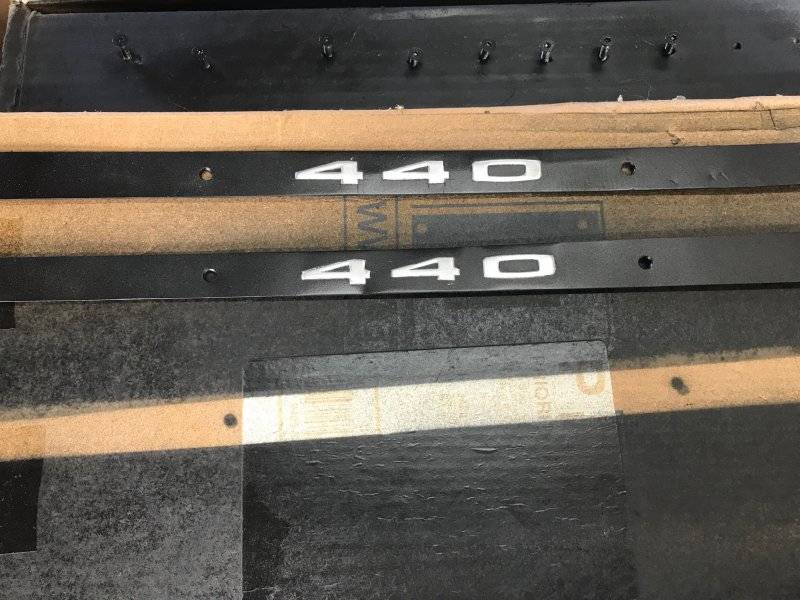

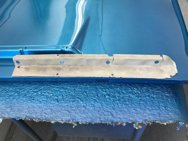

Here's what was on there when I got it. There was only one side that had it.
I'm trying to find the 8-32 x 3/8" flat head screws that hold the 440 call out emblem in place. I see places selling them with the new emblems but not listed seperately.
I guess the center doesn’t need to be open if there’s no Air Grabber. It looks kind of frail so finding used ones in decent condition would probably be almost impossible. If you just want to avoid paint to paint contact the one I posted last night would work.
I'm trying to find the 8-32 x 3/8" flat head screws that hood the 440 call out emblem in place. I see places selling them with the new emblems but not listed seperately.
Follow the link...
Already ordered them. Thanks
Follow the link...
Yes, I looked there but didn't see the correct head diameter. The originals were only 3/16" (.1875) and the smallest I saw listed were 5/16" (.312).
Trim parts sells the 383 call out emblems and includes a package of screws that look correct. Tried searching for just the screws but haven't had any luck yet.
Extra info, reduced head diameter screws do exist but an 8-32 might be tough to find... Especially in black oxide... If you don't mind painting them it wouldn't be hard to modify a few standard screws in a lathe...

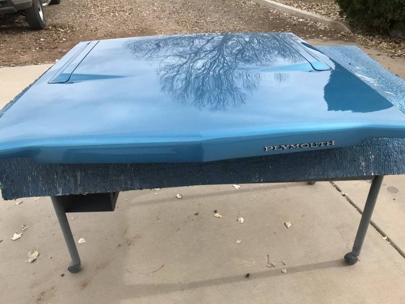

Wet sanding the clear on hood.
First round was with 1000 grit using a hard block (piece of Oak about 1 1/2" wide, 5" long and 3/4" thick). It is easy to see progress because the surface is dull with no shiny spots.

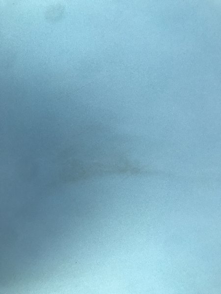

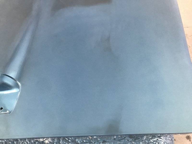

The second round is 1500 grit using a soft block. The goal is to remove all the 1000 grit scratches so I use 3M Dry Guide coat.
You can see how it highlights the scratches I missed.
I will do the same with the 2000 grit and then go to buffing.
Have you ever tried the Trizact system? My buddy who's done this stuff for 40 plus years likes to cut initially with conventional color sanding materials to knock down the biggest texture then change over to the Trizact DA paper..
Yes, however on this car I feel more comfortable doing it by hand.

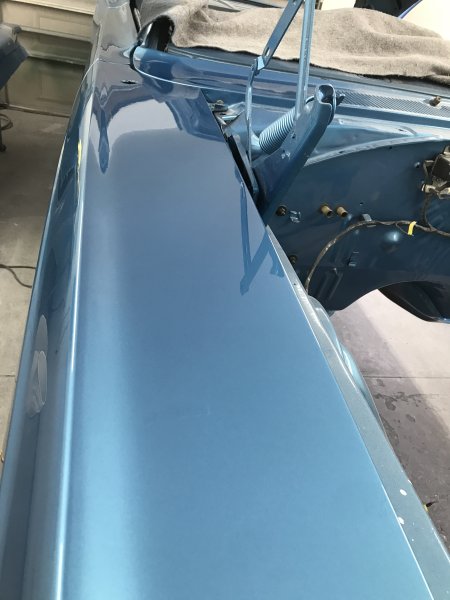

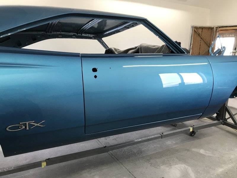

Passenger door and fender cut and buffed.
This is after buffing with twisted wool pad on a rotary buffer with Meguiars M100. I will follow this up with Chemical Guys V36 and then Menzerna 3800.
Passenger door and fender finished buffed.

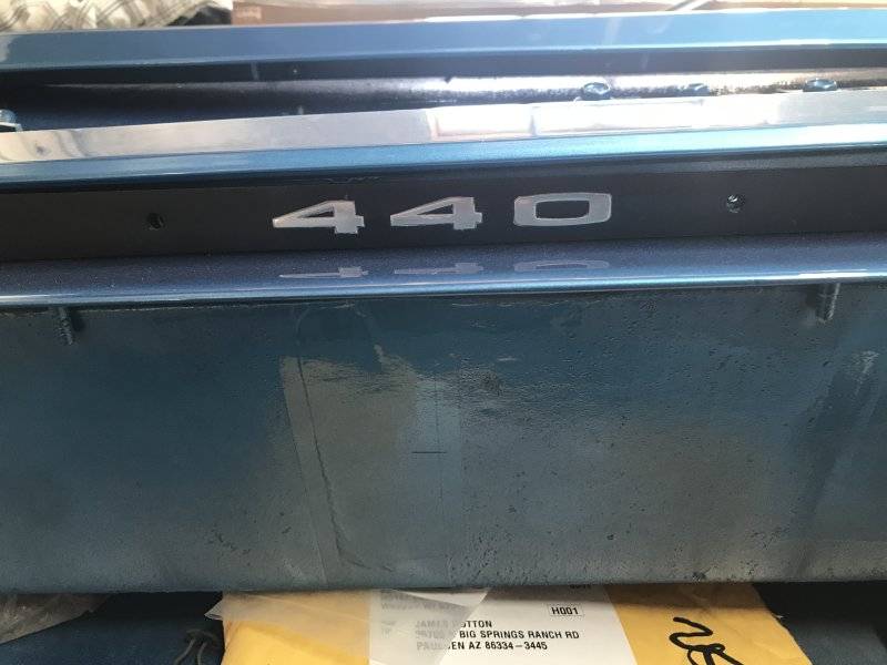

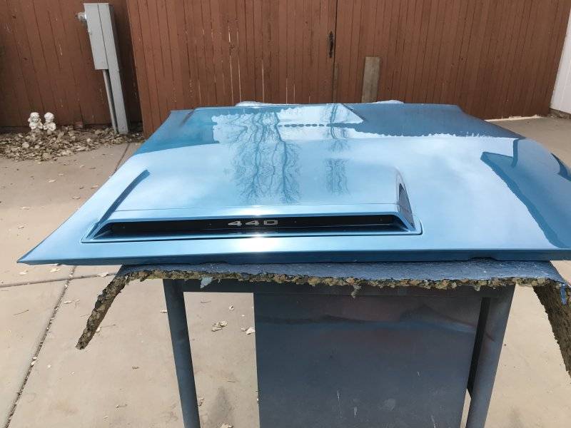

Hood inserts installed:
