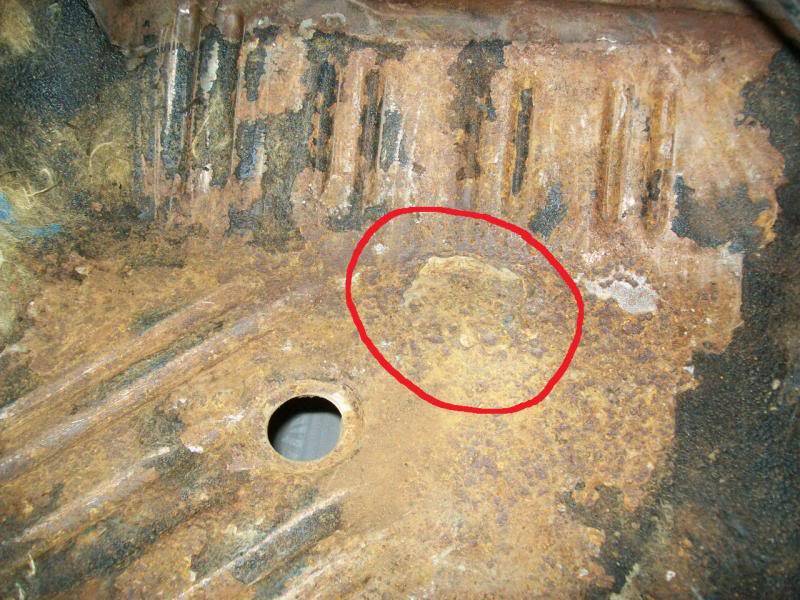

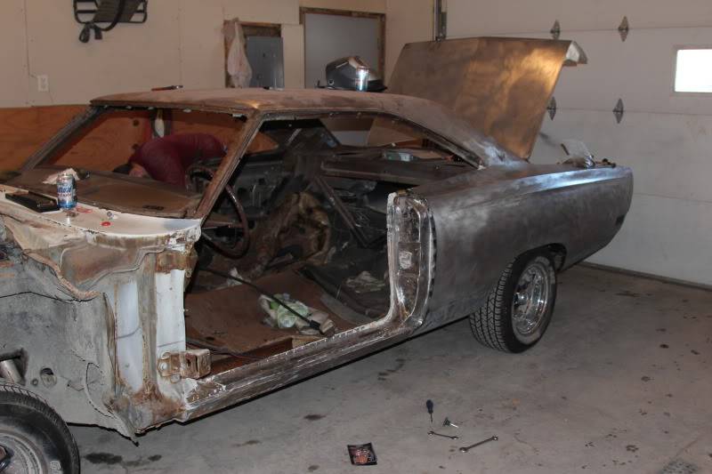

I pulled the seat and peeled the front half of the carpet back.
Someone has undercoated the hell out of the top side of the floor.
I had to scrape like hell to expose some kind of bad news.
I need to cut out and make a little patch for the passenger side.
And I need to order a front pan for the drivers side and replace this area.

Well, I got curious about the undercoating on the top side of the floor... had to start peeling further.

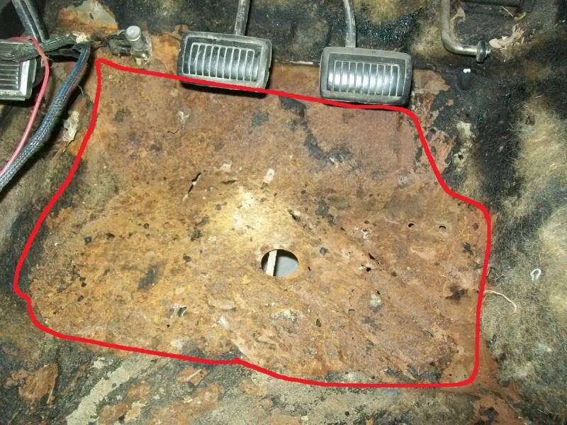

I'm glad I did because the driver's floor wasn't as good as I thought it was.
I won't do a full pan, I'll cut roughly the area I marked out in red.
Which will force me to scrape more undercoating top and bottom.

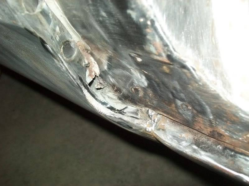

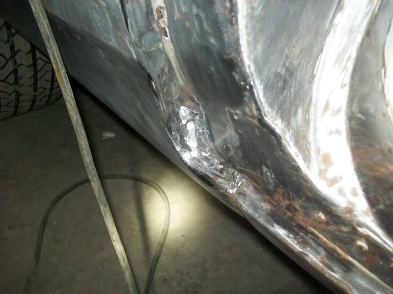

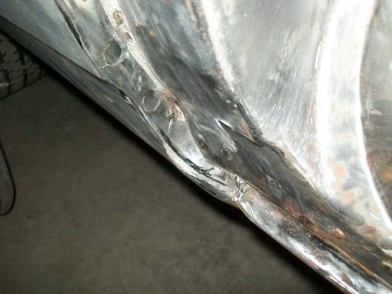

Well I took care of some misc patching that needed to be done today. No glory but the little jobs need to get done too.

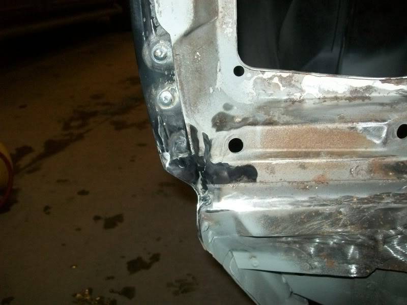

My quarter skins didn't reach the bottom inside corner of the door jams so I has to make patches for both sides and weld in, very small patches.
Still though, better than spanning a hole with a bunch of filler.

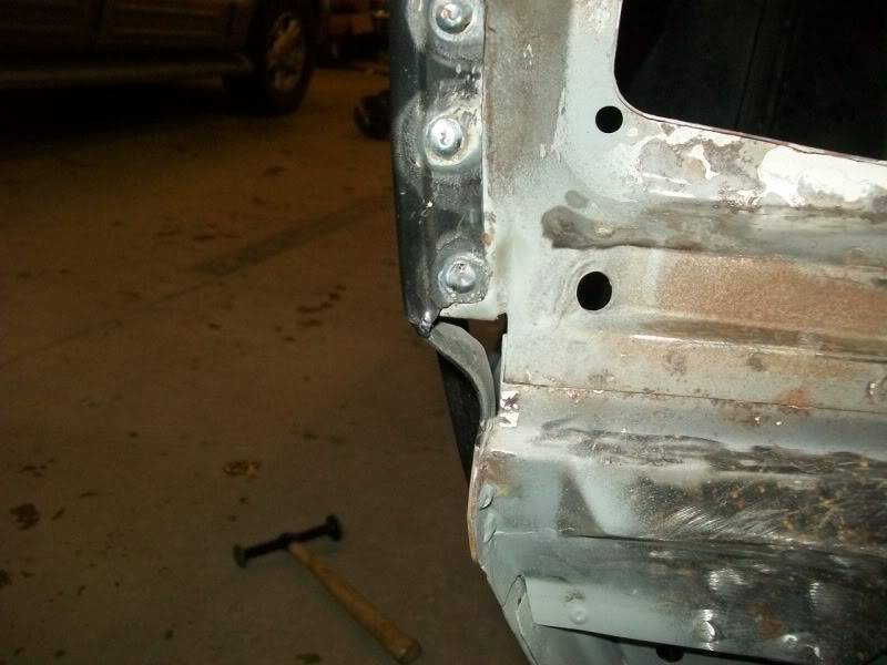

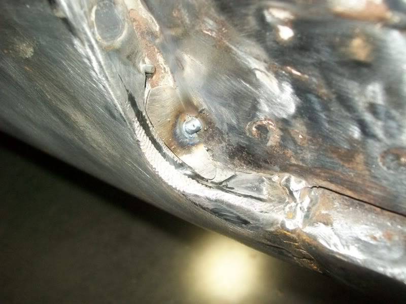

I did both sides like this then turned attention to the rear of the quarter skins where the skins don't reach the tail pan.
Again, very small puzzle pieces but the little things gotta get done too.
Real good work Dave....Looks good!

hey dave,looking nice on those seam welds,they can be a bugger to get right. On the carpet issue,my orange/black RR has black carpet which ties into the black vinyl top. My other 69 RR which is f6 or f8 green and saddletan interior and is a 4-speed car is s'posed to have black carpet.hope that helps, but if the bronze carpet looks better than that would be a good choice too.
