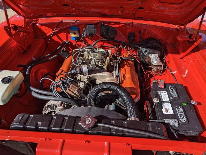

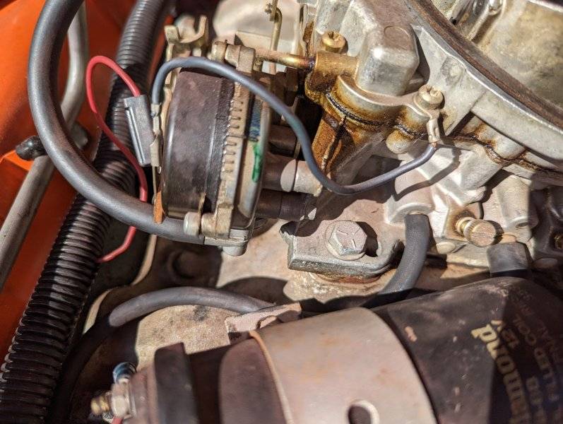

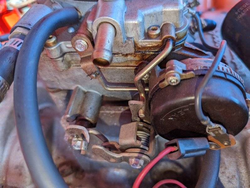

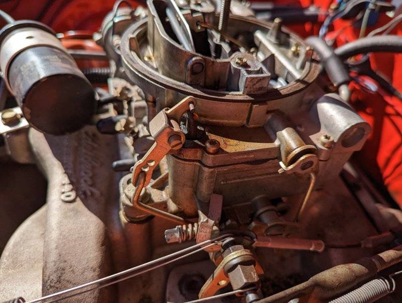

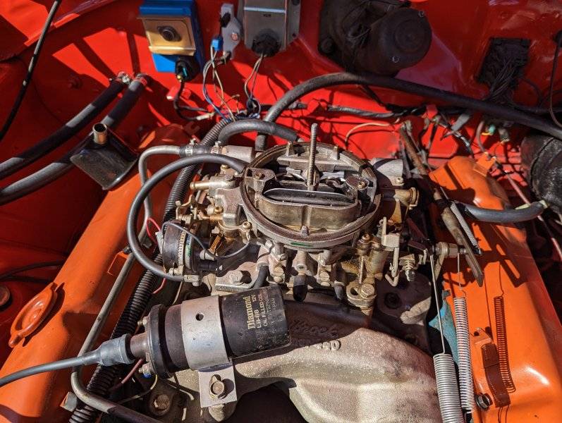

I took pictures of the engine compartment while at the gas station.
IMO.....looks as if the previous owner was the victim of a "carburetor expert", who knew nothing about carb installations. The PCV, distributor ported vacuum advance connection were not connected (inopersyive PCV connection will cause a extremely rich micture especially st idle) to anything, and on the choke side of the carb, the bowl vent connection wss not utilized. DO YOU HAVE ACCESS TO THE ORIGIONAL CARTER AVS CARB? The carb presently in use is an EDELBROCK (aka "Eddy", for those that do not know how to spell or the Webber manufactured unit).performer series. The origional Carter AVS CARB used a well choke which, in my opinion was a superior design. I believe, to use a Holley design carb may require an intake manifold change due to a different mounting flange configuration and throttle bore alignment. BTW, the kick down linkage linkage on the throttle cable side is incorrectly oriented and will cause transmission shift point issues.

Thank you Bob - good stuff. How can you tell it is an Eddy or you just know? My mechanic thought it was a Carter probably because he thought it was original.
I was able to contact the second owner of the car and he said that in all the back in the late 80s, he had the original 318 engine 2 bbl swapped with a "1973 440 donor engine" and also they put on a new carburator on it at that time. So don't have any original carbs. The second owner also told me that he later had it converted to electronic ignition. The choke is electric too.

As far as the carb hoses, it looks there there are two places
