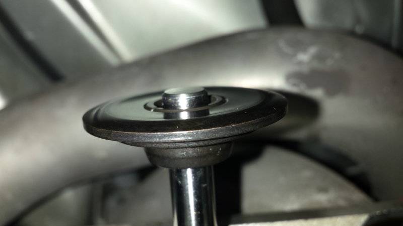

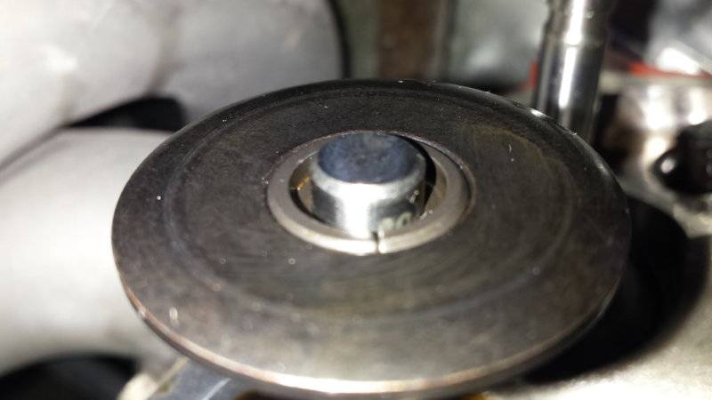

Dumb ?. Keeper groove in the valve stem. Are all of them cut with a bevel on the bottom side? Doesn't look right, unless something new.

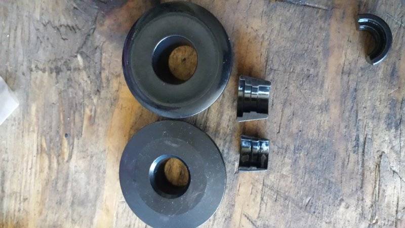

Once I get into the 400# range, I'm for sure a 10 degree retainer and lock man.
The present 7 degree locks appear to be the cheaper stamped locks and not the good machined ones.

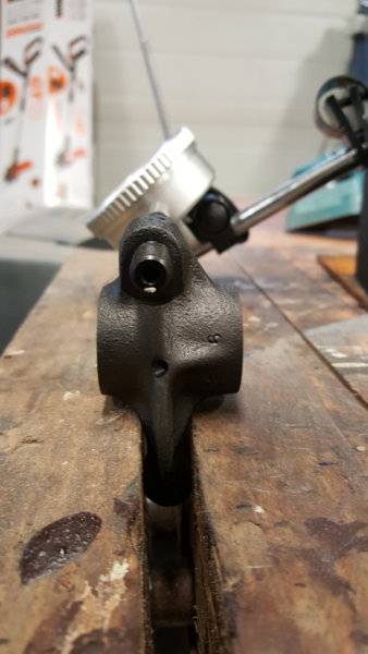

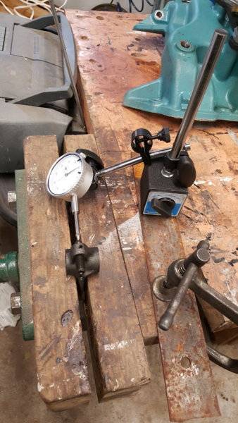

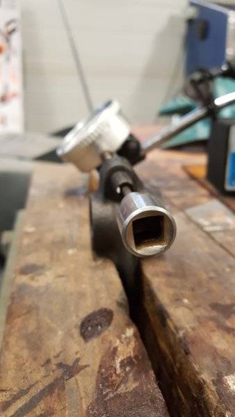

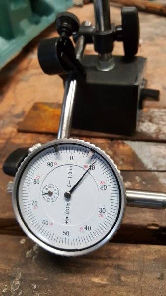

For fun, I also set up a dial indicator last night to see how my new crane rocker adjuster threads increase the distance to the adjuster tip. Not precise but a full turn is approx .040". For interest sake here are a couple of pics.
20180530_200450.jpg 20180530_200502.jpg 20180530_200502.jpg 20180530_200538.jpg 20180530_200541.jpg
Yes they are all the same.

10 degree hardware is ordered. The 7 degree locks are from Hughes and claim to be machined...from their website:
HUG 1322
VALVE LOCK 11/32" 1-GROOVE 7° MACHINED
7º CASE HARDENED MACHINED STEEL (SET OF 16 PAIR)

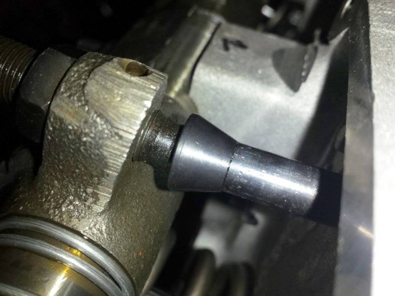

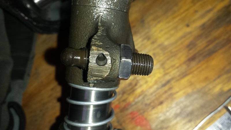

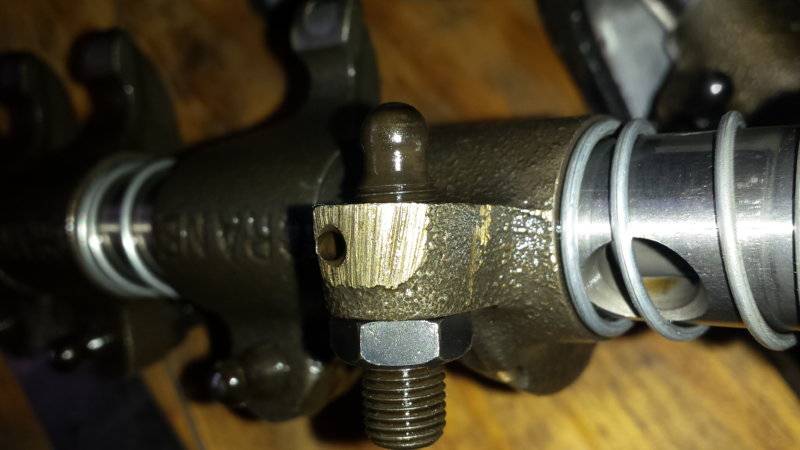

Here are a couple of pictures of my adjuster, hex head with lock nut. Distance below the rocker is .442" to ball tip and I set these up with 2-3 threads showing as I was advised...
HUG 1322
View attachment 611866 View attachment 611867
too much thread showing. push rods are too short. those are the long adjusters. that's close to 4-5 threads showing using the slotted head adjusters that those rockers used to come with. when I went to edelbrock heads I couldn't find a shelf push rod to fit. IIRC I had to order push rods that were .170" longer (that's close to 4-5 threads showing) than the shelf crane push rods I was using for the same cam. the 440 source are edelbrock clones so you may have a similar situation. another factor is if those are 1.5 rockers they'll check out around 1.6. if this is the case I would check everything again. ole' joe Sherman used to say you need to up the spring pressure 6% for every step up in ratio; might check with hugh's on that.
just looking at an older direct connection engine manual and it says 1 thread showing is ideal (keep in mind this is the short slotted head adjuster), 2 may be o.k., 3 shaky. keep in mind the new long type adjuster extends the ball .100" which is close to 2 1/2 threads showing. surprised you haven't snapped the ball end off.
Thanks for the informed answer. This is how i originally had them set up to order custom pushrods until I was told by two members to add a few threads...:(

all the "thread showing" stuff is obsolete and probably has been for 20yrs. what I think might be ideal is the adjuster for a ball&ball push rod. as long as the oil groove in the adjuster is lined up with the oil feed hole a guy should be goldened. pair that up with some 270 degree radius ball push rods and forget about the threads showing crap.
There is no oil groove in the adjuster. The oil feed hole goes from the i.d., through a portion of threads, and out the adjuster side rocker arm body. The adjuster is all threaded.
the ball&ball adjuster has the groove. the cup and ball adjuster doesn't. I was referring to using the type of adjuster that the comp cams magnum rocker has and getting away from all the thread showing crap.

New locks and retainers vs. Old locks and retainers...
