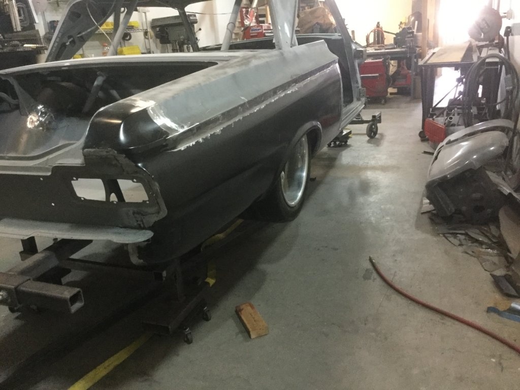

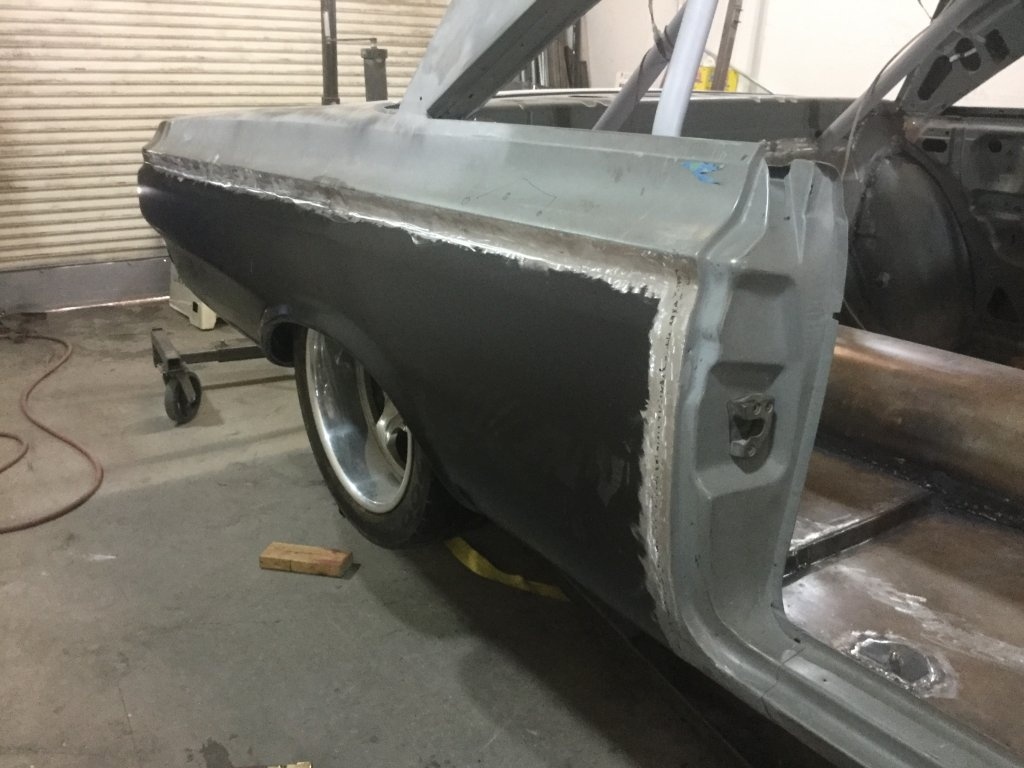

Had to take some time off for a tradeshow but over the weekend I got some time to work on the Fury and the quarter panel is now 100% installed with all the welds cleaned and ready for body-work; I am REALLY pleased with the results!
Here's a shot showing the seam after cleanup:

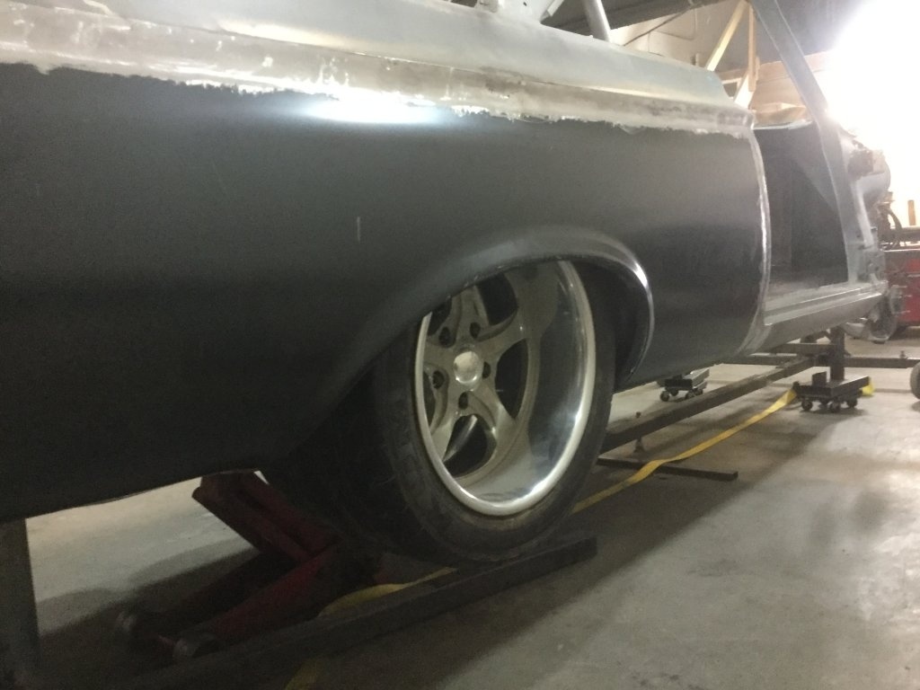

Once I got the quarter work sewn up I figured it was time to re-install the rear suspension and make sure everything fit, so the next series of pictures show the suspension at full compression with the tires and rims mounted. HUGE thanks to Larry (Khan-vertible); if he hadn't mentioned "de-humping" the new wheel well I would have been in huge trouble because there is NO WAY my 335 would have fit without the "de-humping". As it is it's a tight fit but if I compress the suspension this far I'm probably in trouble anyway!

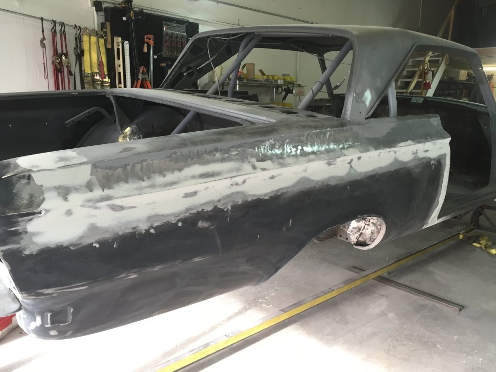

I mixed up some Evercoat filler (love their stuff and HIGHLY recommend it), layed it on, let it dry, and began shaping...and it happened: I didn't rough up the surface enough and the filler pulled away. Oh well, better now than later so I ground it all off, roughed up the surface with 36 grit, and re-layed the filler. Below is a pic after using a cheese grater and 36 grit
Next step will be applying more filler, smoothing it out, shoot 3 coats of Matrix 2K High Build, then block it to a seamless finish.

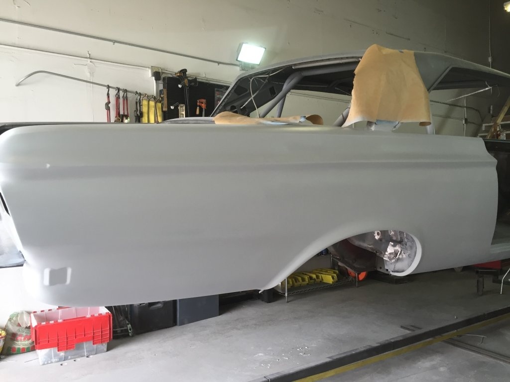

Over the weekend I spent a good amount of time filling and smoothing the seam between the new quarter and the existing body, and I'm really happy all the way around. I then shot the bare metal with some self-etching primer and decided to give it a few days to completely cure. Here's a shot of the quarter in the base primer:

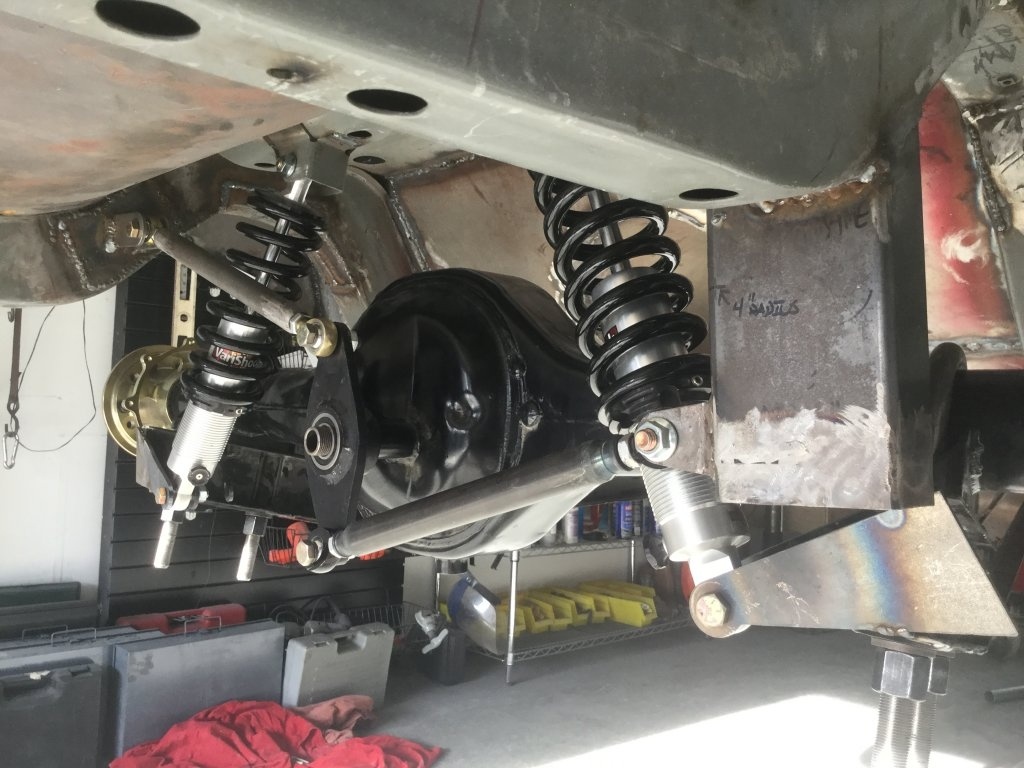

Waiting for the primer to settle in gave me time to make some adjustments to the rear suspension; during the install a couple weeks ago I found the coil-overs were going to come into contact with the differential, so I ordered up some new shock mounting tabs from Welder Series (great stuff and terrific people) and set to work moving the shock mounts back about an inch. Below are some shots of the rear suspension, completely installed and centered in the chassis. Now that I know it all fits correctly I'll be pulling it out and finish welding the new shock mounts.
I love this shot since it shows the entire suspension system in place, including the coil-overs, and how it all fits. I'm actually pretty proud of all this since I did it all myself.
I wanted to get a closeup view of the Watts Link. Yea, I know there's no nut on the Watts "Butterfly"; I have one but I must have mucked up the threads because it didn't want to spin on.
This shot shows how close all the pieces fit together; there's not a lot of room between components, but they all function cleanly with no interference.
WoooooHooooo, gotta love those big floater hubs! Yea, they're a pain in the *** when it comes to a parking brake so I'll end up using a pinion mounted one but for strength and ease of working on they just can't be beat.
