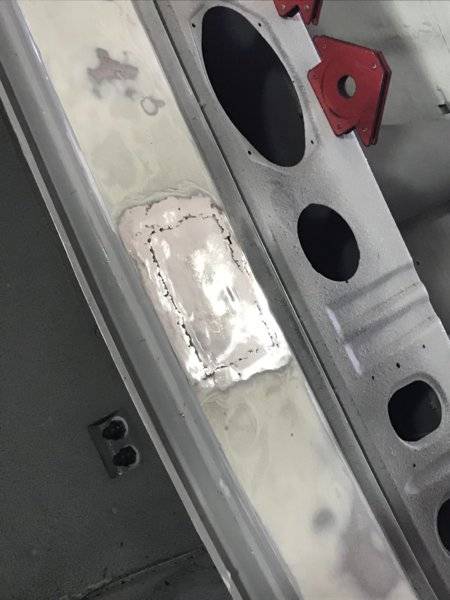

First thing I did was cut out a really bad spot in the Dutchman and fill it in. The spot was badly "oil-canned" and just wouldn't come back into shape so rather than fill it with body filler I cut it out and blended it in.

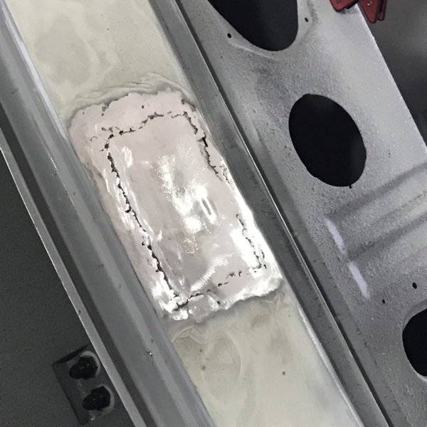

Here's the same area after I redid the body filler.

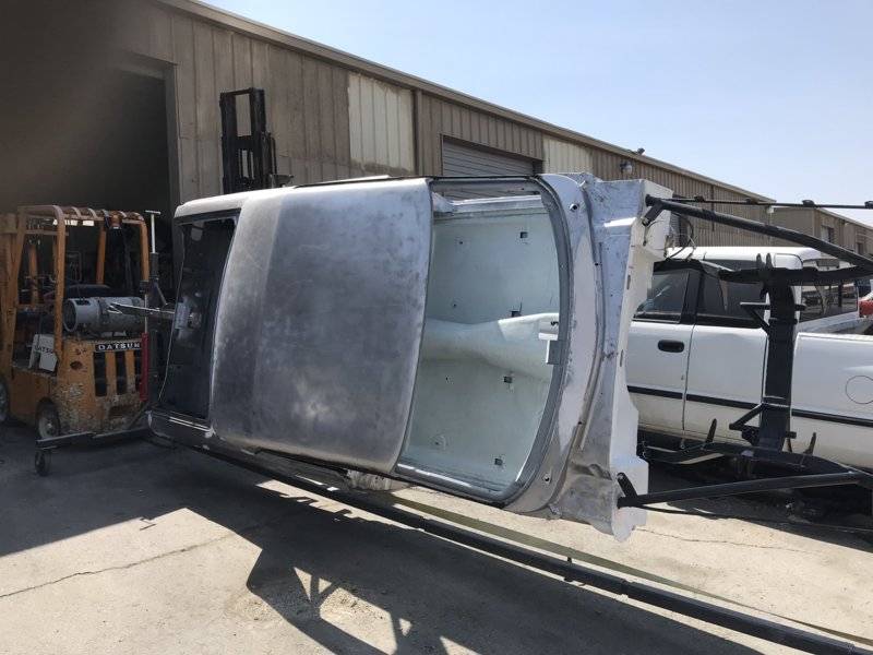

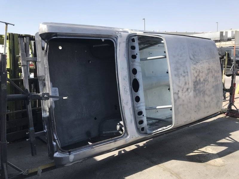

Virtually the entire body has now been stripped, including the roof, which luckily didn't have any surprises or problems. The roof and the C pillars are virtually the only part of the original body left intact, the rest has been replaced.

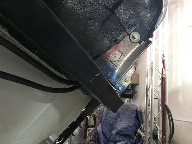

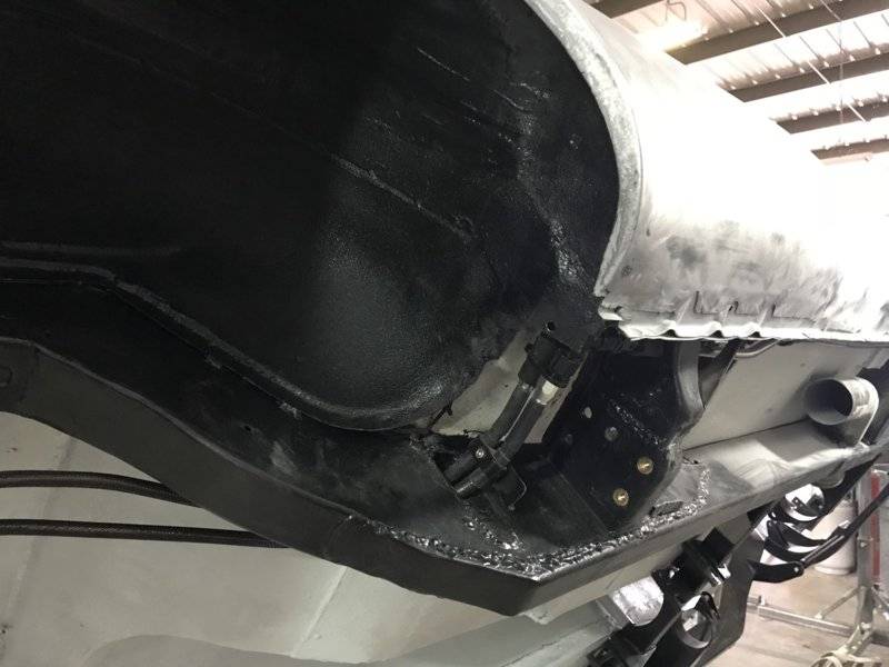

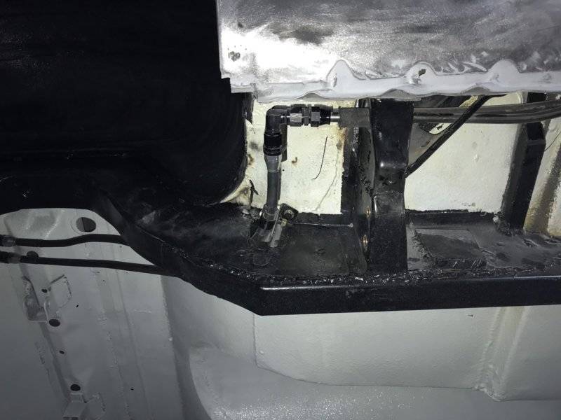

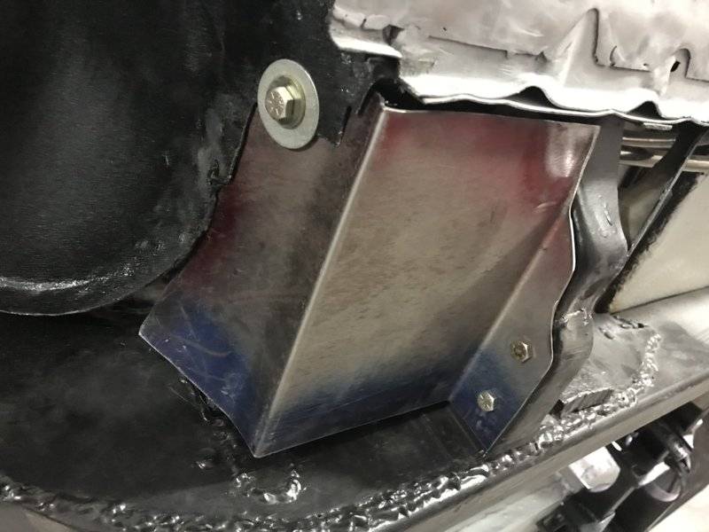

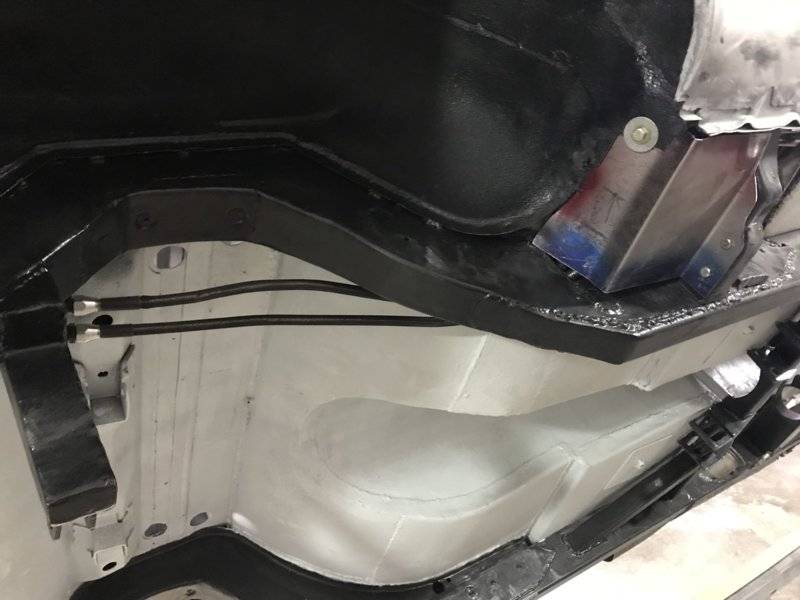

While stripping the car and re-doing some of the body work I've come across areas that need attention, including a section of fuel line (1/2" steel) that passes directly in front of the passenger rear wheel. I have no issues with the placement I chose for the lines except IF I have a blowout and the carcass begins flapping around; there could be serious fuel line damage. Yea, it's a real small probability but one I have considered, so I decided to take the time and make a cover for the area to safeguard the lines.
Here are the lines as installed:
Here are some shots of the 16 gauge steel cover I fabbed up:

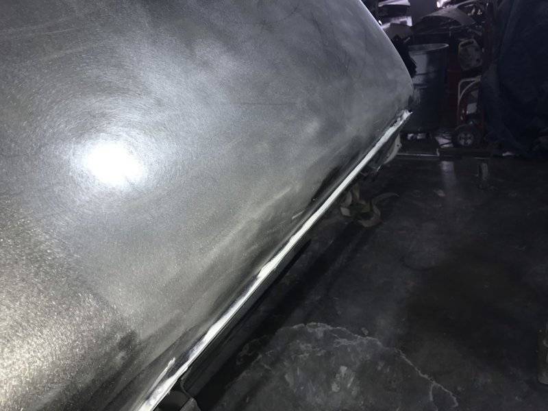

I've got the car all stripped and I know I need to add new seam sealer around the roof area and A-pillars so I get the bright idea to lay down the goopy stuff right onto the bare metal. Only after I get it all finished does it dawn on me I should really consider whether the epoxy primer will stick to it, so I check the web and sure enough, EVERYBODY I can find recommends NOT putting epoxy over the seam sealer, lay the epoxy down and put the seam sealer on top of it, so I take the next hour or so and remove the new seam sealer with a torch, various picks, and wire wheels. Damn shame too, it really did come out nice (have a look):

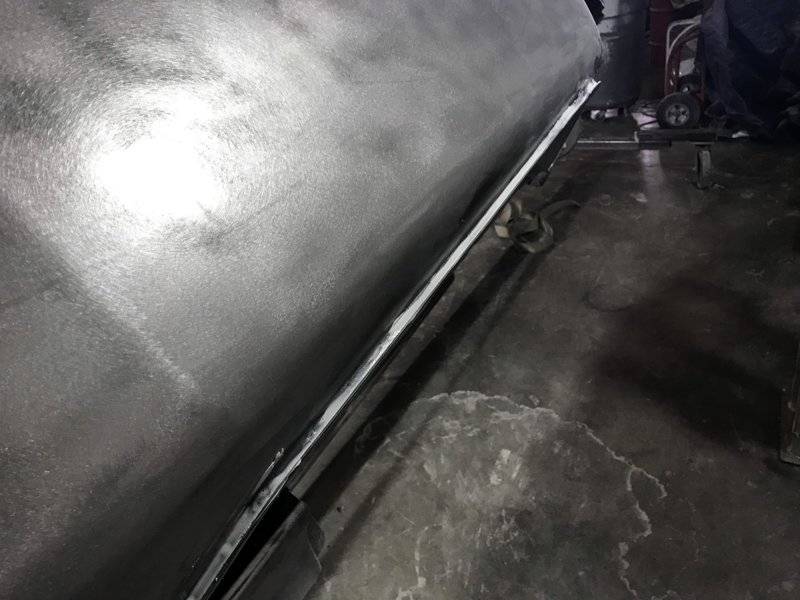

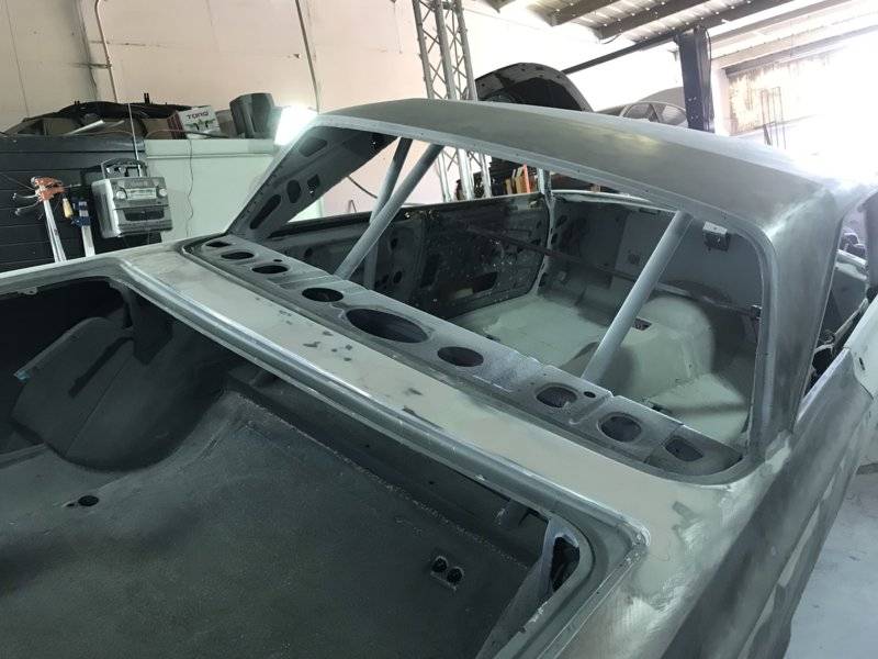

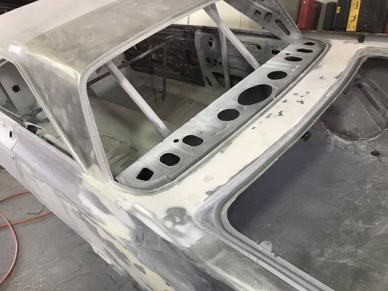

Finally healthy and got some time to work on the Fury; completed the body work for the chassis and took it outside to blow it all off in preparation for sealing and priming. I've got some final touches of smoothing on the fenders and doors but that won't take long.

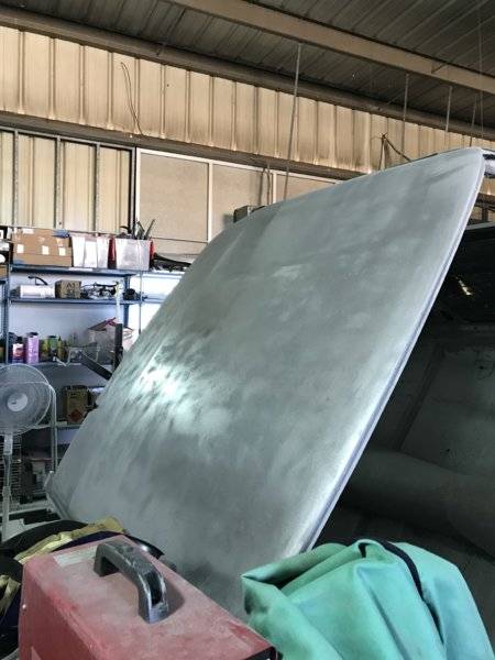

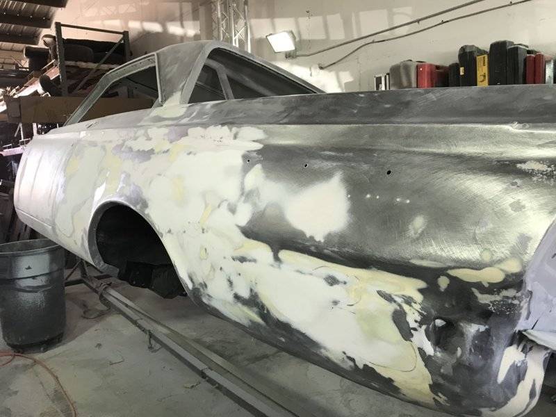

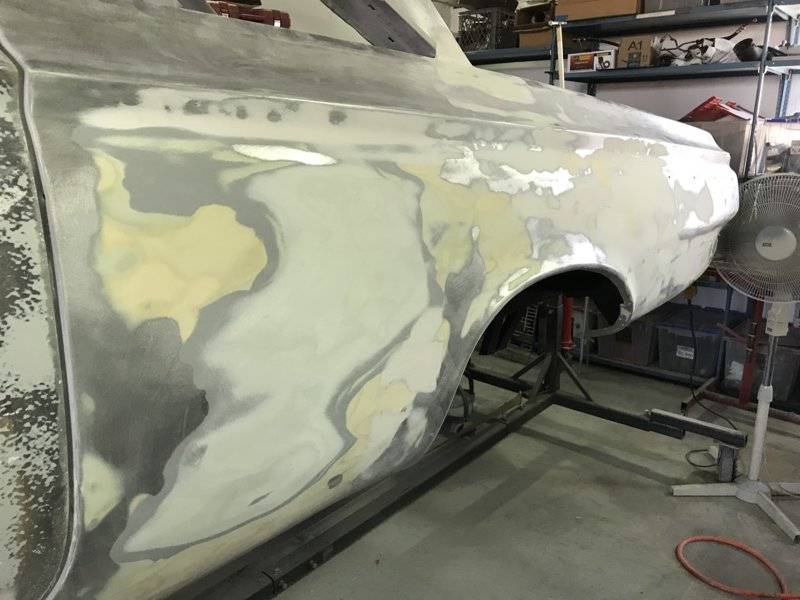

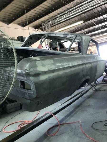

Well, I finally ran into something I could not seem to overcome on my own and had to farm out; the body work. I tried for months but to be honest, all I was doing was wasting time/money and making a huge f'n mess with no real solid results to show for it, so I found a young guy in a nearby shop that will do the work and be finished in about a week or so. Here's a shot of the passenger quarter, with more to follow:
It really breaks my heart I had to farm out some of the work but the bottom line is I just don't have the finesse needed to do the kind of quality work I want. Oh well, I'll move on and get to the assembly stage.

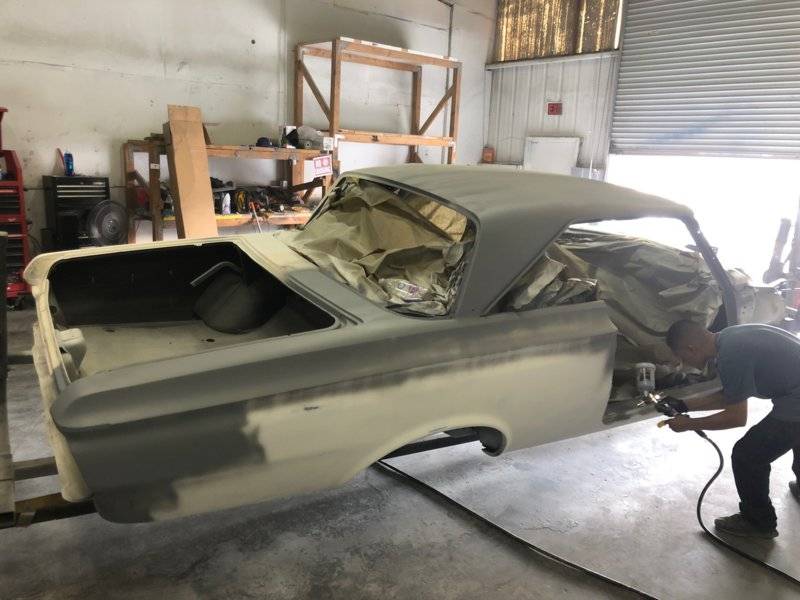

Picked up the paint today ($700+!!!), decided to go with Lancia “Rossa Corsa”, which is a crazy bright red.
The bodywork is just about done and the car should be painted within the next couple weeks.
