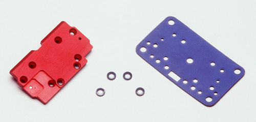

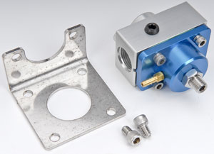

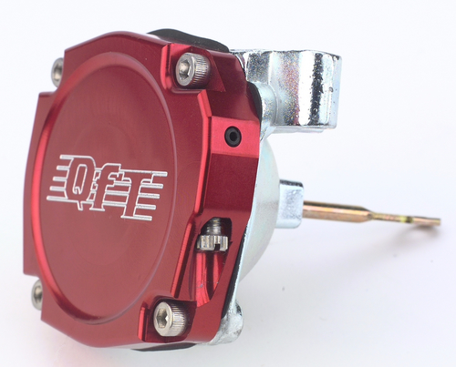

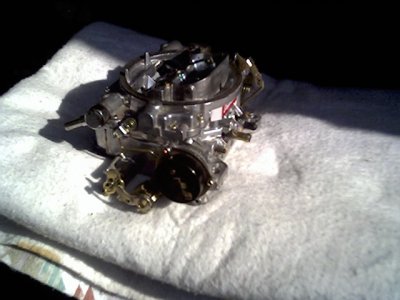

Mr. Speedfreak, your Chargers come a long way, looks like good progress too, as far as the carbs go, I've said it before, I prefer Holley's style of carbs or better yet a Quickfuel carbs myself {or ProMax plates too}, I'm not a big fan of Edelbrocks, as many here will attest, they have their place, but the original Carters are way better, Thermoquads aren't too bad either... those you have seems a little to small CFM... On the Holley you could get a different base plate or main body from Quickfuel or Proform gain another useable 100+ cfm of flow easily on the Holley, if need be... I also have a remanufactured/repaired base plate, I got it with my last 68 RR an Edlebrock/Weber AFB Style Carb #1411 750cfm Performer, w-electric choke, Ill never ever use, I'll let go dirt cheap, like a $50 bill & shipping costs, if your interested, PM me contact information, I'll give you details... good luck

Speedy, If you don't want the "remanufactured/repaired base plate", I would surely like to have it
I have a holly double pumper (650 cfm)for the 440 and just bought a "trickit" for it, but this seems better.

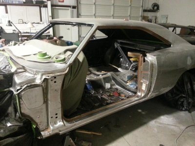

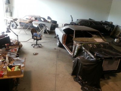

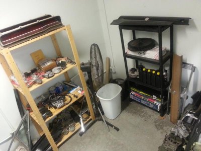

Lol sorry guys, just been busy kicking some more @ss haha. Finally got a solid weekend of work in at the shop, starting with a massive spring cleaning. Took a load of trash out, hunted around finding all the tools that seem to hide themselves all over hell's half acre, and reorganized my parts room. Maybe I'll actually know where stuff is now haha
Then MCA Mike came by and helped dismantle the passenger side door and take both doors off the car

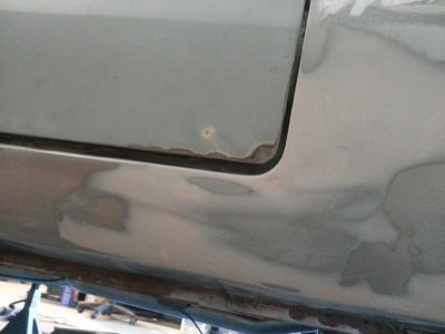

Driver's side doorjamb corner before I took the door off :icon_thumleft:

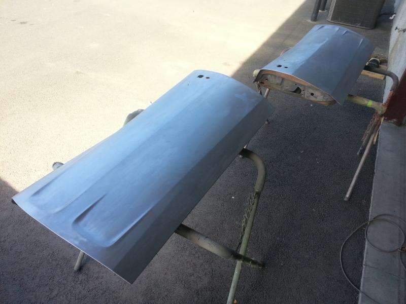

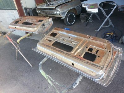

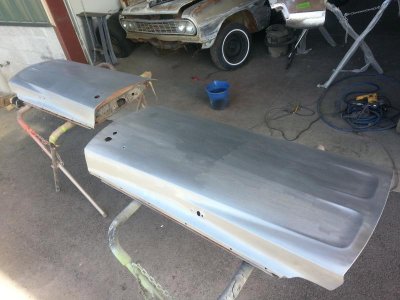

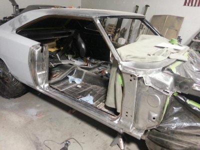

So since the weather's been awesome this week I took a half day off work today and called in some reinforcements. Me and a friend of mine continued the mad thrash and completely stripped the 5-ish layers of primers/paint/filler off both doors
Spot stripped the other sides as needed
And stripped some serious acreage off the doorjambs, door posts, and cowl. Really cool of him to come help out

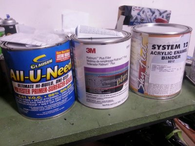

Gonna hit the areas that were prone to surface rust with Chassis Saver, lay all the seam sealer, and shoot some All-U-Need. That will then get wet-sanded and topcoated with single stage jet black (just where I'm jambing, the main exterior body will be base/clear when the time comes).

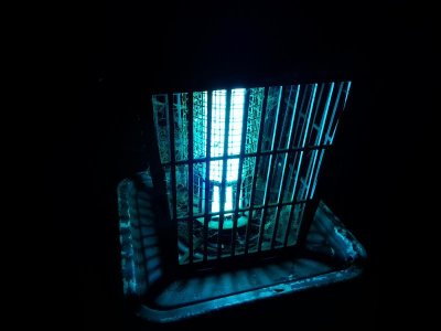

And for whatever reason tonight was the night every mosquito in a 50 mile radius coordinated an invasion of my shop, so I broke out one of the oldest forms of entertainment and kicked back to the soothing sounds of my high voltage counterstrike

To keep the bugs away, try running LED lamps instead of fluorescent or incandescent. Bugs and Mozzies are not excited by LED's.
