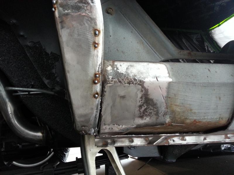

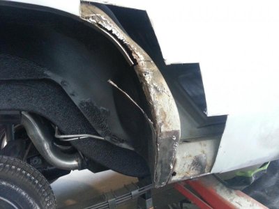

Hey guys thanks for all the kind words and sorry I've been MIA again, summer has already kicked in with work and family stuff eating up all my time like a black hole, but I've still been pushing ahead with frankenstein. Got the doorjambs done in single stage which was a massive headache and will be re-done with base/clear when the time comes, and I'm knee-deep in metalwork on that passenger side where the bird crap patches were. I've got all that removed and the wheelhouse all patched up after discovering it also needed some tlc.
Unfortunately I'm now at the point of patching the quarter and decided thanks to their backyard patch attempt I'm now in need of at least a lower rear quarter like I did on the driver's side. And after taking a closer look at the dutchman panel that got all warped and beat up from my family friend sitting on it while welding up the rear window shelf, I'll really need to put in a new one of those, too.
So that will be about another $400 in sheet metal I'm not sure I can buy just yet, and kissing goodbye most of the summer as far as hoping to get some driving time in... just feeling pretty beat down by the bad news on everything right now, but I'll get a proper post up with pictures of everything I've been up to later.

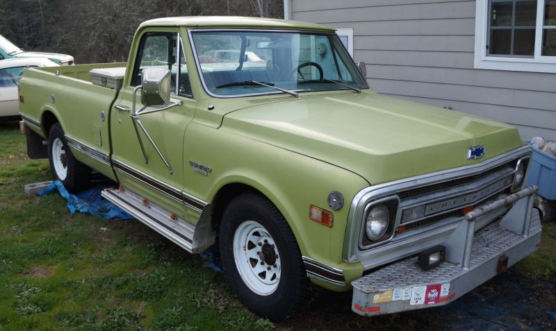

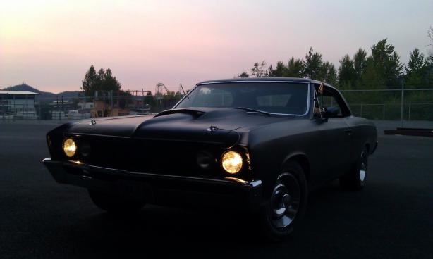

Sorry fellas, SF checking in and long overdue! Things have been crazy busy since finding out I was short on funds and sheet metal, but I talked to my dad a little about it and basically came to the conclusion that it's time to sell my chevy stepside I've been cruising around in, and use the denero's to get Frankenstein and Ol' Blackie ('67 Chevelle) back on the road with the Chevelle hopefully handling winter daily driver duty as I finish bodywork on the Charger. For anyone just stepping aboard the Speedfreak train, here's the Chevelle pre-accident

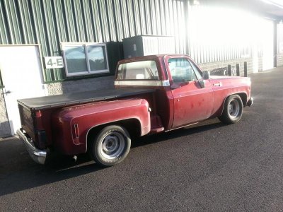

Here's the part where it makes sense why I've been so busy lol. The stepside had been righteously lowered stock coil springs cut almost in half and almost non-existant rear leaf packs, and had an interior that any 70's male pornstar would be proud of.
:pimp3:

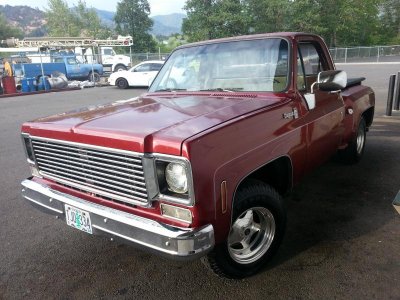

After the dotted line was signed I made it as far as the gas station before ripping most of the interior out, but I suffered with the suspension through an uneven-treadwear-blowout or two. But with this new battleplan in mind I grabbed a full set of springs and shocks from a local pick-n-pull for $100, and got the Tijuana Special back to a repectable state. Now I'm just finishing up my interior overhaul and it should be up on Craigslist this weekend.

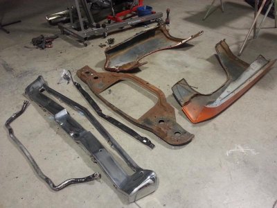

The new plan also called for some new sheetmetal for the Chevelle front end, and last weekend I convinced my girlfriend to let me take the long way home (another 2 hours north and 4 back home lol) from our 2 year anniversary coast trip so I could grab some parts from a guy in Portland. Ended up with a nearly complete set of front end sheet metal for $310

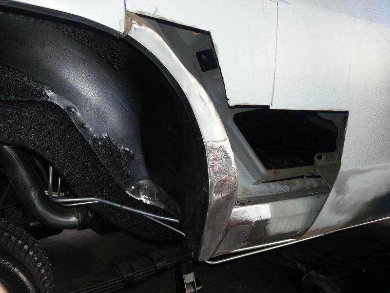

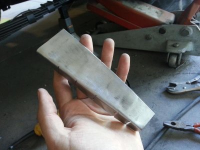

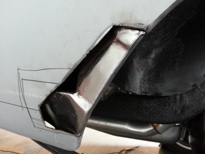

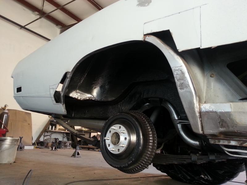

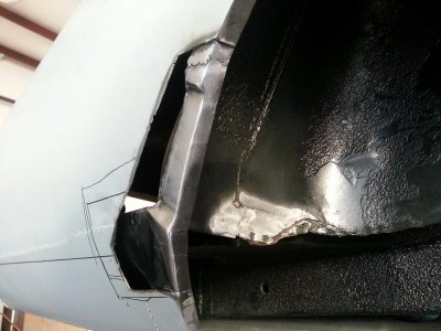

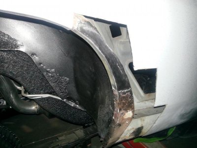

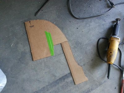

So anyway with all that out of the way, don't think Frankenstein got forgotten. Here's that passenger side wheelhouse I mentioned needing some love

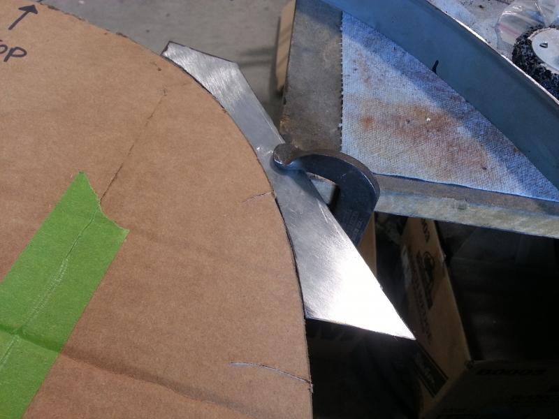

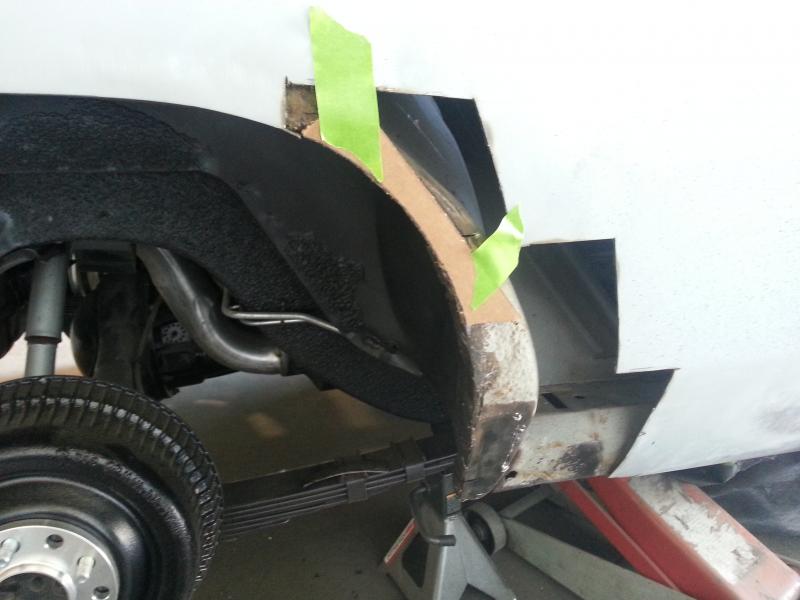

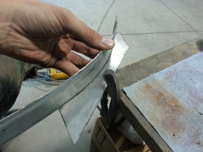

That upper right corner was "repaired" so bad I was left without any original opening to work with, so I made a cardboard template of the driver's side opening to go off of when making my patches.
Coming together
And another 2 piece patch on the left side
Now with everything zapped in, grinding done, and all cleaned up ready for a coat of chassis saver.
In the one pic you can see the sharpie line down the lower rear quarter, this is where the body line should be based on measurements from the driver's side, the previous owner's hackjob wasn't even close lol. So between all the Chevelle stuff I'll be plugging along doing the lower front patch while I save some money for a lower rear patch and dutchman panel.
