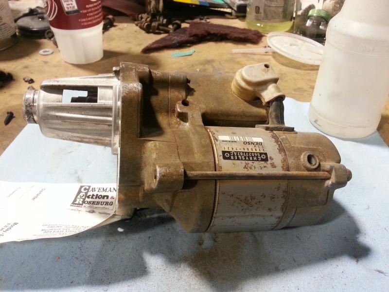

The $65 junkyard mini-starter has landed! Not the most gorgeous starter out there but it cleaned up pretty nice and seemed like it'll fit just fine when I mocked it up to my spare trans.
So now I get to try and pull my Hedmans out in one piece and Mike should be by on Sunday to help get the Doug's installed if all goes according to plan. Should be a fun weekend
Looks just like my Summit mini starter, what is it off of?
Man I didn't even think to check Summit, how much was their starter? And mine was supposed to be off of a mid-late 90's 318 or 360 durango but I guess because of interchange the tag on mine was marked '00 Ram, everything fit right on my spare trans so hopefully it all works out haha
Good to know, I can't remember how much it was but it was out of the scratch and dent sale haha what can I say "I'm cheap". I'm pretty sure it was a Summit brand though and looked just like that.

Just a quick note about the starters...pretty much all small block starters are the same. The 3.9, 318, and 360 starters are all mini starters and will all bolt in the same place. I put a 3.9 v6 1997 starter up to my 5.7 hemi and it fit and started the engine fine...traded that to Kahn. I already had a new starter from a 04 Ram application. So just about every junkyard starter from 1993-2003 should work. Some differences in locations of the solenoid and electrical connections. Also one bolt difference between the 97 and 04...i think the top bolt on one was a through bolt with a nut while the other was threaded...both bolted up just fine.

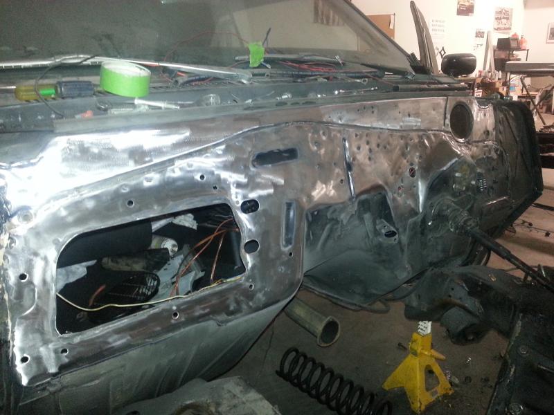

Been keeping busy on the Chevelle front, too, starting with the trademark butt-ugly chebby firewall haha. Removed all components and wiring, and scraped the gooped-on sealer out of the seam that runs straight through the middle of the firewall. Even though this is a full-frame car and this spot probably sees little to no flex, I decided to reinforce it with sections of about 4 inches of weld spaced every 6 or so inches where I plan on skimming with filler (All-metal will go in the slightly deeper parts of the seam first). Also welded up all the random unnecessary holes
And ground the welds down

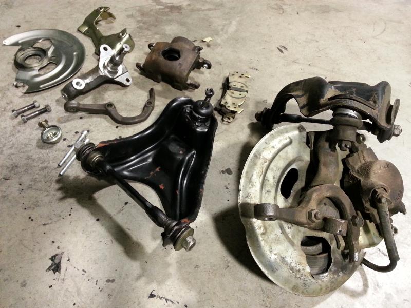

Also took the time to disassemble my uca's/spindles/brakes and give everything a good dose of brake cleaner ahead of some paint. Going to shoot the control arms with jet black chassis saver, spindles probably cast iron like I did with the Charger, and I'm thinking red calipers (rest of the car will be flat black with black Bassett nascar wheels, it's got 4-wheel-disc so I thought some red calipers peeking through might fit pretty well :shruggy: )

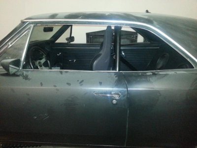

And maybe you guys remember the rollbar I bought a while back that had been pulled from a '69 Roadrunner? Well I decided against using it on the Charger because I wanted to have a little closer fit to the body, so it's been gathering dust against the wall for a couple months. The lightbulb went off and I tried out a test fit on the Chevelle. The bar fits perfect with a 3" gap to the door panel on either side that I could live with (since I don't have a back seat anyway), and the sides of the bar somehow ended up perfectly positioned over each frame rail lol. Looks like the body swap will be a little more fun than expected!

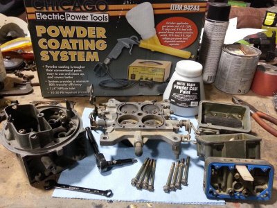

And last but not least, here's a little project you guys might like a little more than the chevy talk haha- DIY powdercoating. I got thinking about what I wanted to do about the finish on my ancient $40 double pumper, since I have a rebuild kit and new Quick Fuel metering blocks on the way that might look a little out of place between all the "patina." I was pretty well decided on black (no surprise there) but the powdercoaters I use don't do carbs, supposedly due to the time it takes taping them off. Enter the $65 Harbor Freight powdercoating kit lol

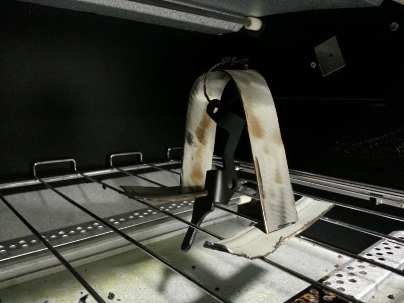

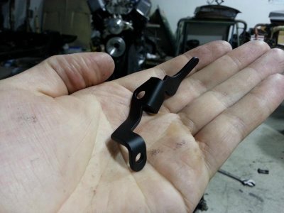

I had a little black and decker toaster oven onhand I figured would be big enough for a carb body, and can heat up to 450 degrees, so "what the hell" right? As a test piece I started with an accelerator pump bracket; gave it a quick sandblasting, 10 minute 400 degree pre-bake (even though there probably wasn't much porosity in this piece), a wipedown with denatured alcohol, and it was ready for powder. Rigged up a little A-frame to hang the bracket from in the oven, clipped the hot lead to the copper wire it was hanging from, and dusted it with a powder until it was covered and opaque-looking. Into the oven at 450 degrees until it glossed/glazed over, then down to 400 degrees for another 15 minutes, and this is the finished product. I'm no Cudachick, but not bad for a $65 kit, not even a dent on my $4 can of powder, and a household toaster oven you can find on craigslist for $20 all day long haha
So now I'll be doing the float bowls, main body, and throttle plate once my hight temp silicone plugs and tape get here. Pretty fun project so far!

Hey Speedy . . . that looks great ! ! ! Nice progress on the cars too . . . nice to get an objective review on any H-F tools . . . and the outcome looks pretty darn good too ! ! !
Thanks Kahn! And yeah I usually have low expectations from some HF products but in this case I was pretty excited to be proven wrong haha the finish is awesome and I've dropped it a couple times/ tried to scratch it and it never chipped. Makes me want a full size kitchen oven to coat some bigger parts haha
