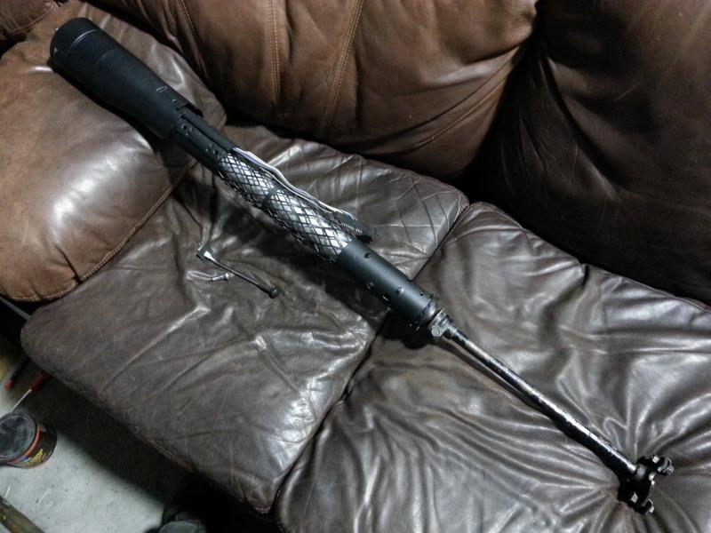

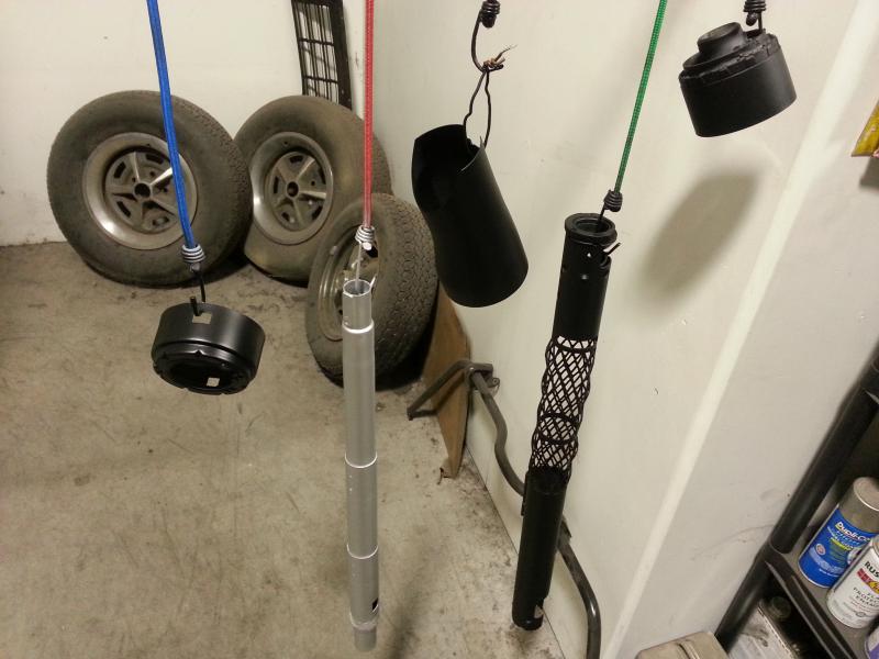

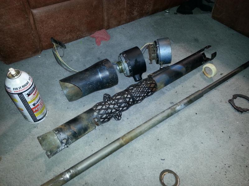

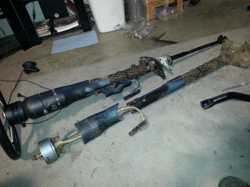

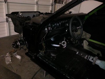

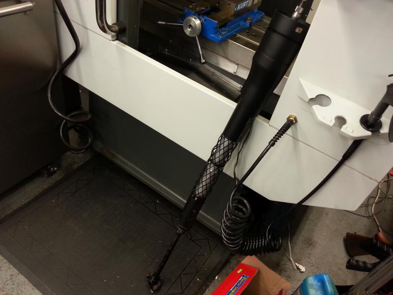

Well nothing too crazy to show for it but I had a pretty busy weekend, this time taking on blackcoat's wasted steering collumn (safety cage got compressed in the accident). Called up a cool old hippy friend of mine who happened to have a 4-speed collumn laying around (no collumn shift hardware like my old one), but as always there was a catch. The story goes, someone stole the steering wheel out of the original car, and the owner used a trusty pair of vicegrips to steer the car around the yard, resulting in the splines being completely fubar. So in keeping with my mad scientist deal, I figured I could frankenstein one good collumn out of the two..

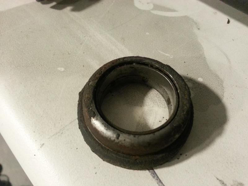

I'll spare you guys the hours of little step-by-steps dissecting a chebby collumn, but one of the highlights was this lower bearing which is apparently discontinued. One of mine was toasted and the other was full of crud and grit, but the only place I saw them for sale on fleabay was for $85.. so I cleaned the one out as best I could, re-greased, and said to hell with dropping $85 on a single bearing lol.

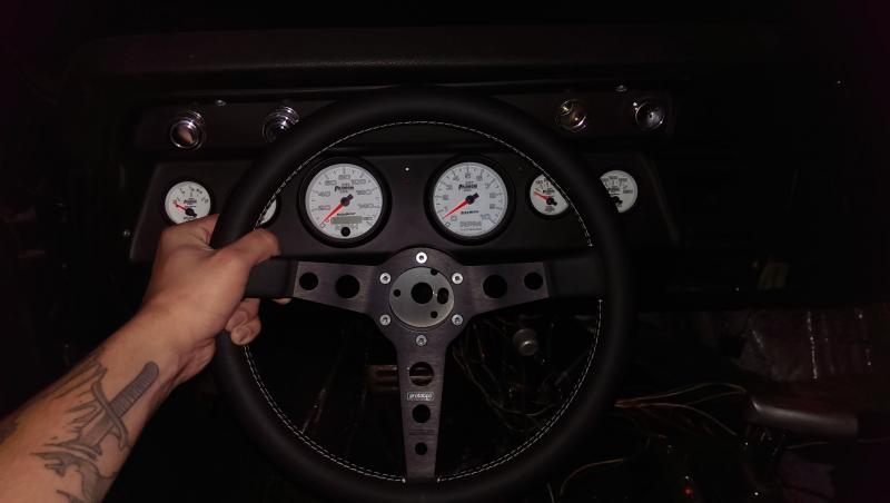

With all the major parts painted and reassembled, everything seems to be kosher and work as it should! Looks a lot cleaner without the big collumn shift nub and I'll be painting the lower end of the shaft

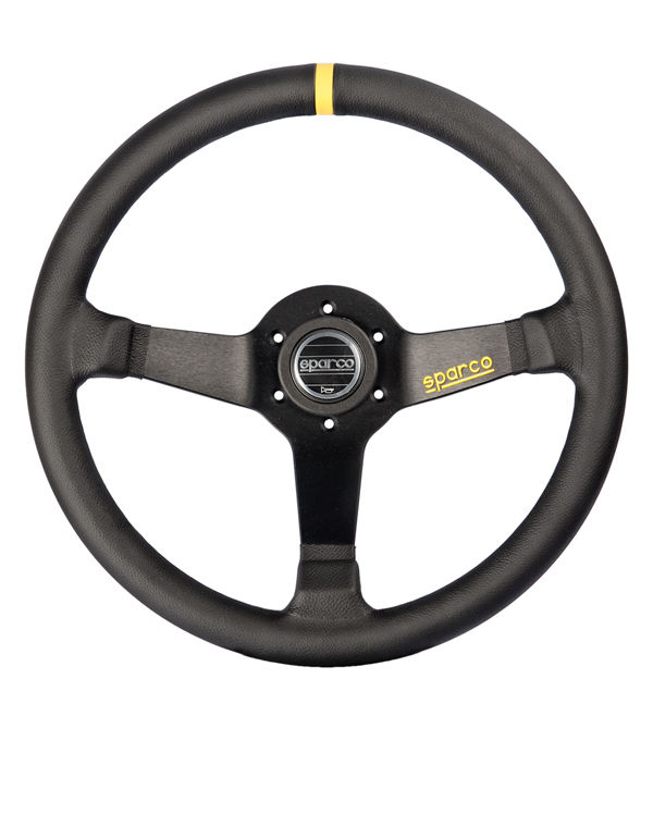

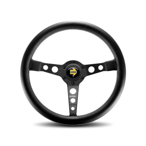

Now with that whole project done, I've started thinking about a new steering wheel to replace my Grant electrical tape special. Right now it's between the Sparco R345..
..and the Momo Prototipo Porsche 911-st replica, which I'm leaning more towards. I think the "speed holes" and all black would look a little more interceptor-ish haha. Both are leather and 350mm like the Sparco L777 I put in the Charger

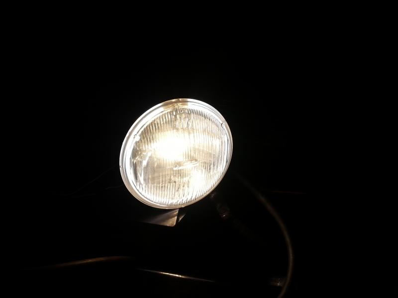

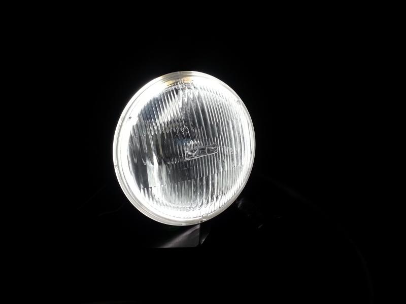

Also got my newfangled halo headlights, and as much as I usually dislike em, I think these ones are looking pretty bad@ss!
Halo only:
Halo and bulb:

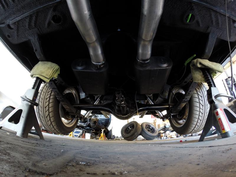

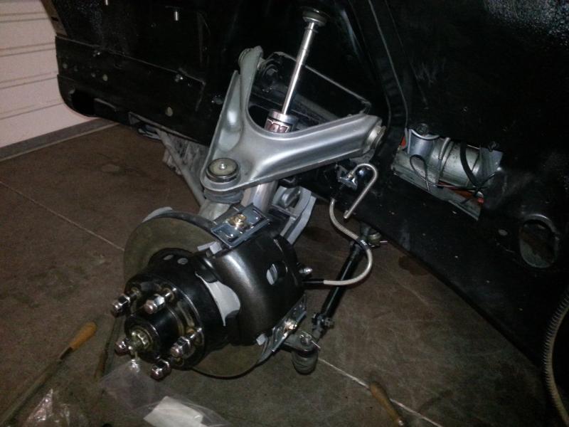

Any special reason the caliper is mounted upside down lol :toothy10:
Good eye BigBlock, its gonna be a bitch to bleed that way Speedy.
LOL that mod is worth -10 feet on the skidpad, haven't you guys heard?? Guess that's what happens when you bolt on parts at 1:00 in the morning after a long day :head_smack: haha good lookin out fellas :icon_thumleft:

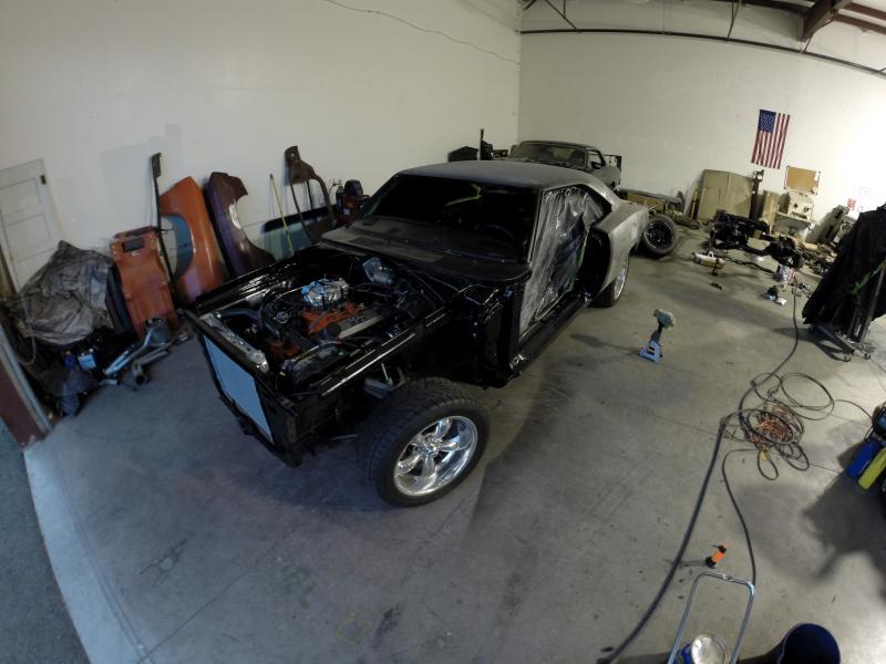

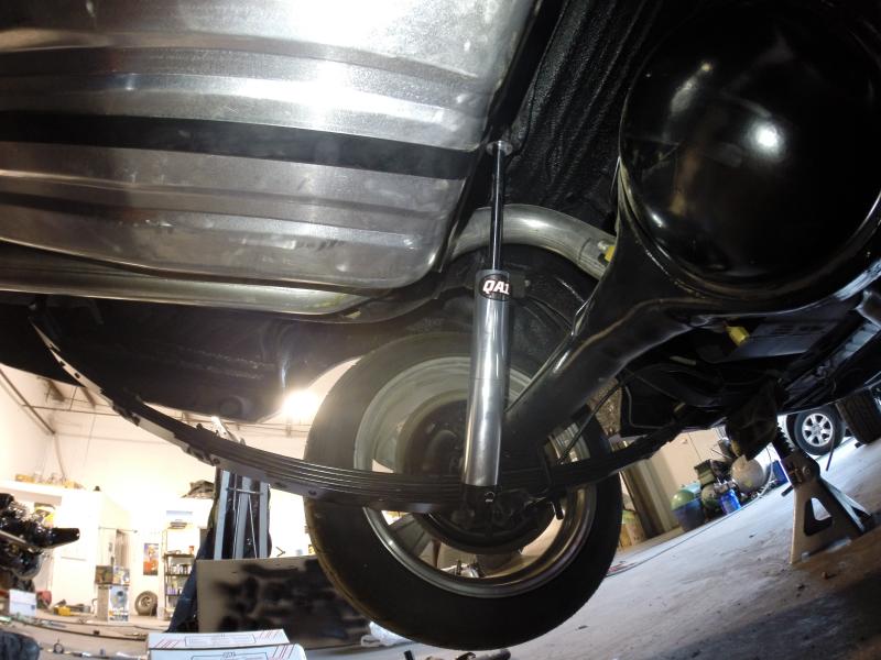

Got my Gopro last night and already loving it! Here's one of my first shots messing around with it, Frankenstein is now officially running QA1 Stocker Stars on all 4 corners

More fun with the gopro while I was under frankenstein locking down the new shocks. I do have a question on the rear brake hose if someone could help me out though. Nothing was hooked up when I got the car, and my friend Muscle Car Alley Mike gave me a stainless braid hose off of a '69 Roadrunner that was going back to rubber. While I was under there I looked at hooking it up but the hose end is female as well as the distribution block.. is there supposed to be some kind of male-to-male there or is the hose end supposed to be male?

original brake line is a rubber male end on diff side and female end on engine side goes into a y block that has a breather on top, I kept the original rubber one and original y block cause could not be frigged stuffing around with the stainless one wildwood sent me. with your high idle, check your timing too high or throttle linkage bind up or vacuum leak

We got the brake hose issue solved with some backtracing on the specific application for my front brake setup, and an order from Summit for all 3 new hoses including the correct rear one.
Bench bled the master cylinder, checked all my connections, and went to town bleeding the system. Just a note, I went with dot-4 fluid for its higher boiling point than dot-3, and better price/availability compared to dot-5. Should work just fine for me.

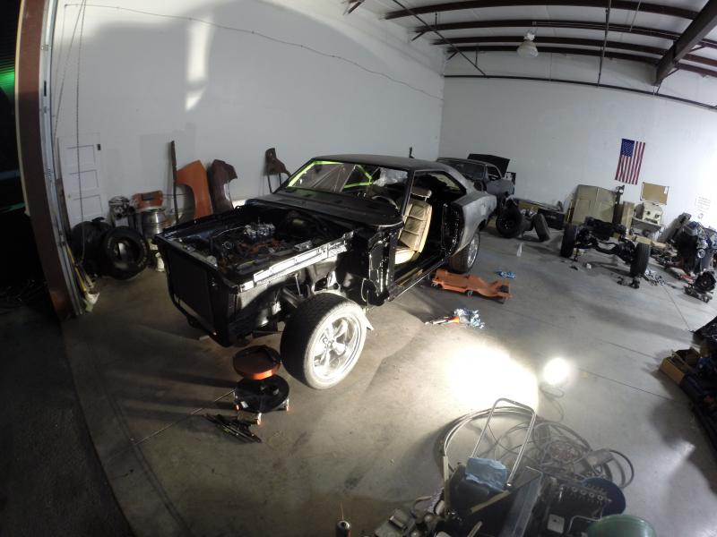

We got fluid at all 4 corners, the original driver's seat bolted in temporarily, the shifter adjusted, and the driveshaft in, but ended up being defeated by the ignition trouble and some semi-functioning brakes that must still have air somewhere in the lines. But all in all we had a good time and got a lot done on ol' Frankenstein. I'm playing this one a little close to the chest, but I've finally found some seats worthy of the Charger's cockpit, now there's just the challenge of finding a pair I can afford.. :thinker: haha still was an awesome feeling to finally sit in the driver's seat for the first time, looking out the windshield with the shifter in hand and engine running. The time is nigh, gentlemen!

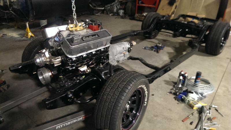

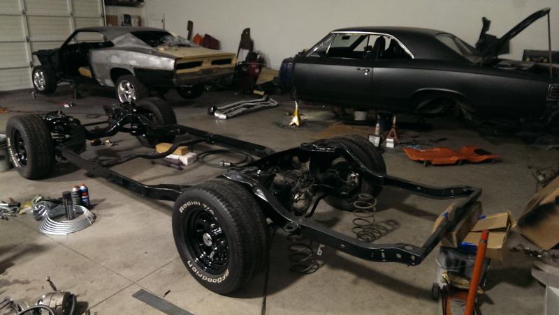

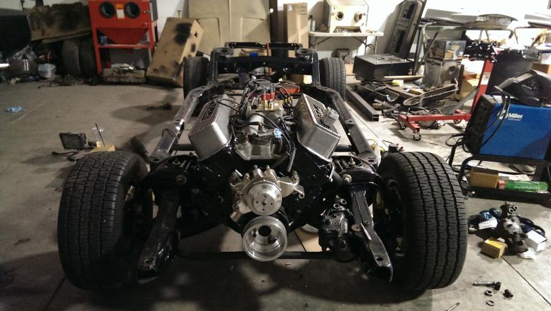

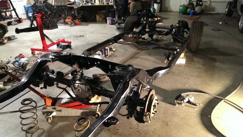

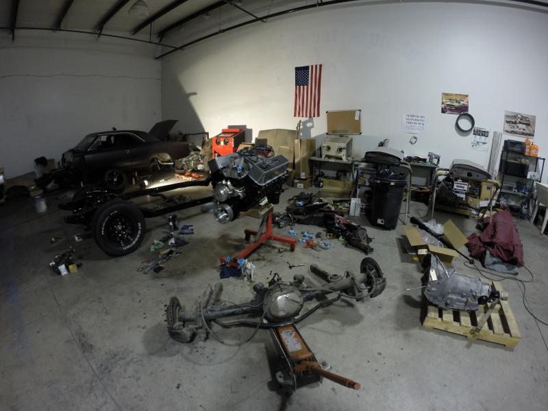

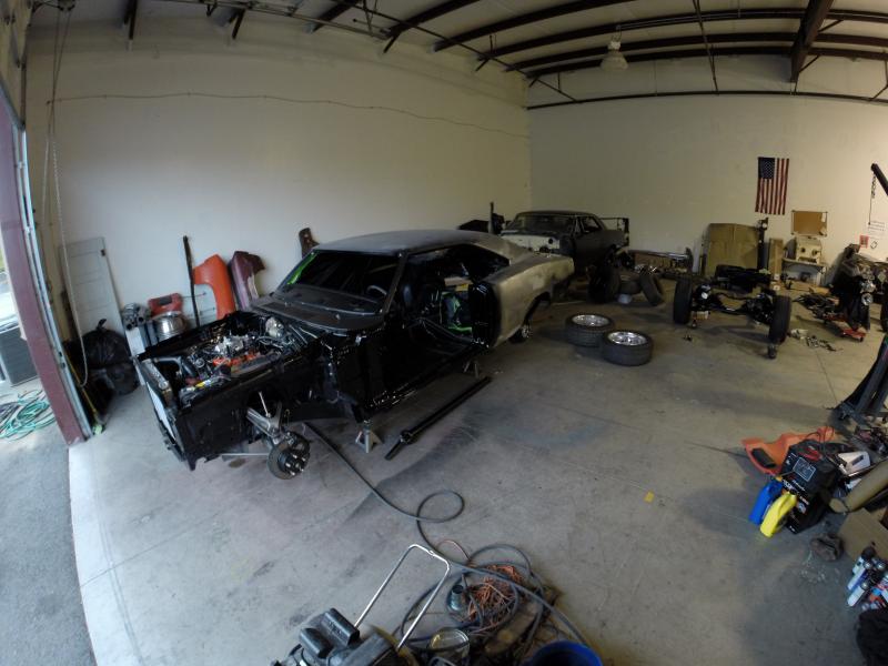

So that's about where the Charger's at for now, and I've been moving along with the Chebbie as well. Finally got the rear end and suspension out and swapped over to the new frame.
The eagle has landed!

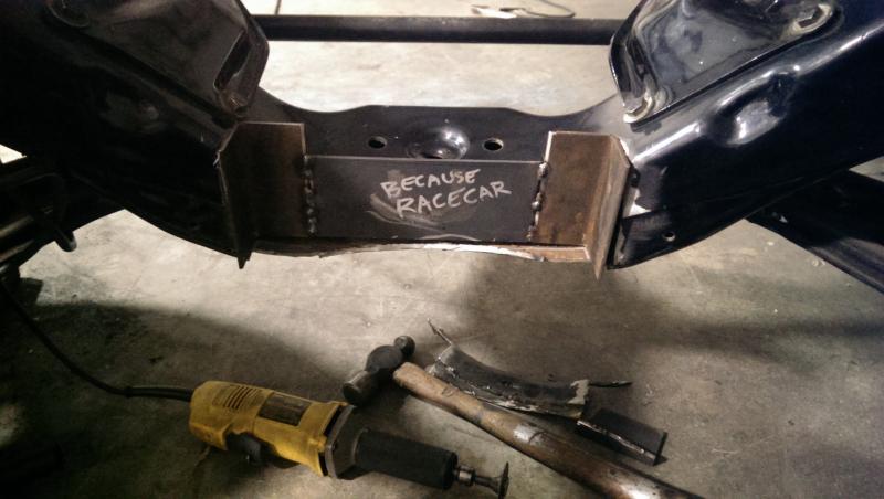

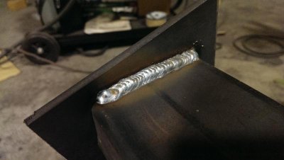

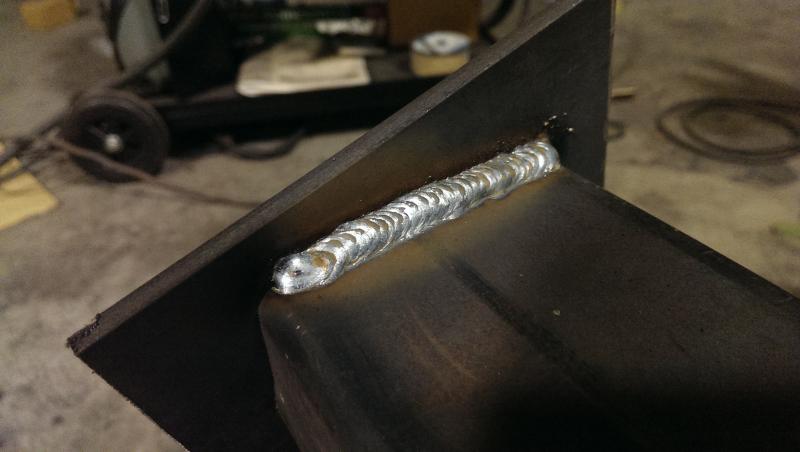

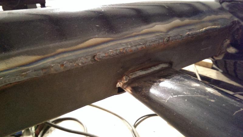

Of course the frame I bought is one year earlier than the '67, so the rear springs are different. And as I was getting ready to start boxing the frame, I go to test-fit the engine/trans and naturally the Summit "64-72 Chevelle" high-cap oil pan doesn't clear the engine crossmember :banghead:
"Missed it by that much"
So now I'm going with the "doesn't fit? Make it fit" strategy lol speedfreak engineering at work here, hopefully have the frame boxed this weekend

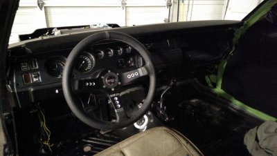

Speaking of steering, I ended up pulling the trigger on the Prototipo, worth every penny!

You still have problems with the brakes? You still have the calipers mounted upside down. The bleeder goes on top. LOL
<QUOTE> but ended up being defeated by the ignition trouble and some semi-functioning brakes that must still have air somewhere in the lines.</QUOTE>
Oh sh!t you're right! Hahaha how the hell did I miss that a second time?! I'm never gonna live this one down, I had Casey and another friend of mine there too and somehow it got past all 3 of us lol
