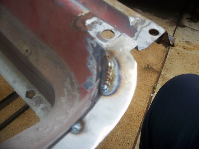

I'm getting really good with my small welds. When I welded the patch to the panel I put the spot welds one on top of the other till I had it welded in place. The welds were about 1/8th inch wide and basically no warping. I was really proud of what I did. I just forgot to take pictures.
:eek:ops:
I'll take some tomorrow when I do the other side.

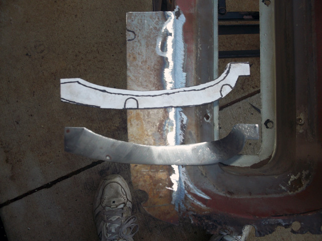

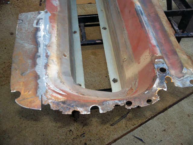

After watching all the youtube videos on how to make patch panels, here's the process I came up with. I traced out the pattern on construction paper, rough cut it out, and then trimmed the paper till it was perfect. Then I transferred the paper to metal and repeated the process of rough cut then grind to fit the pattern. After that I overlayed the new patch over the old and bent to fit. Once the new panel fit perfectly I rough cut out the old rusted metal and trimmed to fit the new piece. This is the spot where I had to stop for the day.
Tomorrow I'll weld everything in place and move on to the next rust spot. :)
I told you john,you can eat that panel up and spit it out,looks like a professional fab man,you can start your body shop with that kind of work,with you fixing that panel,you just saved your self some money,tell amd,goodmark,shermans to kiss your butt, you do not need to buy there tail panel. The one you got is 100% better.

Thanks for the words of inspiration johnny but I'm keeping with the motto "Two patches does not a panel make". Time will tell if I can eat this panel up, because truthfully every time I make a cut on this tail panel it scares the hell out of me. I think that's what's keeping me honest, my fear of screwing this thing up. I check, recheck, rerecheck and then check again. After that I make a move. I just want it to be right.

Patch looks great...You're really grabbing onto the hefty resto work quickly. Maybe found your long lost calling in life..lol Good Job!

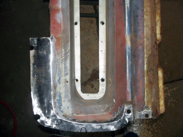

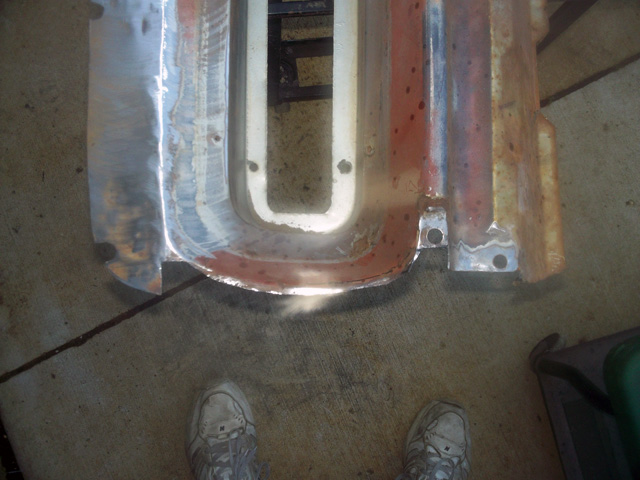

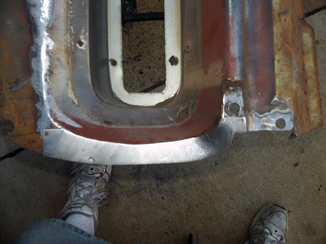

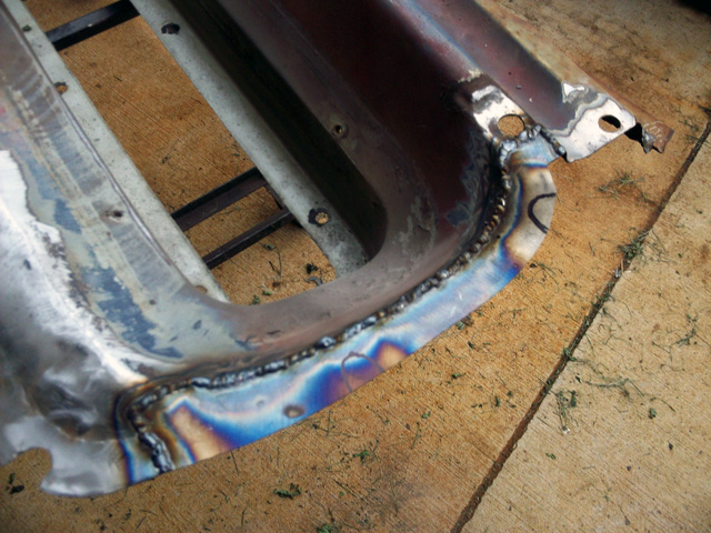

I'm starting to wonder if you may be right. moparjohnny said I would eat this panel up and spit it out. I replied on how much this scares the hell out of me. Today I finished welding in that patch and ground it down so it looks smooth and I think it came out pretty good. here are the pics of what I did before the rain started.
Now for some of the harder stuff. Wish me luck. :)
You got the patch to blend in real good. Can't even tell where you welded. I'm sure you'll do just as well on the harder stuff with no problem.
