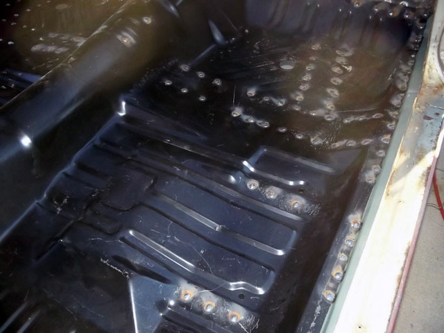

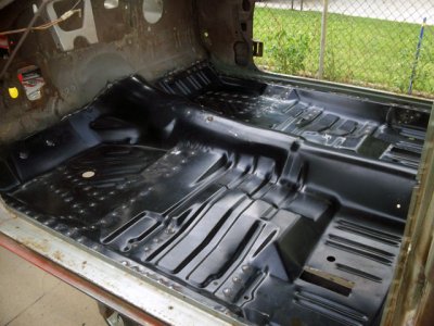

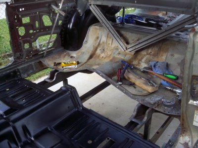

Today I started installing the floor. Here it is with all the holes drilled and fitted in place.
I started welding at the trans hump, then moved to the front where it meets the firewall and finished with the passenger side.
The welds aren't pretty but they are solid.
Even with screwing the floor to the frame I still had to hammer some of the holes flush with the frame, and I need to get a hole saw and cut out the hole for the seat belts.
Floor looks good sitting in there. I know when I got mine put in, I just stood there and couldn't believe how much of a difference that made things look.

Thanks Roger, I've been saying "what a difference" a lot lately. It seems like the Coronet is at a tipping point where it's going from parts car to something salvageable. It's a good feeling.

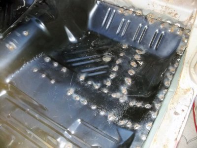

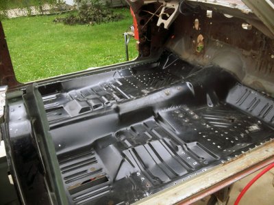

The floor is finally welded in place. It took a few days but I've been fighting a summer cold. I figure lots of nyquil, lots of beer, mix in some heavy machinery and it's all good, right? I still have all six fingers......oh wait! haha.
Now that the welding done the fun part can begin, grinding all those welds flush. After that lots of cleaning, blasting and then install the rear footwells.

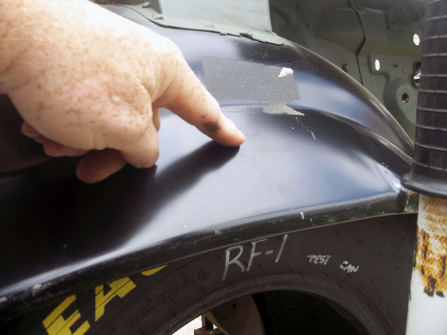

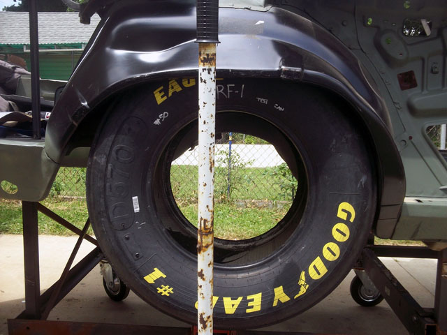

Ok I've been doing a lot of thinking about dehumping the wheel wells. I've read all the threads I could find about it and there doesn't seem to be a consensus for or against dehumping. Survey says! "do it if you want to." The tires I'm looking at are 315/35R17 Goodyears, They work out to be 26" tall and 12" wide. So I decided the best thing to do would be to mock up a tire and see what kind of clearance I have. So here's what I came up with.
Stock tires are about 26" tall and from this pic you can see that the top of the tire is roughly level with the opening.

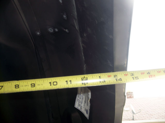

My well opening is just about 14" I think I'll be trimming it so it is 14"

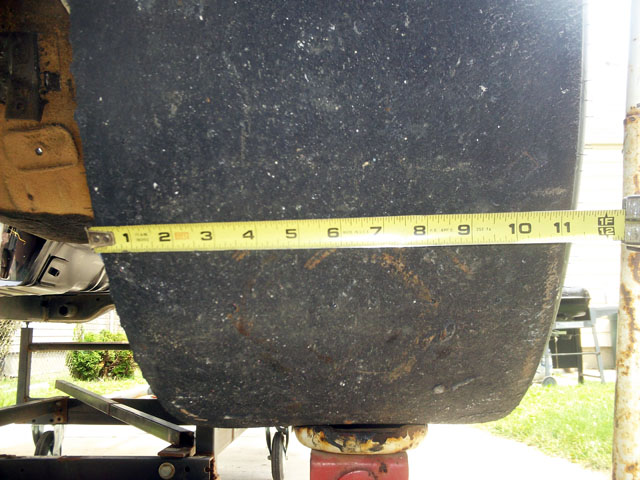

and the tire I'm using for the mock up is a 27.5x12-15
It's tread width is 11 "
I stuffed it up in the well as far as it would go and tried to center it in the opening as well as placing it where the axle should be.
This is where it ended up and that's about 3" into the well. Lets go with the fact that this is all an approximation and I could be off by an inch in any direction. This still leaves me with the fact that, if I'm going to use a wide tire like I want to, I have to dehump the wheel well and select the right rim offset to center that tire in the wheel opening.
