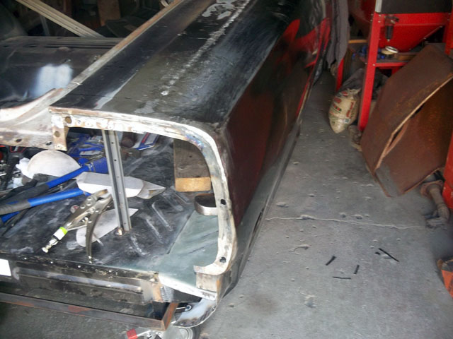

Well I'm on the other side now or at least mostly on the other side. I've got the quarter tacked in place for now.

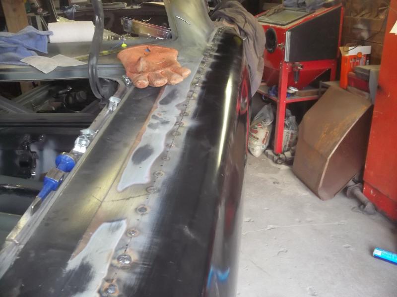

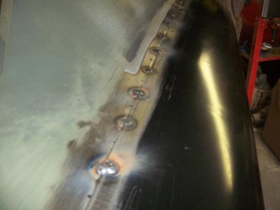

I figured out really quick to remove the panel clamps as soon as I had a weld near them or else they would get stuck. I'm running into a little bit of warping. For you guys that have done this before how do you deal with the warping? I've already started taping things back into place with a body hammer while it's still hot. before I get much further I want to recheck my measurements and retry my end cap to make sure everything stays in place.

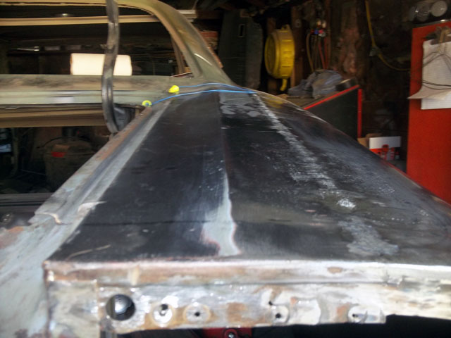

In this pic you can see a dip in the panel in a spot that I can't easily get to. Any thoughts?
Weld a bolt to it and pull.
Also quench your welds with a wet rag.

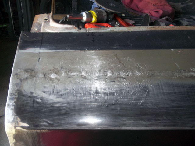

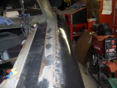

Finished my long weld this evening and it looks like minimal warping but I am going to have some bodywork to do.
I'd say that looks pretty darn good and it looks like the tail end is lined up still as well. From what I can see, it looks like the spacing by the door is even as well. I hope mine looks as well as yours does when I get to that point.

Yea the tail end is going to need some slight modifications to fit flush and I haven't even really looked at the door opening yet. So far so good though

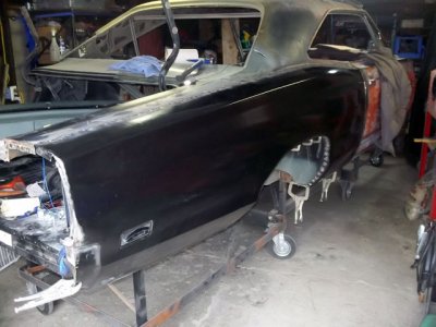

The Coronet officially has a name now, it's going to be known as Scar, and Scar is trying to kick my *** with this quarter that I welded on. What I originally thought was minimal warping was me kidding myself. It's more like a wave, it starts out high at the tail light panel, dips down towards the middle of the trunk opening, goes high again at the end of the trunk, then finally low towards the end of the side window. My body hammers are really getting a workout with this problem and I already broke one of them haha. I knew the quarter was going to be a lot of work but I wasn't expecting this, what an eye opener. Now don't get me wrong I'm not giving up, I will beat this quarter into submission and Scar will not kick MY ***!

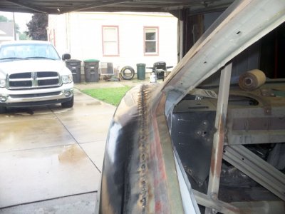

It's a little hard to see the wave in this photo but it is there. Slowly but surely she's getting straight.
if GOOD bodywork was easy, anyone could do it. Take the night off, and you'll kick that quarters *** tomorrow!
