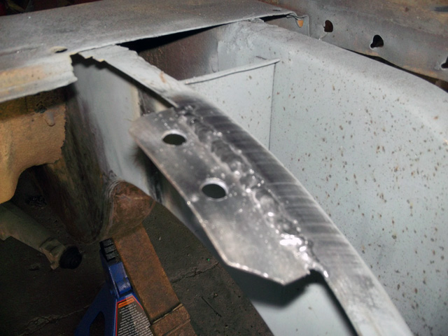

As I'm installing the rear frame rails in the Coronet I noticed that they do not have the tabs that the shock tower welds to. To remedy this problem I cut off the tabs from the old frame rail and welded them to the new frame rail. I'm definitely getting better with my welding.

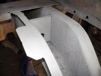

Then a shot of zinc oxide primer to help prevent rust.

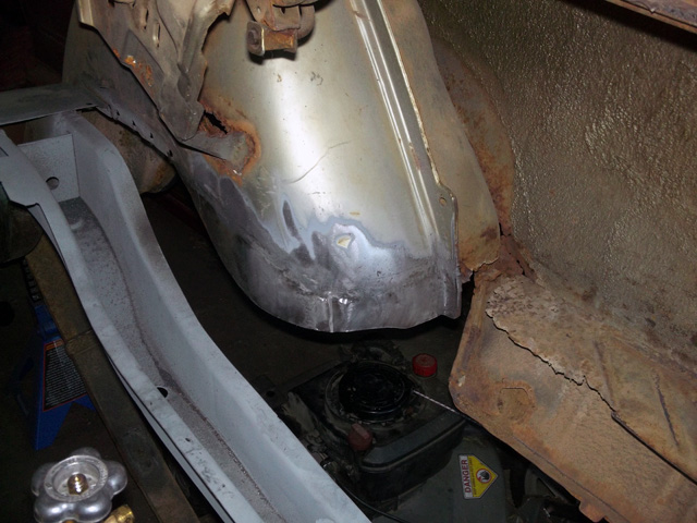

I've also started repairing the inner wheel wells today.

Well, I got a little more done on the Coronet. The right inner wheel well is patched. Now I have one more patch to put in and that side inner will be done. My thread is starting to look like all the other threads here, Start in the rear replace the frame, patch the inner wheel wells, replace the trunk floor, then move on to the quarters. I guess this means I'm doing it right. :)

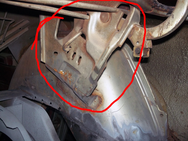

What do you call this part? Trunk Spring Bracket? Trunk Hinge Bracket? Trunk Thingamahitchey? I think I need to replace the lower half of whatever this is on both sides.

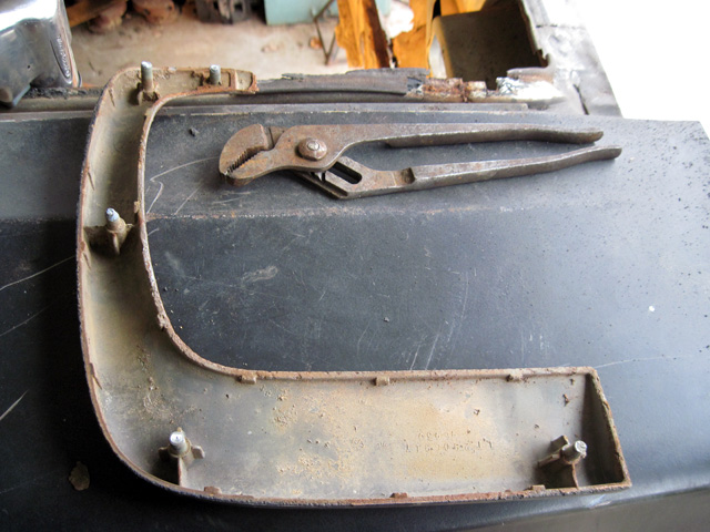

While I'm at it what is this part called so I can try and replace it.

you're correct on the 1rst picture trunk lid hinge (bracket) . the 2nd photo, that is called a channel lock pliers.
Sorry, couldn't resist. That's your quarter extention.
Thanks I was wondering what those were called. :p
My guess would be trunk hinge support. Progress is looking good!
