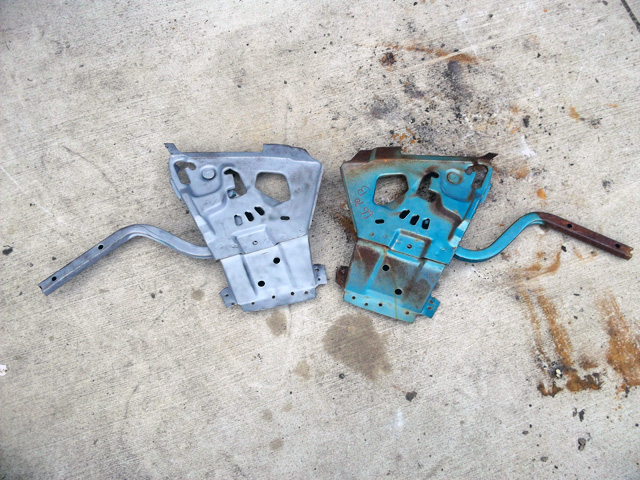

Well my trunk hinges that I bought from moparmarks showed up yesterday. They are in great shape and I immediately started to clean them up. I definitely recommend buying from him. I had pictures before I bought and once I did they were here within days of the order.

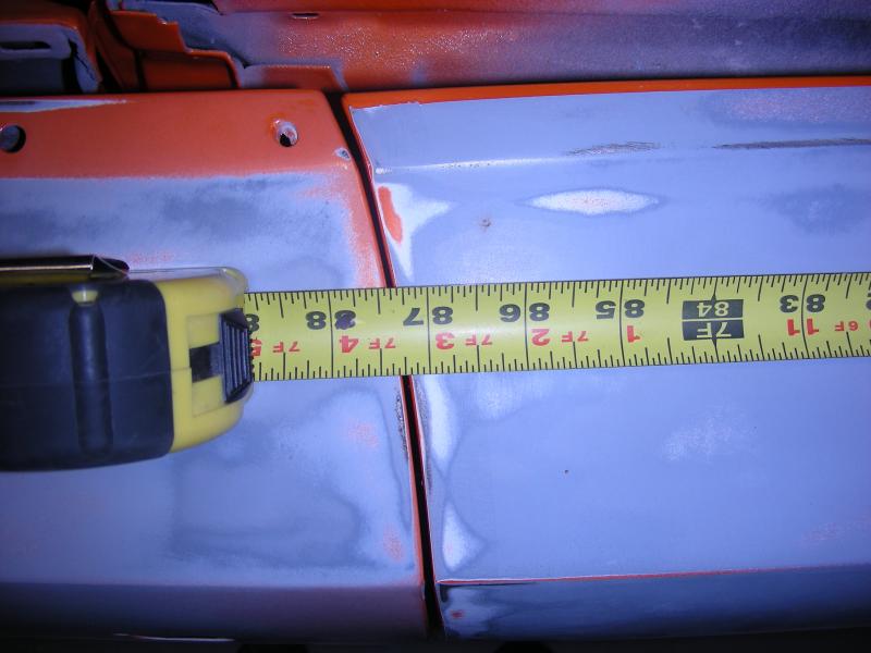

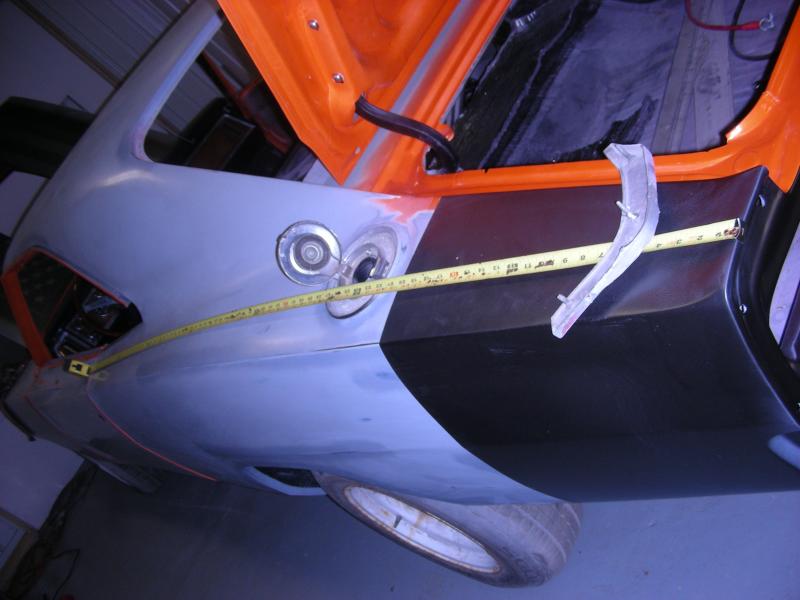

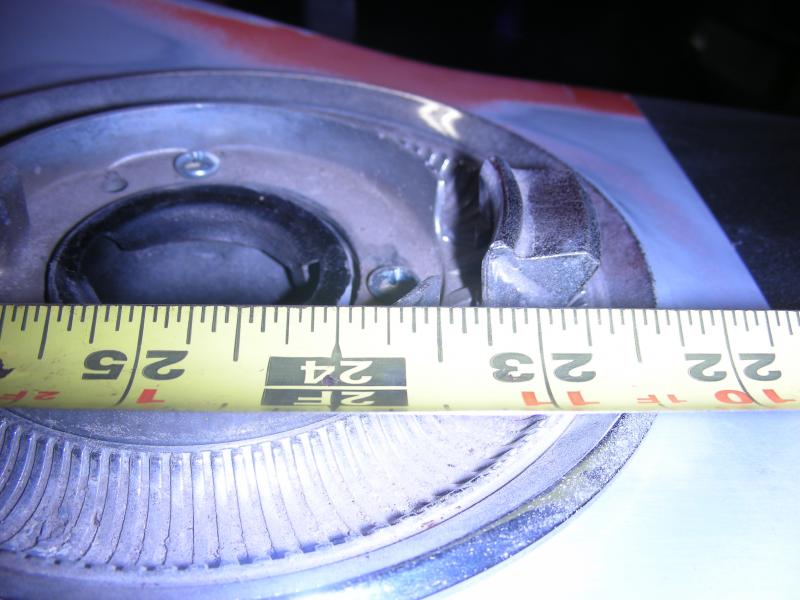

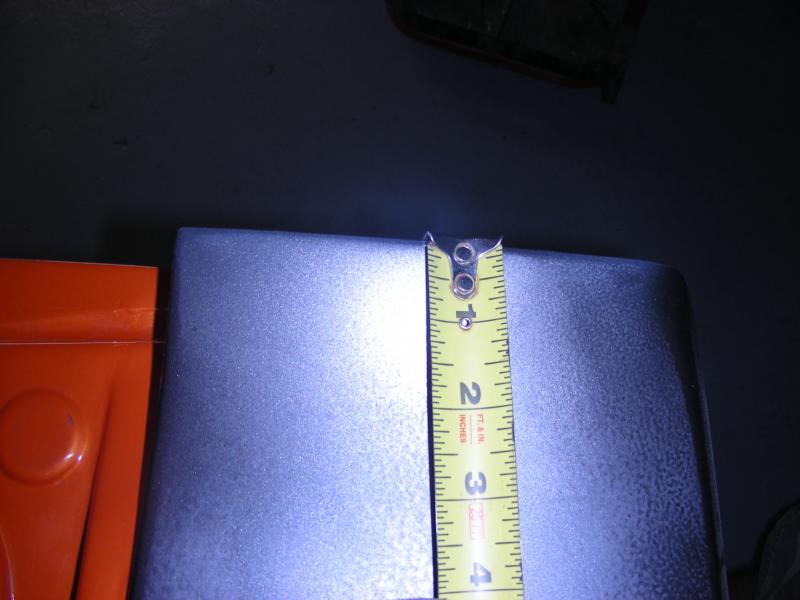

Sorry, couldn't seem to get the pics PM'd. Hopefully you can use the screw hole as a reference (measurements without quarter extensions installed).DSCN7925.jpgDSCN7924.jpgDSCN7923.jpgDSCN7926.jpg
That's perfect Devin now I can play around and see if I can make the Charger gas cap fit on my Coronet. It looks like I'm going to have to put it closer to the edge of the quarter than on the Charger because of the body lines. I think the next part is going to have to be the trim ring so I can see how much it covers the indents on the patch.
If it were me I would just use that measurement as a rough idea, cause like you say it won't directly transfer to the 'net's dimensions and body lines. But just eyeball it from every angle you'd be able tp see it and find it a good home on the quarter wherever looks good to you.
You can always custom rig a flexible hose as a filler neck down to the tank of the straight neck wouldn't match up. :icon_thumleft: really looking forward to seeing that mod done though, should look awesome!

If I can make this work I'd like it to look like something Dodge would have done. I want it to look as stock as possible. The hard part looks like it will be finding a Charger filler tube or something close that I can cut up and reweld to fit.
I don't know what your doing for the tank but I think a Charger tank would bolt right in then you would only need a flat area above the filler hole to mount the rubber seal. The hard part about the filler tube is the top, screw flange, breather, rolled lip etc, other than that it would be easy to make.
Yea I'm pretty sure a Charger gas tank will bolt up to my Coronet. Hopefully I have a guy who has a filler neck for a Charger that he'll sell to me. Other than that I was thinking about cutting the filler tube for the Coronet in half welding on a mounting ring and extending the tube to make it all fit. I'll post pics when I have them.

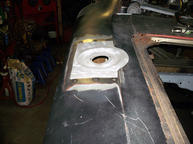

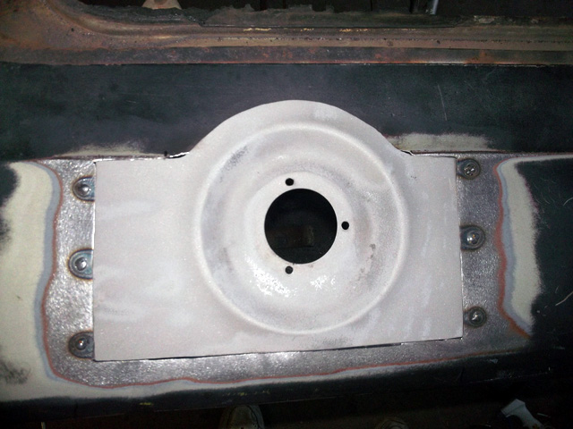

Well both inner wheel wells are done so now I can finish the rear frame and trunk. On the more fun side I started fitting the Charger gas cap onto the Coronet.

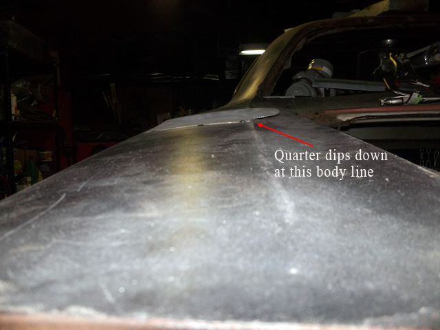

Here's the initial placement I just have to figure out the best way to blend the cap into where the quarter dips down it the trunk lid.

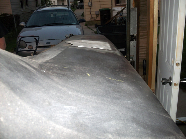

It fits pretty well considering it's not made for the Coronet. Right now it's just sitting there. It's not tacked in. I'm not sure on the best way to make a compound bend in metal. It has to go around the cap and flow into the quarter. Any ideas?
Can you go from underneath and maybe cut a little on your top body line and then integrate the cap ridge into the bodyline.
or move the capwell as close to outer edge as you can and flange the the hole (on the quarter) so it sits lower, then you can fill in. Just throwing a couple ideas out there.
This is the plan Roger. I just need to figure out the best way to accomplish this and integrate the Coronet body lines into the cap.
