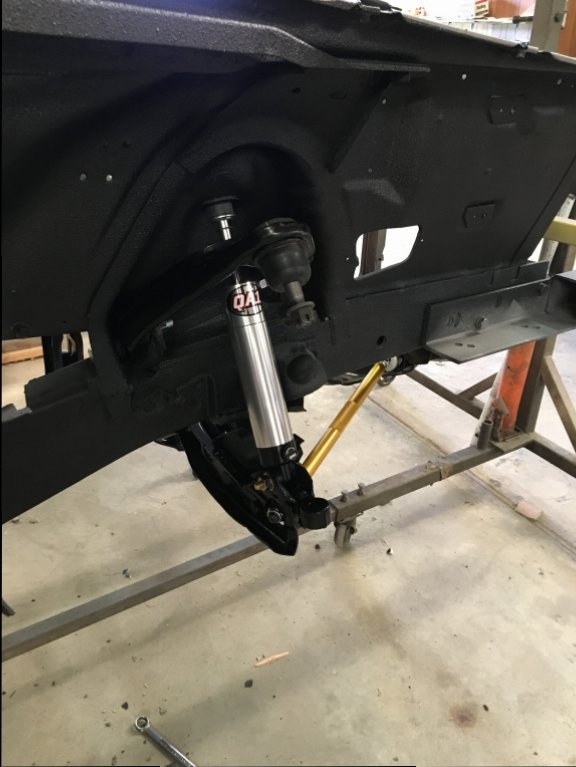

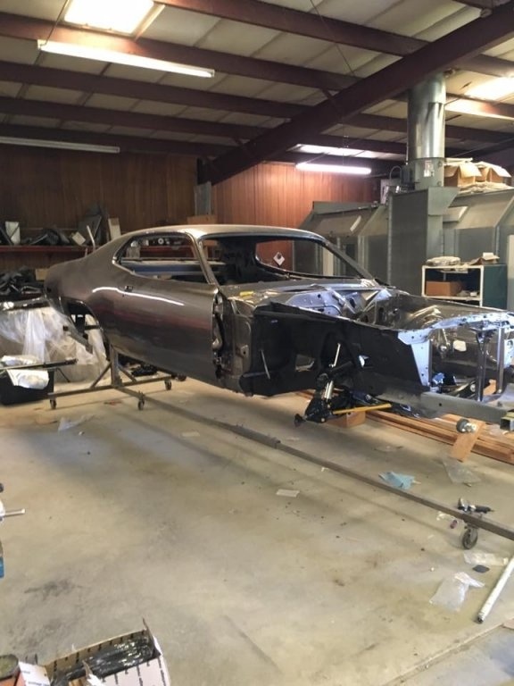

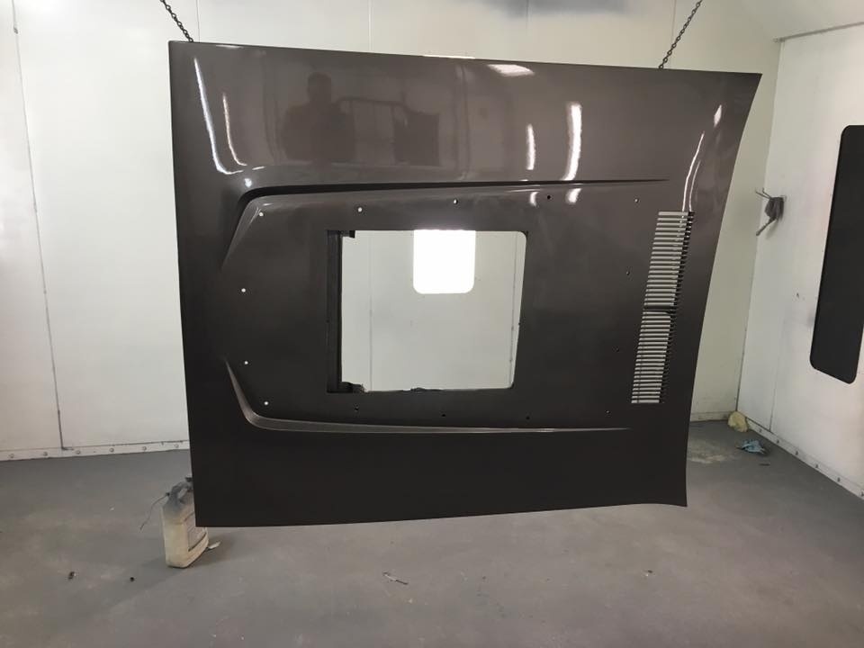

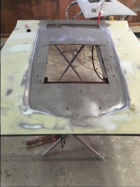

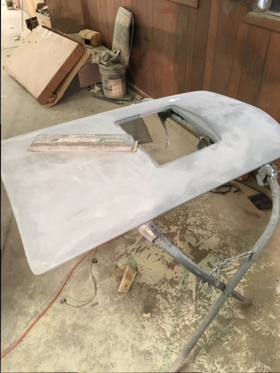

Suspension is going in and the fuel system along with brakes later this week. Body shop started in the Air Grabber hood as well. Some update pics:

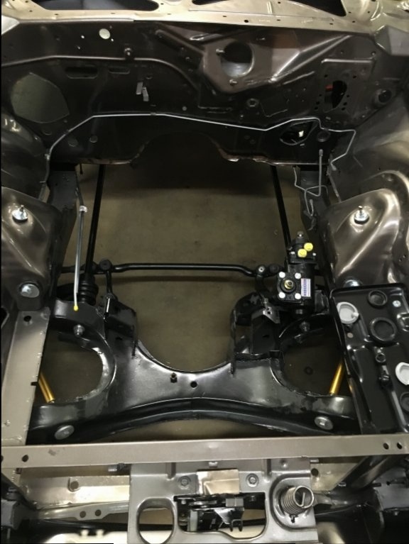

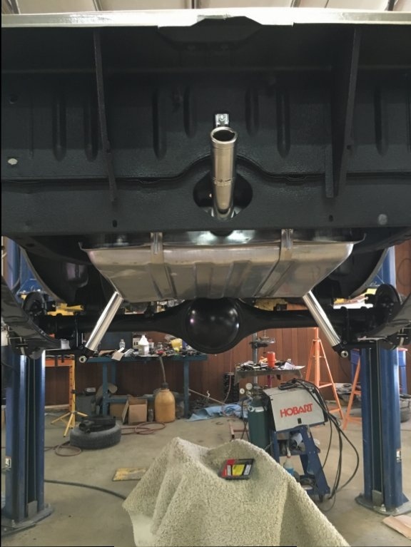

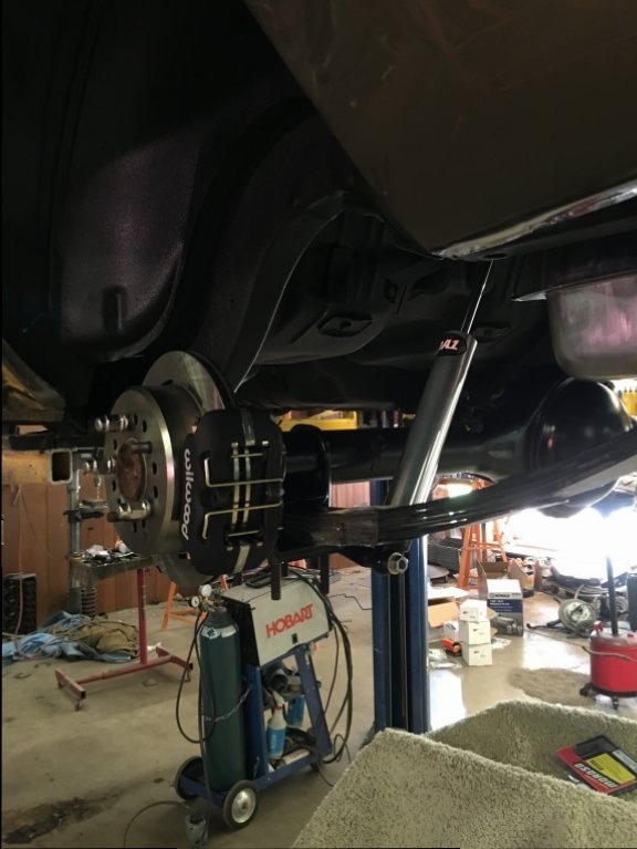

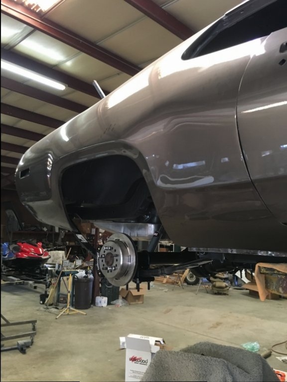

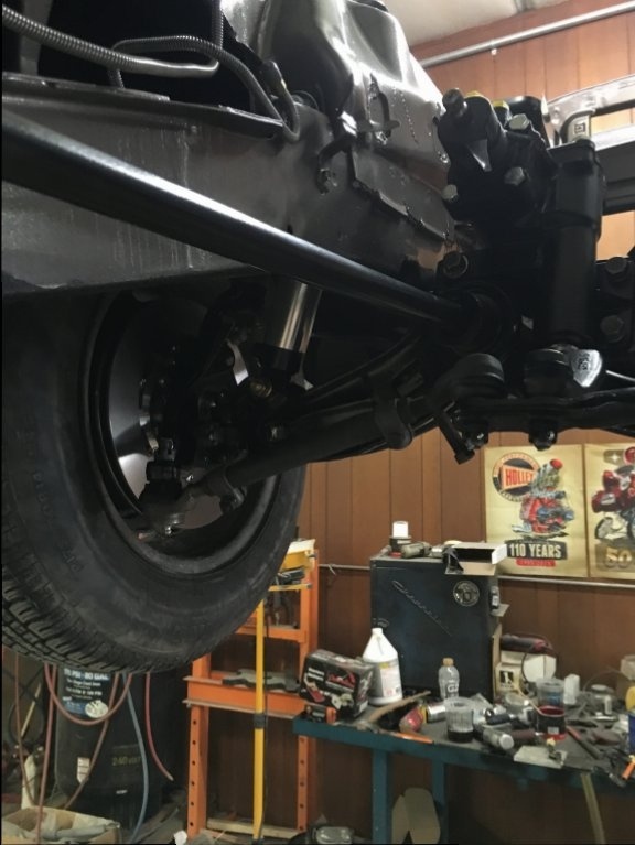

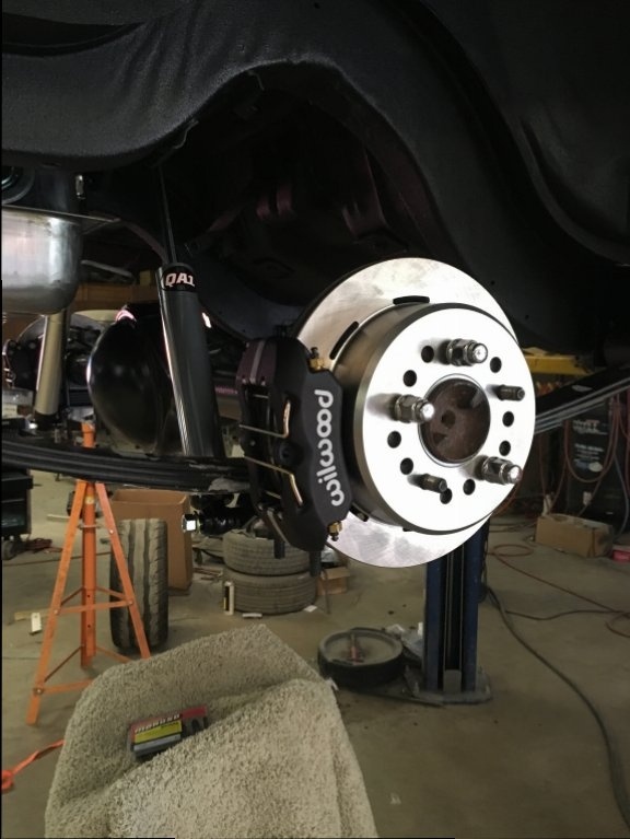

GTX suspension is in. Fuel tank assembly installed and lines will be hooked up soon. The brakes go on this week as well. The goal is to get her back on her feet soon. My bank account never seems to get time to catch up. I just dropped a mint it seems on the Borgeson Power Steering box setup, but after all the research, it seems like the most logical option to get the extra clearance and firm feel that I want. I really like the minimalist look in the engine compartment and don't want to overcrowd things. Here are few update pics:
Love the look of Wilwood disk brakes! Going to start looking at wheels real soon. Probably go with 17 inch and as fat as possible in rear :)

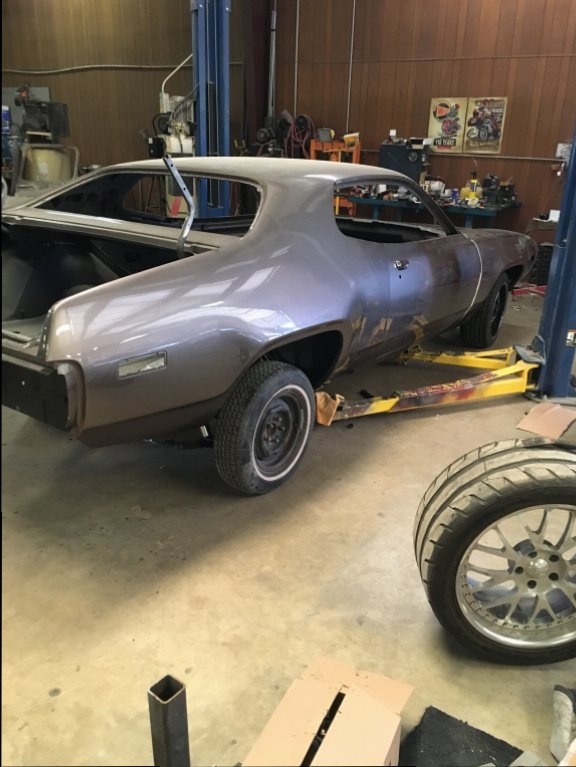

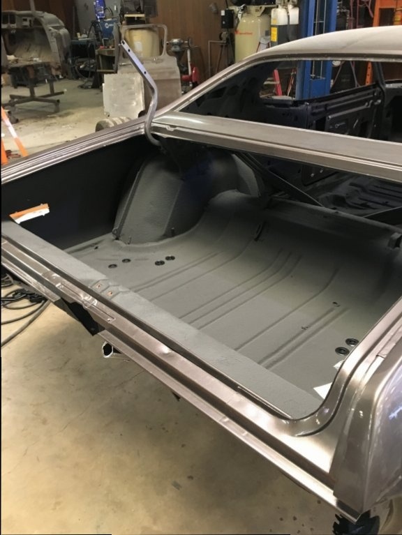

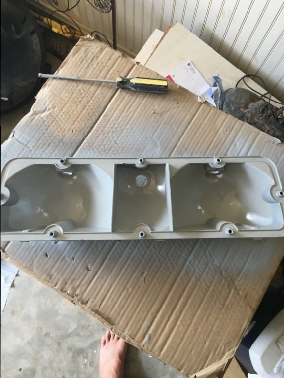

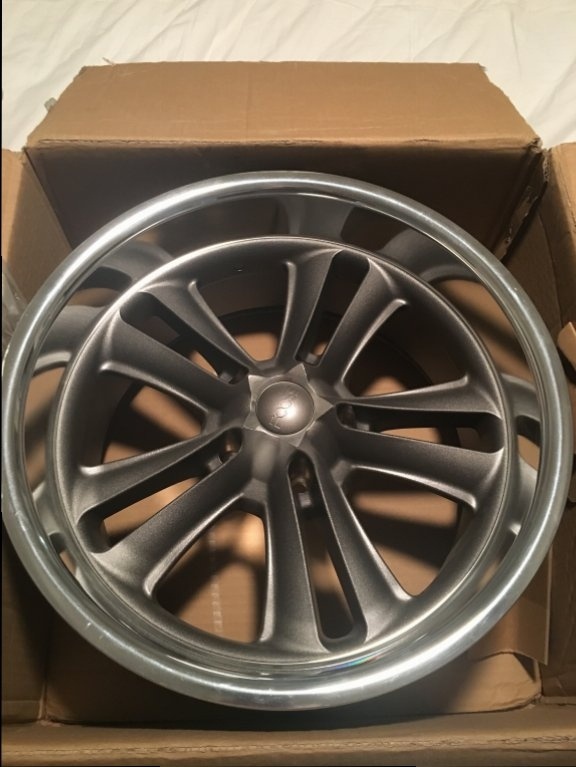

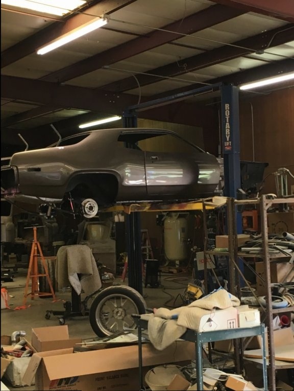

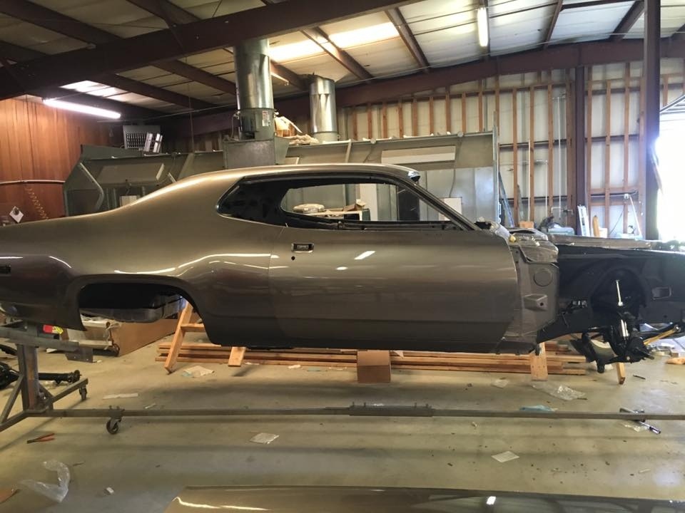

Suspension complete, fuel lines complete, brake lines 95% complete, and fenders/doors/valence installed. I blasted all the pedal assemblies and had them powder coated as well. I finally got to order something more fun in new wheels and tires. They should be arriving next week and will be on the car shortly afterwards. This weekend I am working on restoring the rear tail light housing. It is in pretty bad shape, but I refuse to buy a restored one off eBay. I have to patch some holes, install new sockets,paint, and redo the harness. Some update pics:

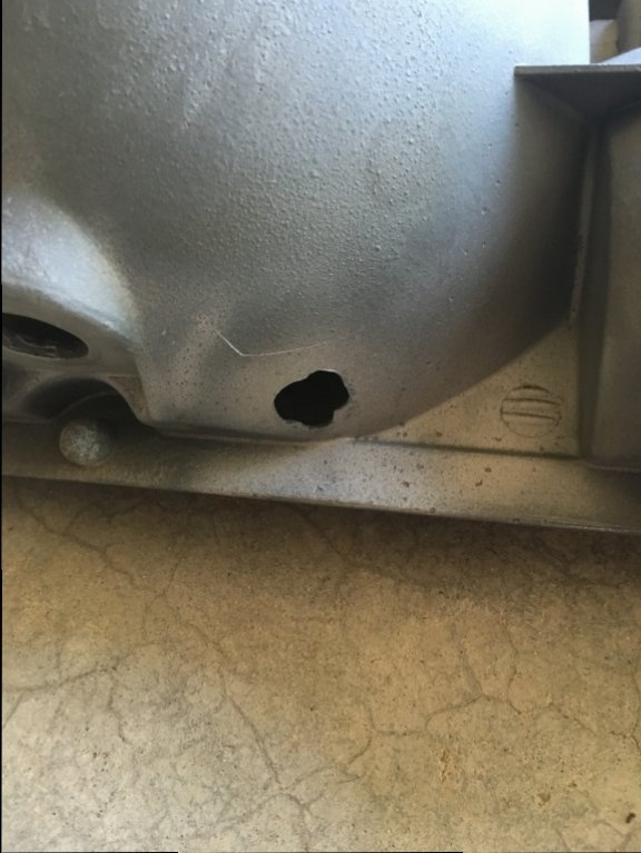

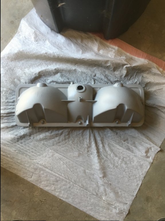

Blasted the tail light housings and patched the holes. I will sand and prime them tomorrow. Got my tires and front wheels as well today.

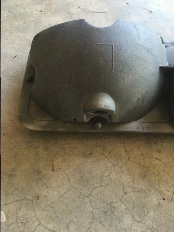

Primed then painted the outer shell of the tail light housing. I patched the holes with JB Weld quick set epoxy sanded, then skimmed coated with Evercoat Metal to Metal. I sanded this down and then sprayed a high fill primer over the whole housing. I am not overly concerned about perfection so all in all I was pretty happy to only spend $20 in paint and other stuff. Also, I read a study about the reflective properties of paint and light. White showed to be the best followed by chrome. I am testing out the chrome paint since I have items I want to use it on if it lays down ok. After the outer side dries, I will tape things off and spray the inside.
Inside buckets painted. Tomorrow I will start working the harness. I plan on going to LED bulbs for added brightness and durability.
