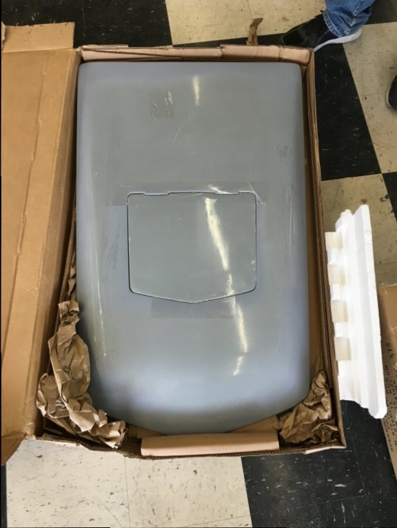

My original hood is in very bad shape and sourcing another one has been a challenge. The body man working on my car is a pretty special guy, and does some outstanding work. He swears he can take the aftermarket N96 bubble/door combo and make it look factory on the Satty hood I have. Other than the Air Grabber hood setup, the only stripes will be around the rear bumper lights and down the lower rear valence.
I'd probably still try to find a GTX/RR hood if you can. Then yet, it's your car. That color looks great even if it's a GM one. It looks like Winchester Gray but darker(?). The stripes would look killer on that anyway.

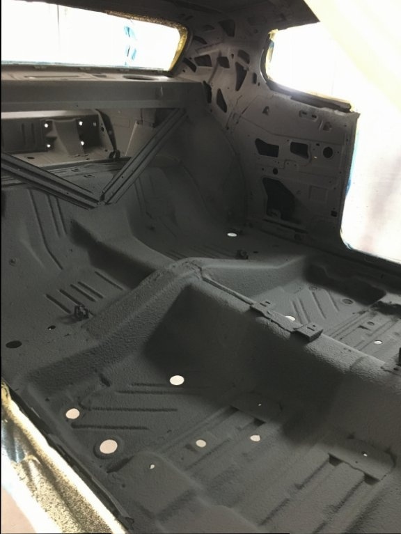

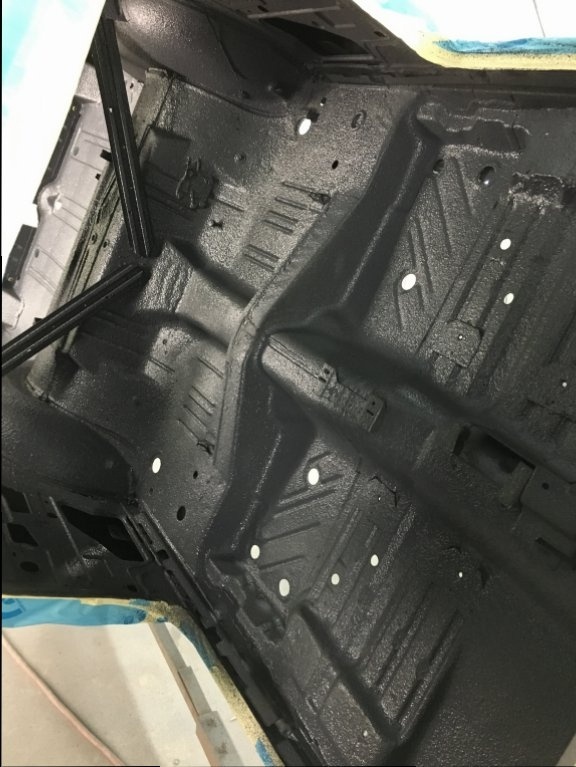

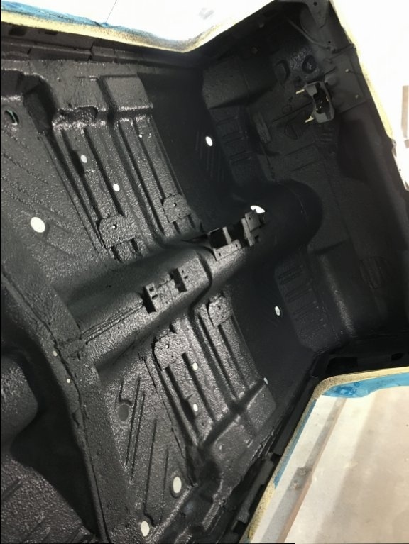

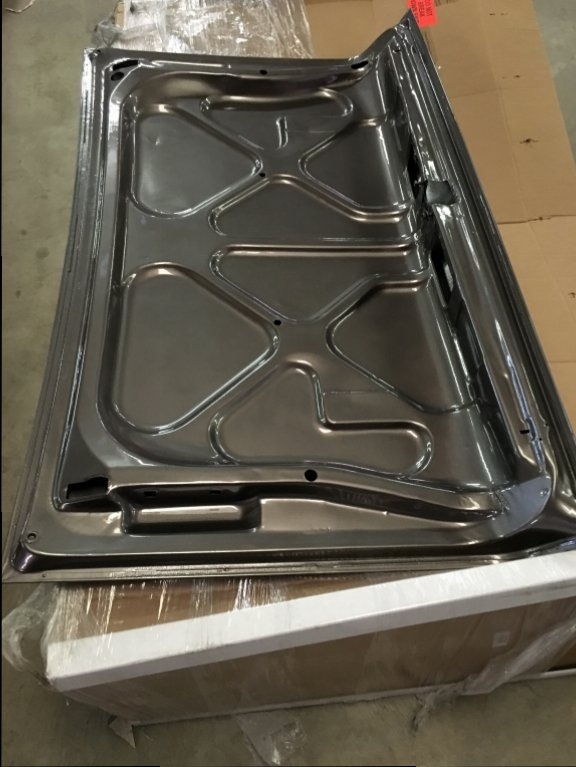

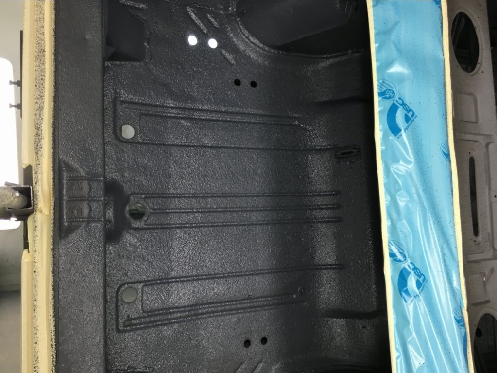

1st round of Lizard Skin has been sprayed in the interior. Tomorrow, if all goes well, the ceramic heat insulation will be sprayed on top.
Pics.

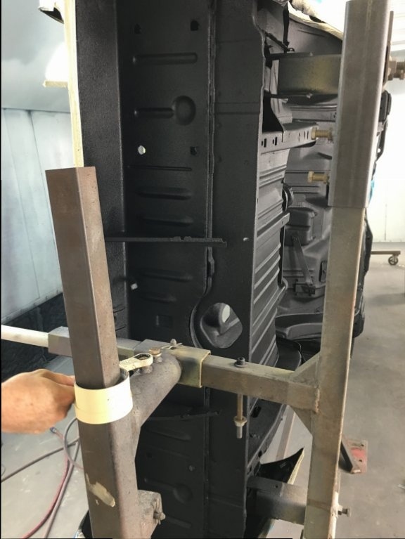

Topcoat of heat insulation has been layed down, and the underside & wheel wells have been coated with Upol Raptor liner. The lizard skin really quiets the metal down nicely.

If it helps any, the shop doing the body work on my car has never used it before until this build. They really liked that it was easy to shoot, water based, and cleaned up well. Also, when comparing the sound difference on the metal, the Lizard Skin deadened the sound better than the dynamat. The only drawback is someone might be skeptical about the condition of the metal underneath the Lizard Skin, but I have documented this build with tons of pictures to prevent just that sort of thing.

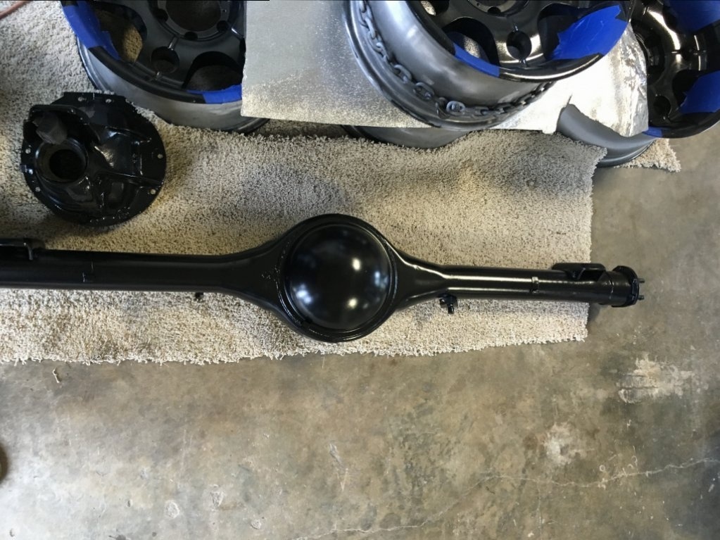

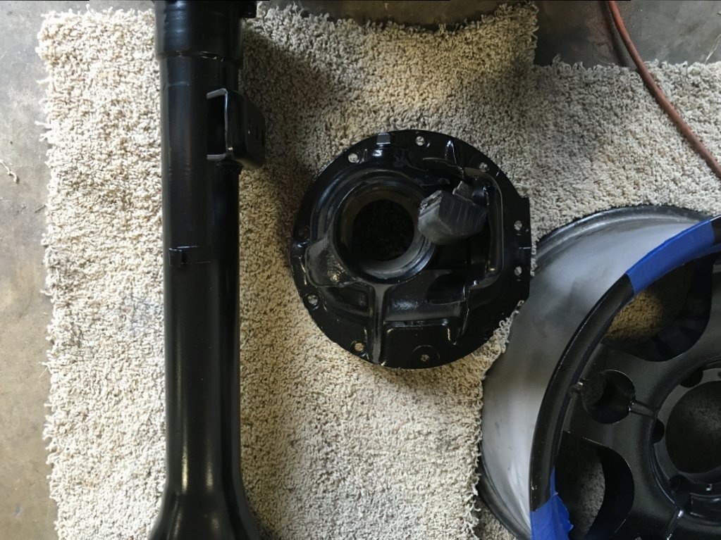

Progress has slowed down a bit as we wait for the powder coater to get caught up with all the suspension parts. They did finish the rearend and I am having the gears swapped out to 3:55's and new axle bearings pressed on. Pics of the diff (rims are not mine).

I think you both will be satisfied with the choice. I researched so many products and this one stood out. I figured if I was going to go all out and tear the car down this far, I should put this on as a permanent solution. This also saved me quite a bit in overall paint costs, as there was no need to shoot the inside, trunk, and underneath the car as this was going directly over the epoxy primer.

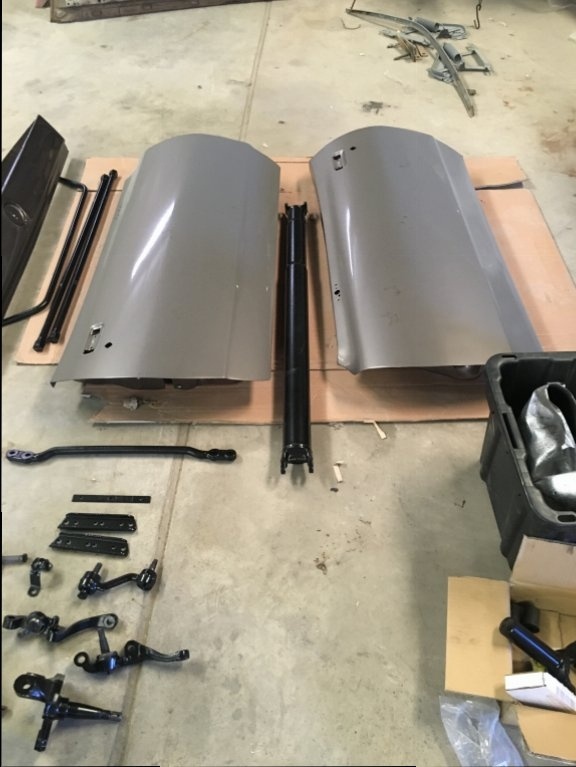

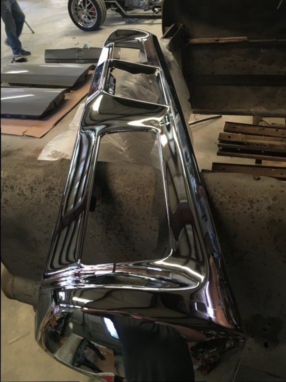

I decided to black out all the chrome pieces with a flat satin. The powder coater did a fantastic job on the bumper. This was a real cost saver. I blasted my air cleaner and he put a real nice textured finish on it. The only bummer is that my rear bumper was rusted and to dented/pitted to save. I will be buying a new rear just to have it powder coated.

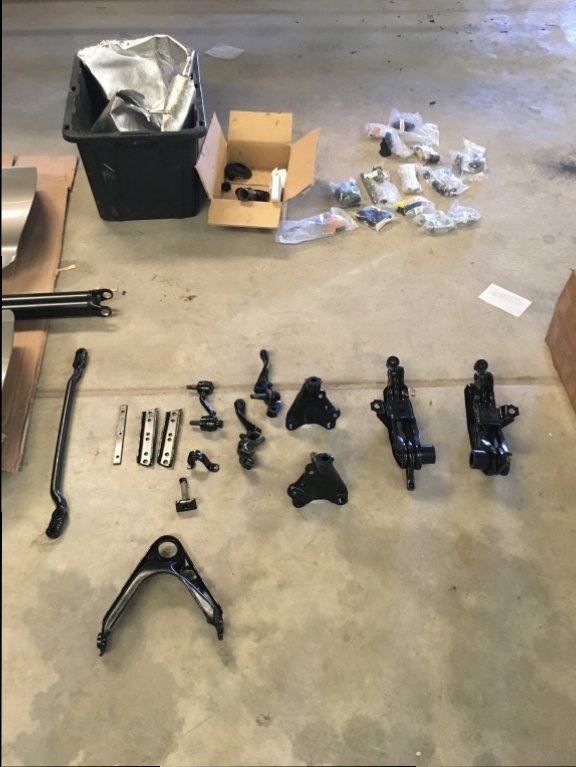

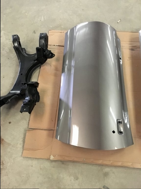

All the suspension components are back from the powder coater. Got in all new fuel lines, tank, sending unit, filler neck, and grommets. I have to repair the vapor separator as some of the metal rusted out. Also ordered new Wilwood disk brakes for the GTX which should arrive in a week or so. The fenders, valences, and header panel were painted as well. Got the new rear bumper and did my own flip flop on going back to using chrome over the blacked out pieces. It just looked too good against the paint. Hoping to have the car off the rotisserie and on her own legs in a couple weeks!! Pics are a bit dusty.

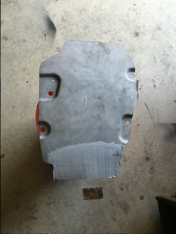

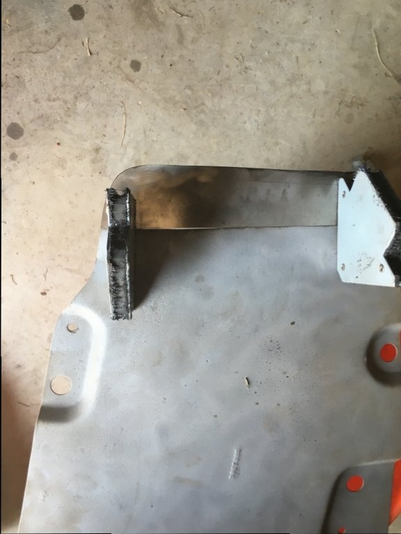

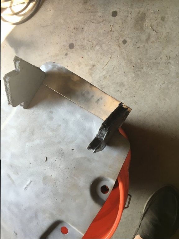

Welded up a new piece on the face plate of the vapor separator. Sine this will be covered in raptor liner, I wasn't overly concerned with perfect welds and stuff.
