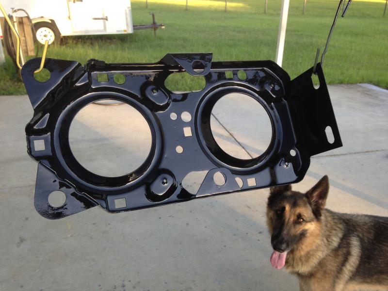

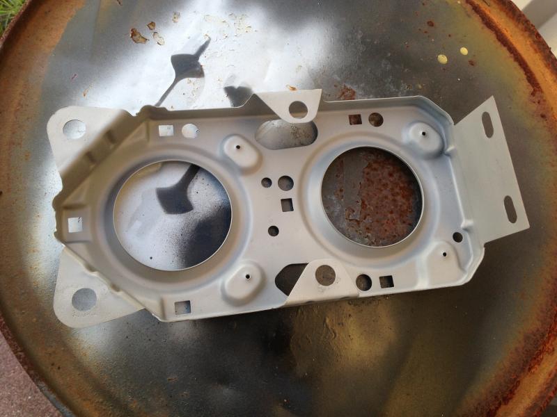

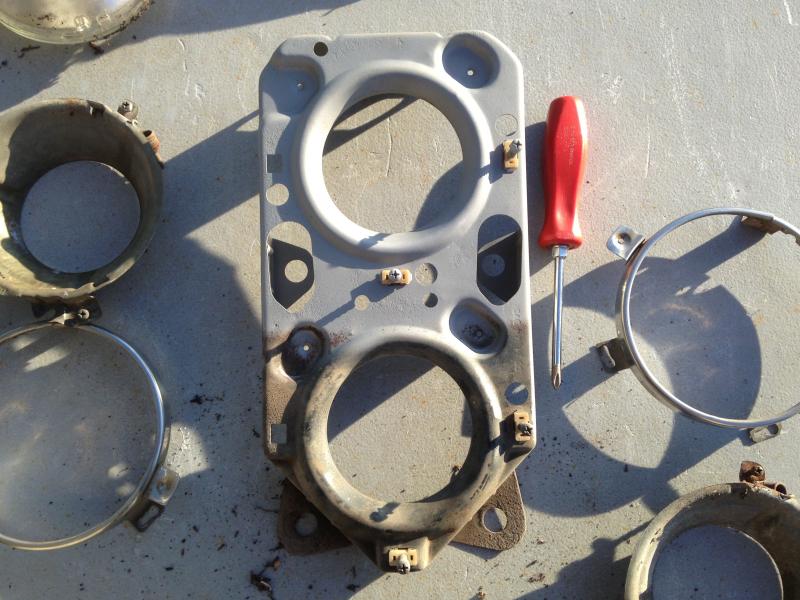

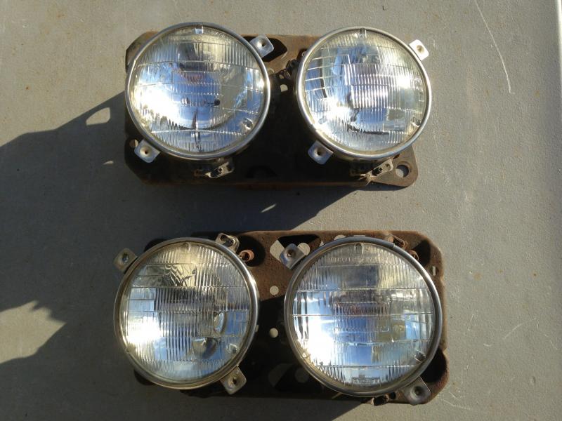

Headlight Bucket Assembly

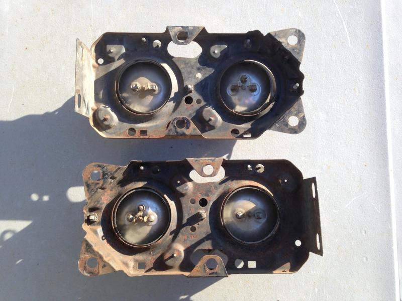

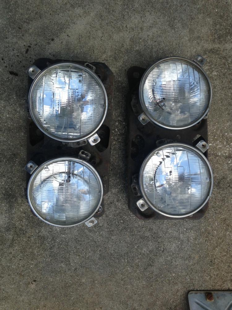

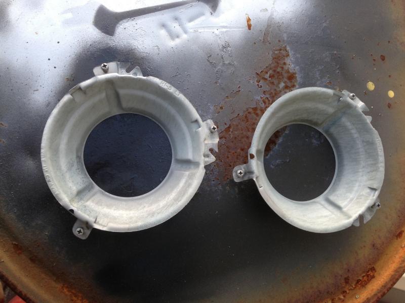

Last night I started working on the headlight buckets for the Road Runner. I took them apart and glass beaded them to bare metal, removing all surface rust and old paint.
Follow along with the photos....
These pictures show the process after I disassembled the buckets.
The bracket parts are the same between the driver side and passenger side. The only difference is where the headlight adjuster screws go.
These next pictures show the actual head light buckets. They are different so pay attention where they came from as you take the assembly apart.

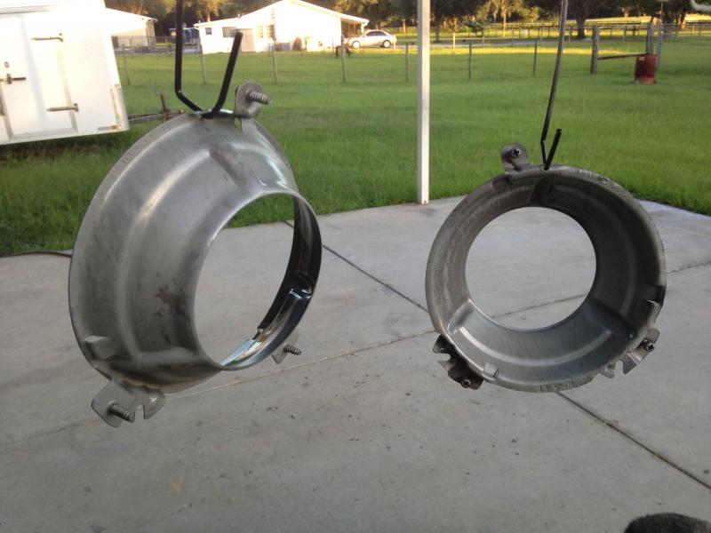

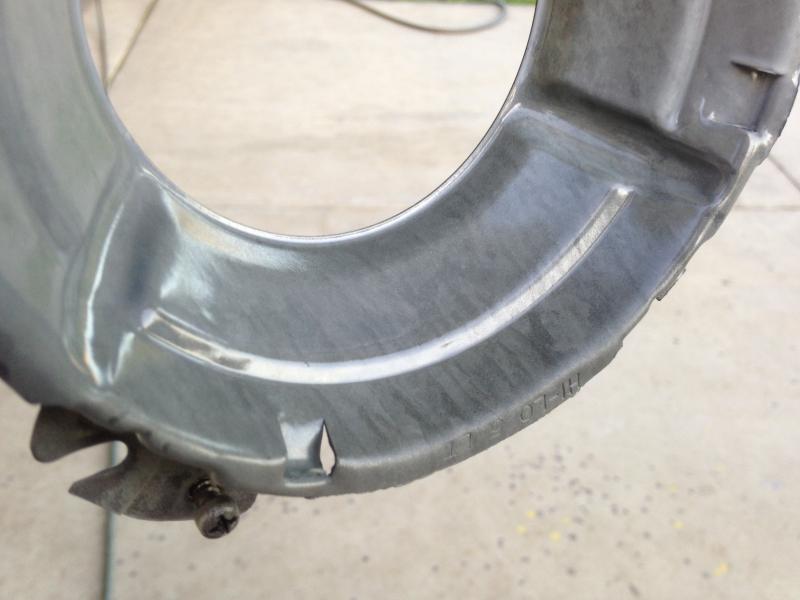

when new these parts were galvanized to protect them from rusting.
Most of the time the galvanizing remains intact, so all they need is a light cleaning.

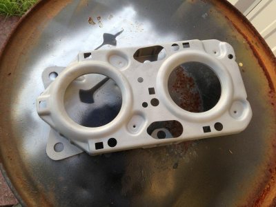

How I do it is simply hold the part a good distance from the glass bead nozzle and lightly fog the part with abrasives. Blow the part off and give it a coat of clear. This allows the part to look the same as when it was new.
These photos show the parts after paint.
You can see Heidi my German Shepard too!!
Now I'm waiting on the new headlight adjuster screws to come in. I purchased a new set of 4 Halogen headlights for the car. While I'm waiting on the adjusters I can polish the trim rings.
There you have it. Not hard, just attention to details...

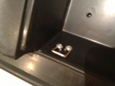

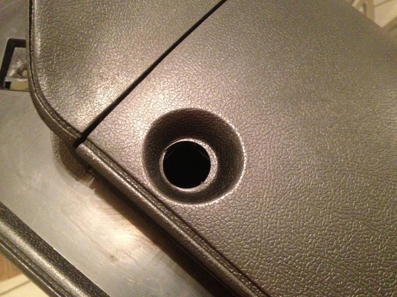

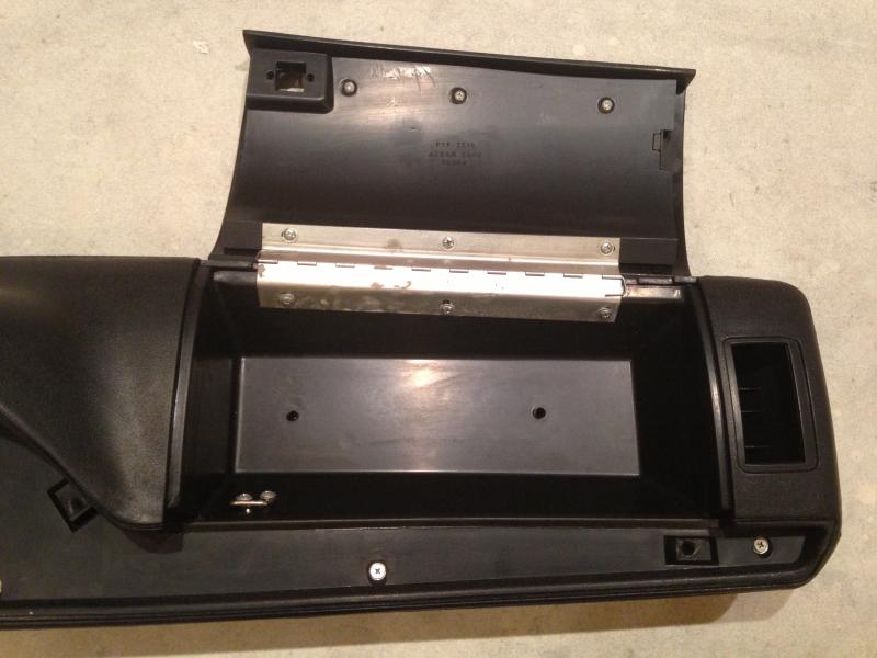

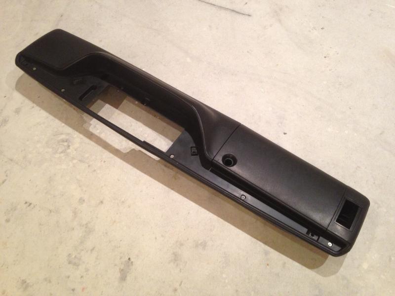

New Console & Transmission Tunnel Arrived
Just like clockwork!!!!
The new parts arrived a little while ago. It's like Christmas in July!!!!

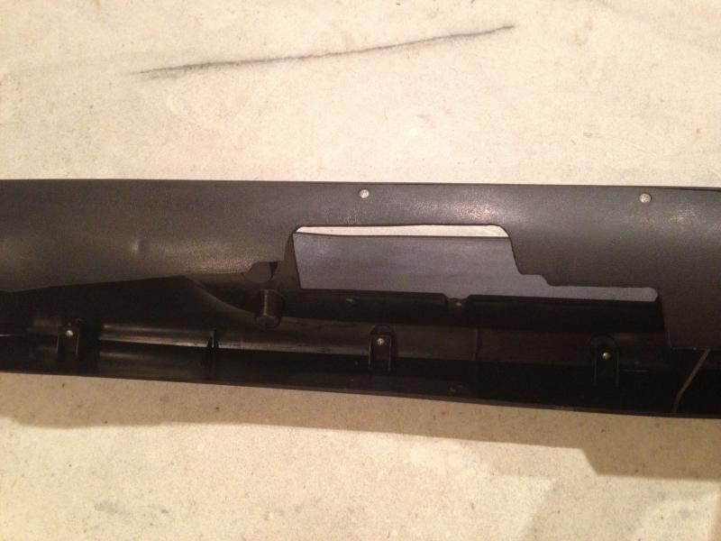

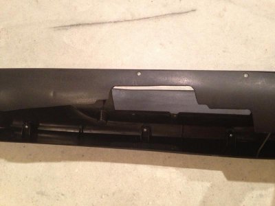

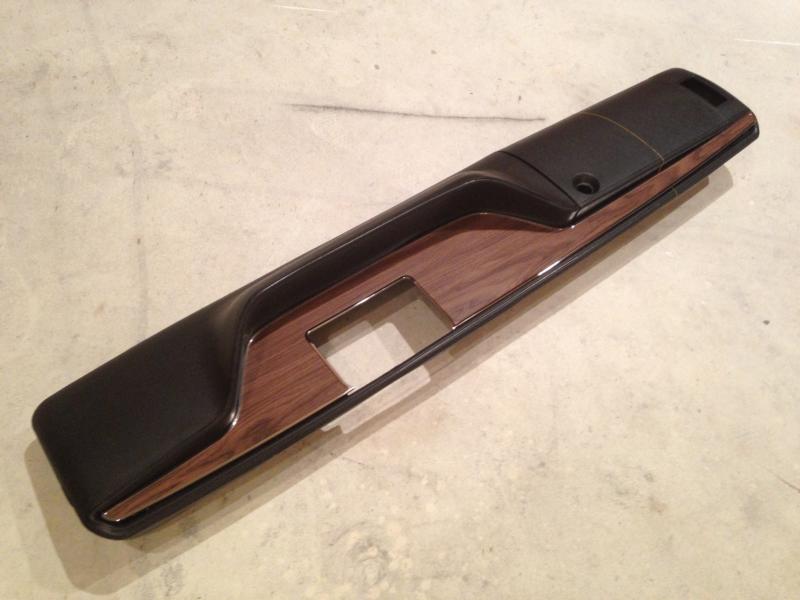

I initially had concerns about the aftermarket console that I had ordered.

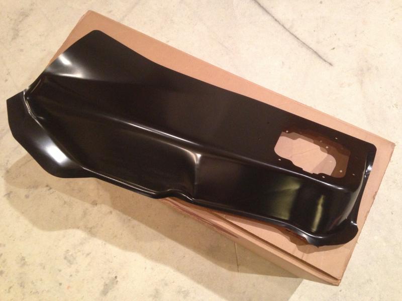

I was pleasantly surprised. These new consoles for the 71-74 B and E bodies ROCK!!! They have the same grain pattern in the plastic and are made from the same type of plastic as the original's were.
The parts even have all of the provisions for the console top plate, lock / latch assembly, etc.
tonight I will not have time to do a side by side comparison with new vs old. I promise that I will do it soon.
So in the meanwhile, here are some pictures. Enjoy them and have a good night.
Here are a few close up details.....
Here are a few pictures of the new transmission tunnel.
Now I'm waiting on the console top plate. It should be here in a few days.
The console came with new mounting clips for the top plate.

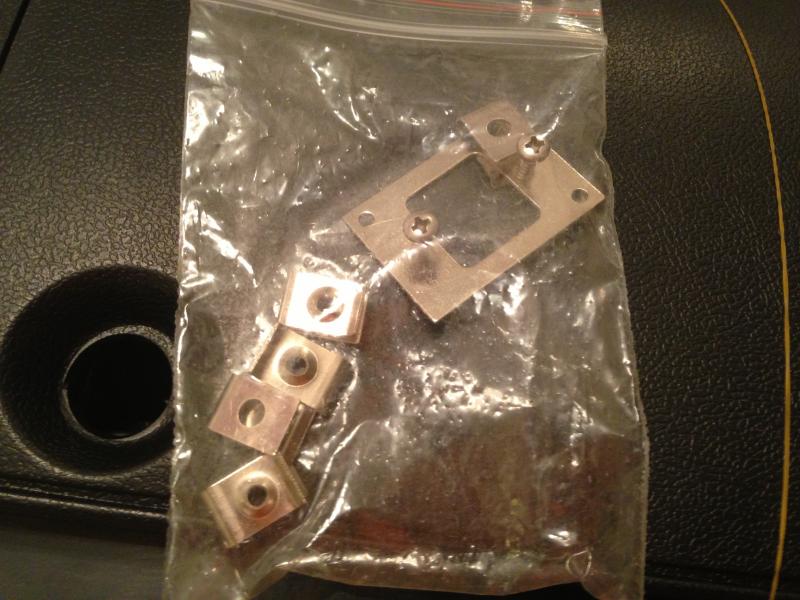

Grill Mounting Hardware / Clips

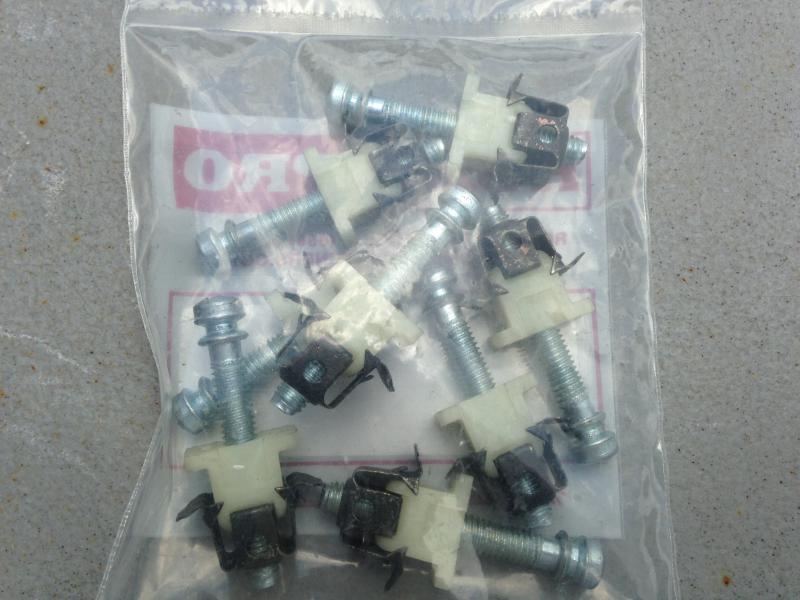

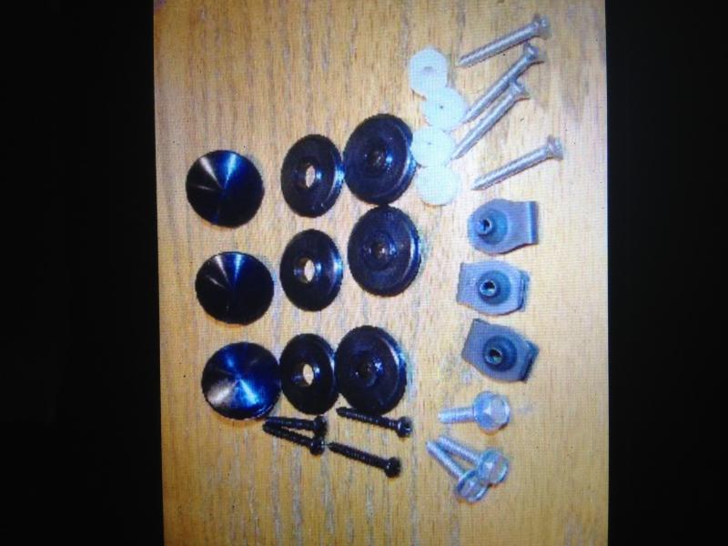

image.jpgimage.jpgJust a short note. I ordered the grill mounting plastic clips and hardware a few minutes ago.

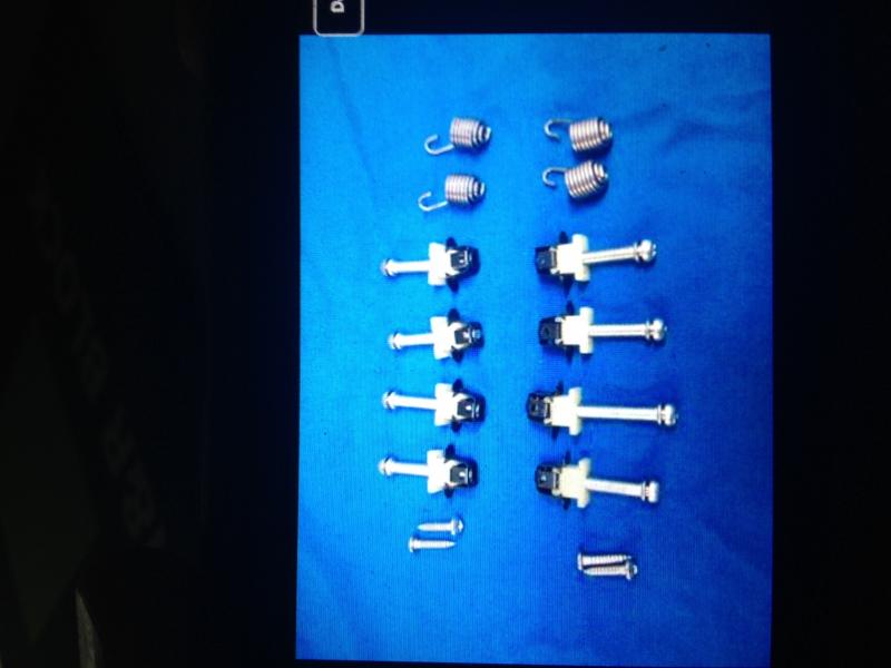

I also ordered another set of headlight adjuster screws from a different supplier so that I could get them a little faster. I'm anxious to get the headlight bucket assemblies finished.
A note of caution on these headlight adjusters!!!!
Up until recently they were available directly from Chrysler..but no longer. It's now a discontinued part. I didn't think about parts availability when I cut the originals out, because up until now getting new ones was not a problem. I found they are still available, just not from my usual sources.
I started worrying after I called 4 different suppliers and they all told me "sorry, no longer available."
FYI, Several persons are selling them on EBay..... and they are still available from Year One and Classic Industries
I always replace them on my restorations. It sucks when you break one after everything is installed, because the plastic is so old and brittle....
So I will have some extra H/L clips. That's OK because they were used on our cars up until around 1985........

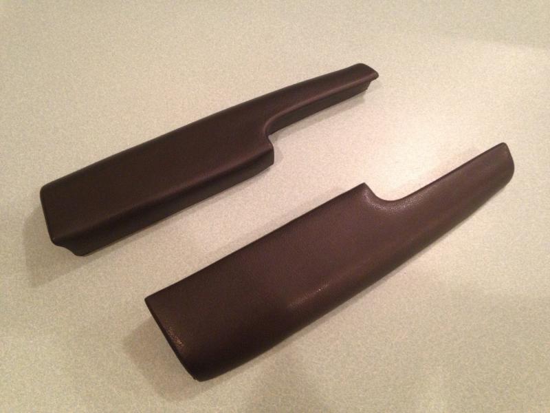

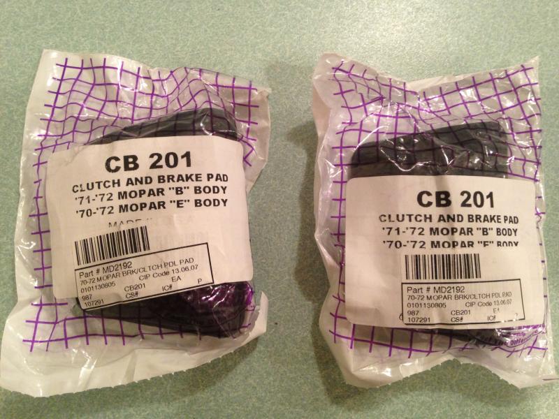

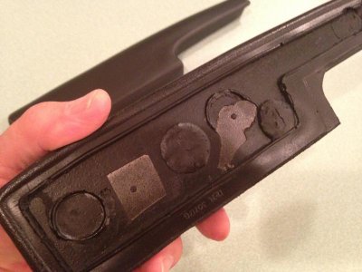

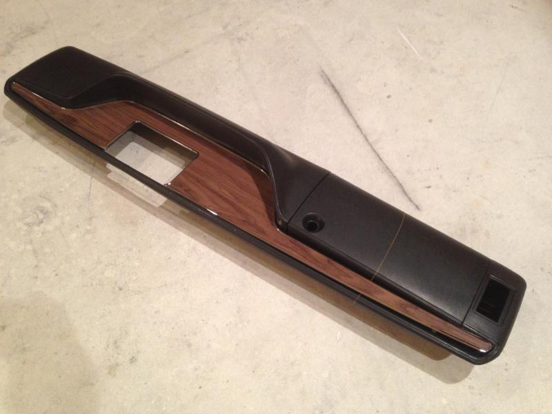

More parts came in.....

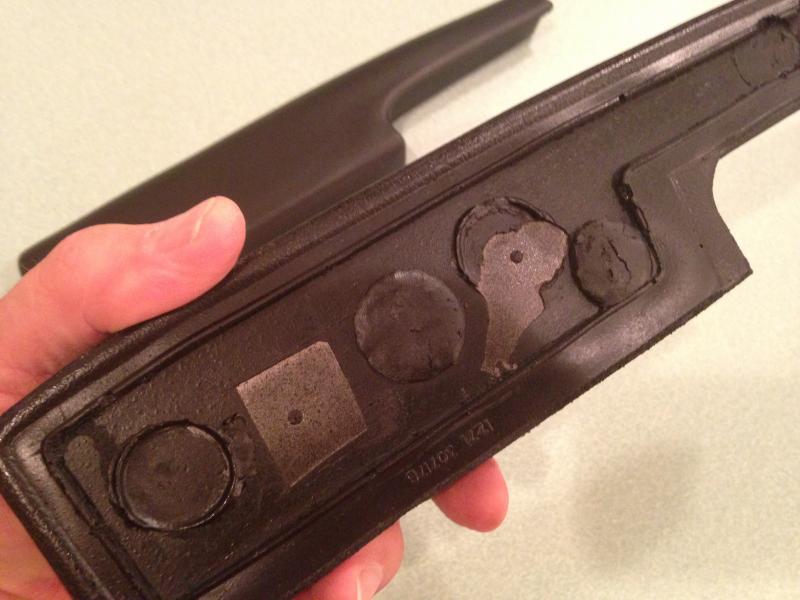

image.jpgimage.jpgimage.jpgimage.jpgimage.jpgTonight the 4 Speed console top plate came in along with a set of clutch / brake pedal pads.
I was also able to find a very nice set of reproduction arm rests. These have a metal core just like the originals did.
So far I have been very pleased with the quality of the aftermarket parts that were selected. If your interested in part numbers, where I found these items from etc, just send me a PM.
Hopefully tomorrow I can get something done on the car.
Until then, take care and have a safe evening.

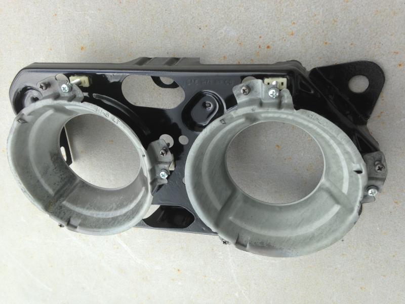

Here is one of the headlight buckets after reassembly. I still have to polish the trim rings and install the lights.
The parts look night and day between before and after.
Thanks for the compliments on my German Shepard. She's a good looking dog and very protective and loyal to our family.
What more could you ask for from a dog???

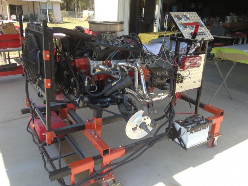

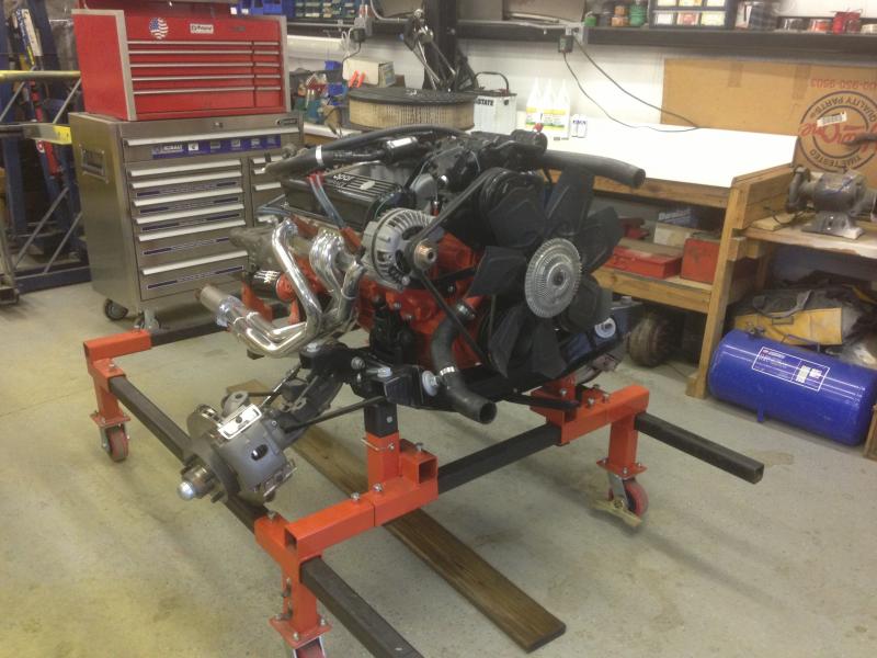

Gardner Performance Quickstand
Thanks for the detailed response and I'll PM for the link. Thumbs up on the blue text
Thanks.
I want to try and help out our returning Veterans. Without them, our great Country would not be what it is today, despite the politicians....
I am in the process of registering the business as a LLC and getting a tax ID number. I still have a long way to go before I can actually say its a "business".

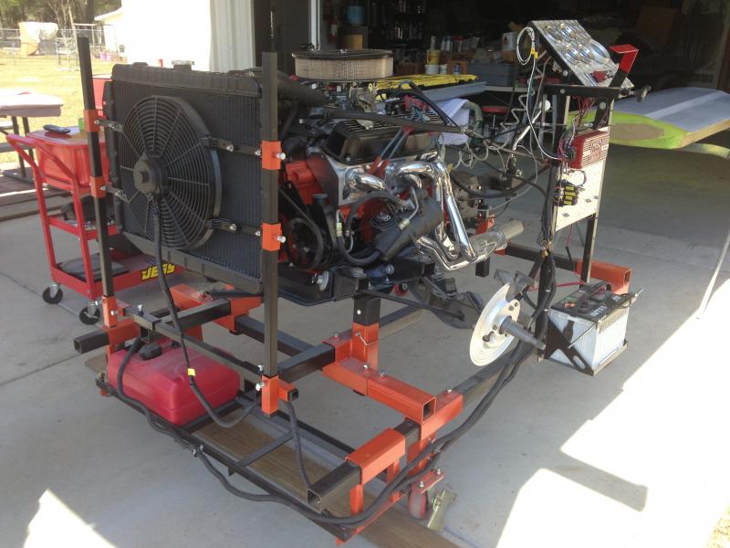

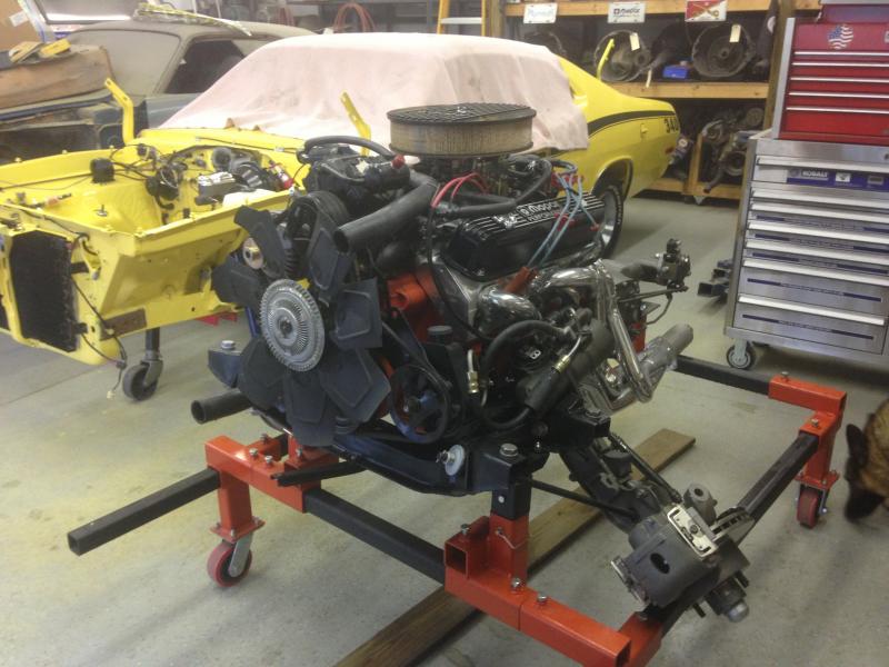

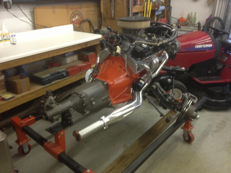

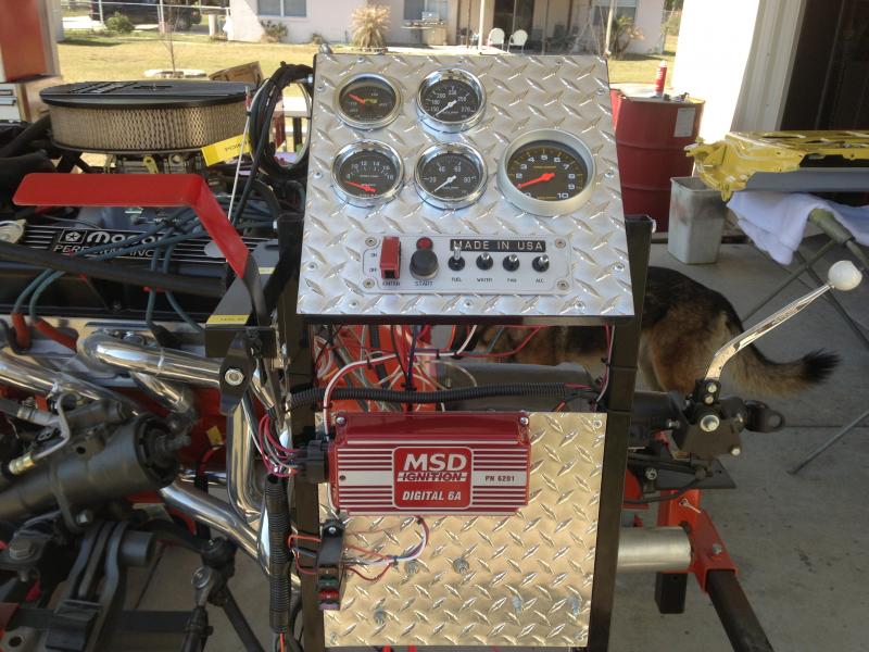

The quick stand is something I designed and applied for a patent on.
It will work with all engines from a slant 6 to a Hemi. We are making brackets so the Ford and GM guys can use it too.
You can purchase the complete stand with all modules or you can buy it a part at a time. You can have whatever gauges you need too. Each unit is custom made for the users needs.
It can be used as an engine test run stand and then converted over to an installation stand by removing the ignition, fuel, and cooling modules.
After your done with it, it breaks down to small sub assemblies and can be stored in a small space.
Then the stand actually holds the engine / transmission in place as you lower the body down over the top. I used it on my Duster and it worked fantastic.
You can use the stand to check everything out and make adjustments before the engine is installed while you can still get to everything.
You can set the timing, adjust the carb(s), valves, check for coolant and oil leaks, check headers for clearance issues etc.
I now have a very good machinist lined up to make all of my parts with a CNC Cad controlled machine. He has the ability to produce several thousand parts a day and each one will be exact.
We are building jig fixtures to hold parts for welding and I have a certified welder assembling parts.
I'm trying my best to use only parts made in the US or Canada.
I want to do my part to try and put Americans back to work.
If this business takes off I can become a vendor / supporter on FBBO too.
I am serious about the Wounded Warrior Project and helping our vets out.
Our website is still a work in progress. Look for an article in the future in the Mopar Muscle magazine and the Mopar Collectors Guide.

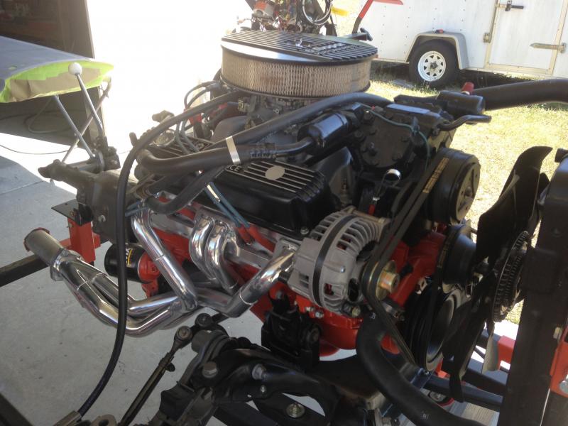

Here are some pictures of the test stand as it is used to install the engine from below. You can see how easy it is to remove the modules.

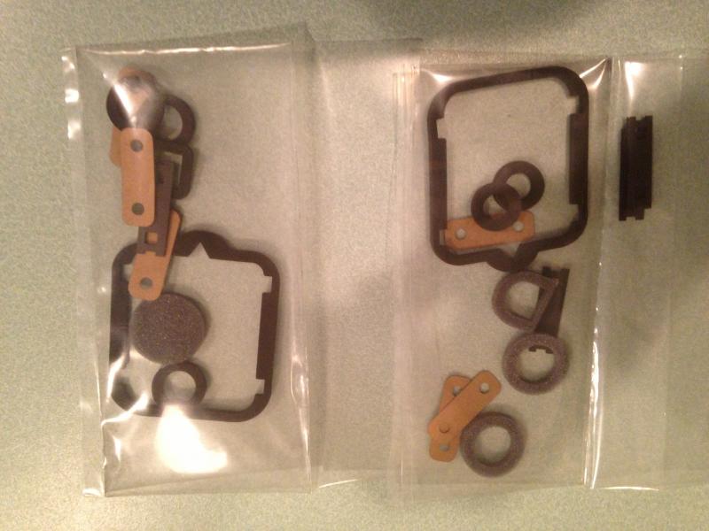

Today the gasket set arrived for both of my Rally Dashes. I ordered on for the Road Runner and one for my 1970 Challenger. Here is a picture of what is included in the kit. I ordered a couple of extra ammeter insulators at the same time. They are good to have on hand.
When I restore my cars, I take every nut and bolt apart and start from there. Whenever you take an instrument cluster apart, most of the time the foam gaskets just crumble away to nothing, and the cardboard parts become too brittle. So I try to get these parts in hand before I even attempt working on the gauge cluster.
So very soon I will be posting pictures in a step by step of the gauge cluster restoration on the Bird.....
BTW, I haven't forgotten to do the side by side comparison with the original VS reproduction consoles. I have to get the original one for my Challenger down from the storage room. Possibly tomorrow night if things go well.
Here is a picture of the gasket set for the gauges.
The set on the right is for the Road Runner.
