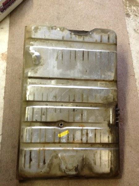

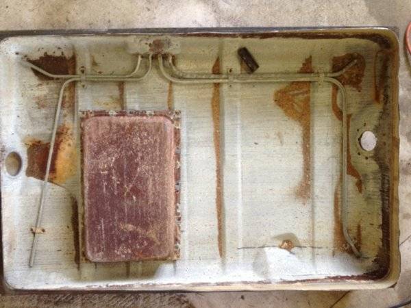

Thanks this is exactly why I am asking. Sometimes it’s better just to go new and be done with it. Clogged carb issues can be costly and frustrating. I like the idea to try and clean ot and just see. Until I have the tank out its a crapshoot. What motivated you to cut the tank open?My 70 Road Runner had been sitting for awhile. It was a California car and the outside of the tank looked great. The problem was that over the years of sitting it developed this fine beige "silt" than continually clogged up my system. I thought I could outsmart it by installing a fuel filter both before and after the fuel pump. It didn't matter - the fine silt still got through and clogged up my carb - twice! Could I maybe have cleaned it out? Possibly. But I threw in the towel and bought another tank.
Two pictures for reference. This what my tank looked like.
This is what my tank looked like after I cut it in half. You can see the grit (and this was after I had washed it out). BUT, I do think it would have been possible to clean if I had tried.

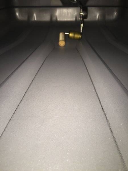

Given limited funds, I would suggest to remove it and try to clean your tank. See how it goes and what the inside of the tank looks like when you remove the sender and get a peek inside.

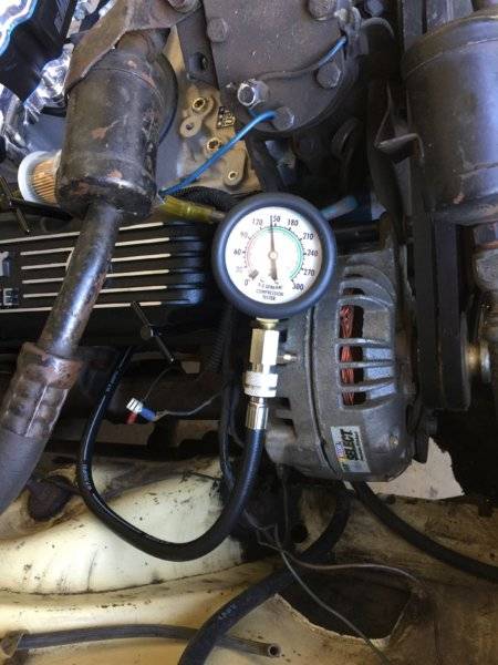

Yes it will I will be able to get that done tomorrow!It'll be interesting to see what the reading is on the remaining seven cylinders.

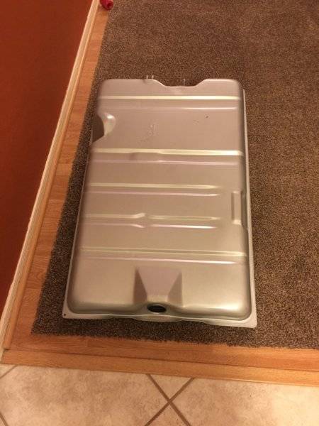

Got the tank out and no rust but sludge on the upper slope. I found a new tank for $90 I just think okd tanks are not worth the hastle of cleaning. Lets see how it goes.
The 1970 California tanks had a separate "little" internal gas tank that you can see in the picture. The intent of this thing was to reduce gas spillage by slowly absorbing gas, but slower than what you could pump it. So when you pumped the tank "full", the level decreased a bit afterwards and (supposedly) reduced potential spillage out the vent or gas cap.

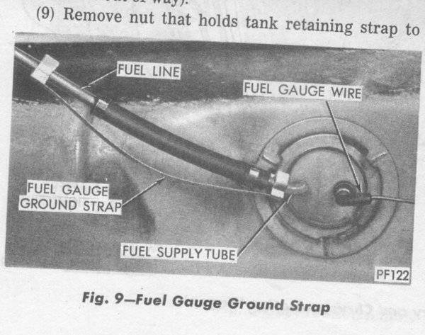

Hook up the sender with a jumper wire to the pigtail connector to verify your sender and gauge match before you install the tank. Factory ohm range is 10 to 72. Also re-use the original lock ring.
Hey Threewood jump where to where? A pigtail is just a dangling wire end so do yo mean in circuit (meter wire to center contact to the sender?) also I hear about a ground strap near the connector on the tank but saw no such strap or wire.
Thanks
Thanks JG I see what I need to fabricate now!You need this strap or your gas gauge will likely not work properly. You can also run a ground wire from the fuel supply tube -- using a really small hose clamp -- to the underside of the trunk if you don't have the strap.
