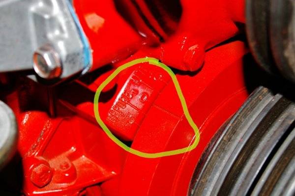

These (marks on front cover and the line on the damper). Note: these are on a '68 318. The marks on your '70 would more than likely be on the other side. But I'm sure you get the idea.
Ahh so Mopar did this OK I even took the paint off the damper in the area where I thought I was at TDC but it was smooth. Now that I know they had a factory TDC notch then I will hunt for it and see if I can find. I assume this is a factory set up but who knows its been 48 years lol. If its there I will see if it corresponds to what I might determine is TDC by the same method I used previously.

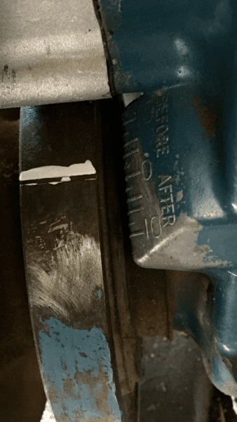

Ok so here is where I am at.
Replaced fuel pump.
Aligned crank to precise TDC marking on the H-balancer. See pic
I could not start it after multiple attempts. So my wife was like let me in there I had. Mopar in HS lol.
Engine fired up but it took some aggressive feathering by my wife. But died and lots of smoke which I expected. It did run a few times rather successfully and then I heard some rod noise I think as well. Ran real rough timing for sure was off as I was shooting it.
I shot the timing but before I could get that adjusted she either seized or I fried the starter even though I was letting it cool down between short bursts.
Now when I try to start the car I get a larger current draw and I hear what I think is the starter solinoid kick in. I think the starter is trying to crank but the engine won’t budge. I tried this 4 hours later to let everything cool down and charged the battery but again the starter sounds like its slamming the crank. I get no crank movement.
Replaced fuel pump.
Crap.....
Oh man, I really hope it is the starter. To know for sure, you need an 1 1/4" socket on a ratchet and try and turn the motor over by the balancer bolt. If it won't budge you will know the answer :(
Hey Threewood yes my plan is to see if I can rotate the assembly and confirm that she is locked up. I will also look for any metal in the oil. Probably will pull the starter to confirm that it works. I will have to pull the fan its just too difficult with that in the way and I don’t want to mess it up. If there is anything else I need to verify please let me know!
