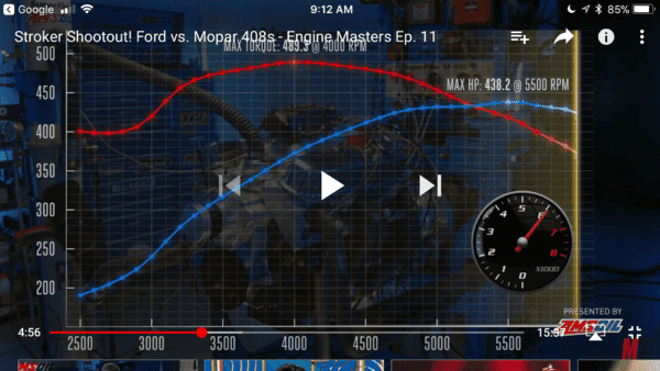

Feast on this. Great Westech dyno on the Blueprint engine. I actually saw this show on YouTube a fee weeks ago. This is the result of their 408 stroker with aluminum heads. The torque curve is not bad at all at 2500RPM! And at 3000 goes ballistic.
Seems about right! I think I have about 350-360 ft-lbs at 2500 based on the model but I have been over 3500 RPM once in 6000 miles! I drive like an old lady so I did not see the benefit of spending the time and money in figuring out what else I was forgetting I needed to do in the conversion :)

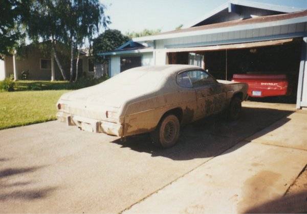

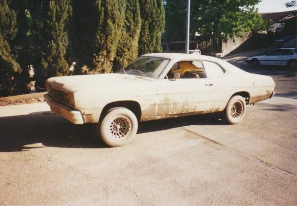

In 1996 I was trail running in my 73 318 Duster. I saw a swollen creek ahead and figured that I could make it. It was about 30 feet across and 30 inches deep in the middle. I was on the throttle and got through but it stalled out after I was on the other side. I had tools so I pulled the spark plugs and spun the engine over. Several holes shot water out! I blew on the plugs to dry them out then put them all back in. It fired up and ran fine afterwards.
