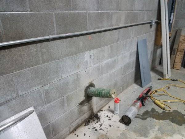

Boiler line in garage, far enough back to be out of the way of the garage door.View attachment 553205

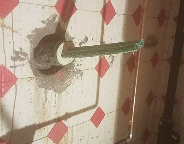

In the basement, for those who have never seen this it's a Styrofoam forming system...10" concrete. View attachment 553206

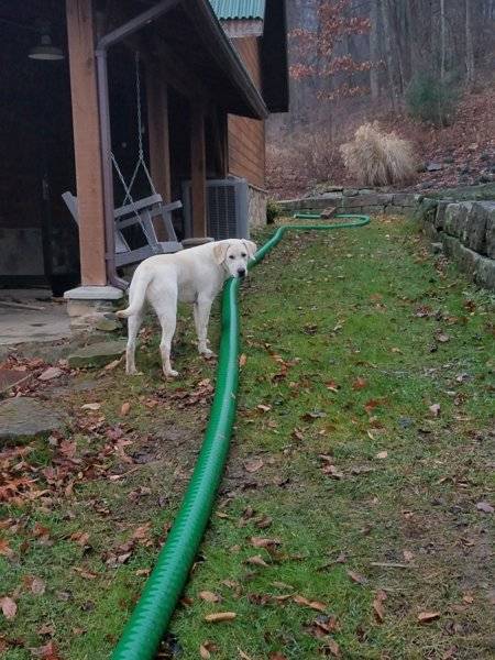

And my helper, more of a pain knocking dirt back in the hole.View attachment 553207
