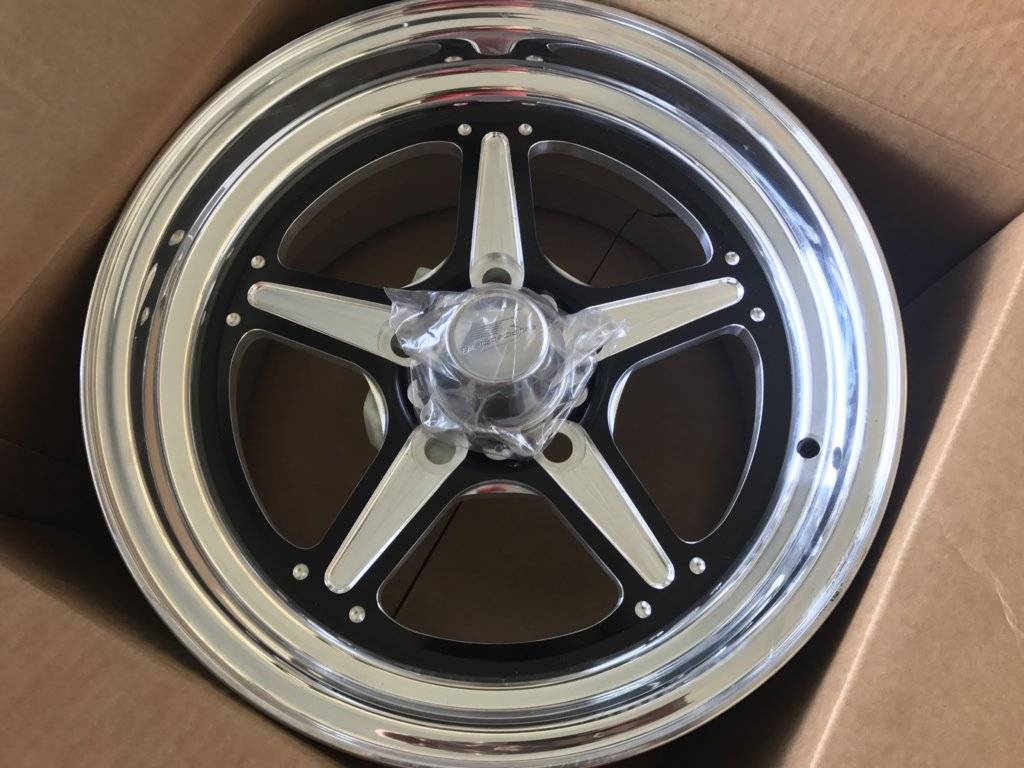

Is there a center cap that goes on the wheel?
Yes there is a cap, Baer has VERY nice kits

Yes it is 1/8 inch and solid black. Like I said I won't be at my shop again until Sunday but I can get pics then. Also on my 17 inch American racing magnum replicas I had to use the spacers for the center caps to clear the cap on the wilwoods hubs.
I will use 15" Torq Thrust II wheels (285/50/15 in the rear and 245/50/15 in the front). Do you think I will need spacers? Anyone has tried Wilwood with these wheels?
You need to call them and ask what’s the caliper clearance on the wheels you want, I tried to look on their site but they have nothing listed other than a measuring guide. I know my wilwood 12.19” rotor and 4 piston caliper needs 7.03” of clearance from center of hub to atop the caliper. My fronts have the 6 piston and they needed more clearance
