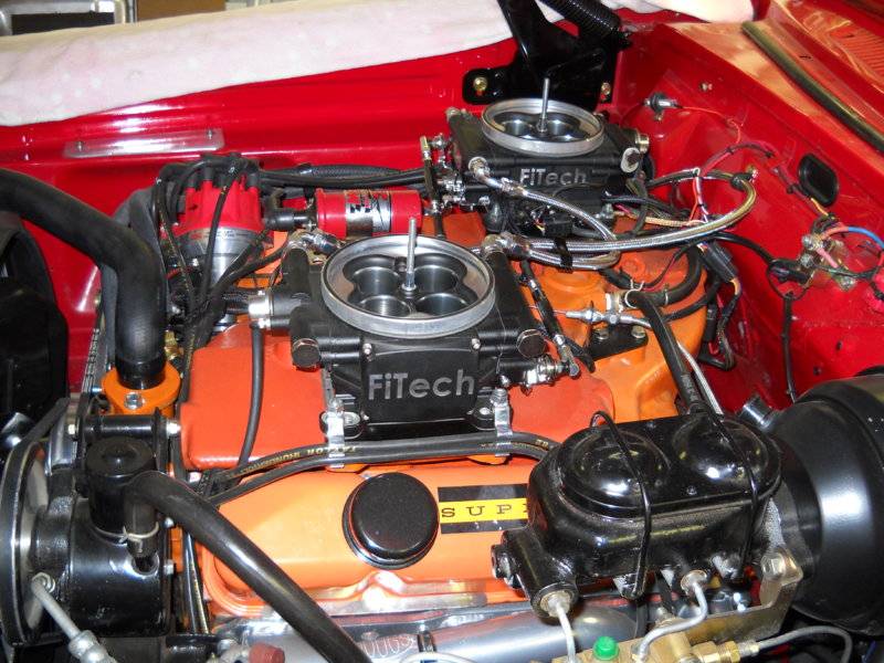

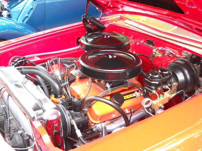

I'm on year two of running a dual FiTech set-up on my big block crossram. I've had 750 CFM Edelbrock carburetors and then 500 CFM Edelbrock carburetors on the engine. Both ran well with constant tweaking on 91 octane fuel. Initially I used the FiTech Fuel Command Center (FCC) because it was cheap and easy, utilizing the mechanical fuel pump to prime the high pressure pump, and only a 'vent' line back to the tank. I can say from experience that the "just shut off" was due to fuel entering the 'vent' line and restricting the venting. I disassembled the FCC and lowered the float level (all Holley parts, BTW) which solved the shutting off problem. I always got a prompt return email from the techs whenever I had a question.
Eventually I had a custom stainless steel tank made with an intank Walbro pump made by Rick's Tanks in El Paso. Since then, I've had zero problems.
It runs smoother, starts faster and provides about the same performance and mileage(????) as the carburetors.
My Go EFI unit runs my fans and the timing/advance of my MSD Pro Billet distributor, all adjusted on a hand-held device that was included and easy to learn, even for a 72 year old.. No need for a laptop.
Yes, I wish FiTech had published a comprehensive owner's manual which would have sped up MY learning curve. I also got on the FiTech forum years ago and continually read sob stories from guys who had massive problems and asked questions that indicated that they hadn't read or followed the installation instructions. I also installed PTFE lined braided hoses so that I can run E85 if I want.
Bottom line? I would buy it again...
