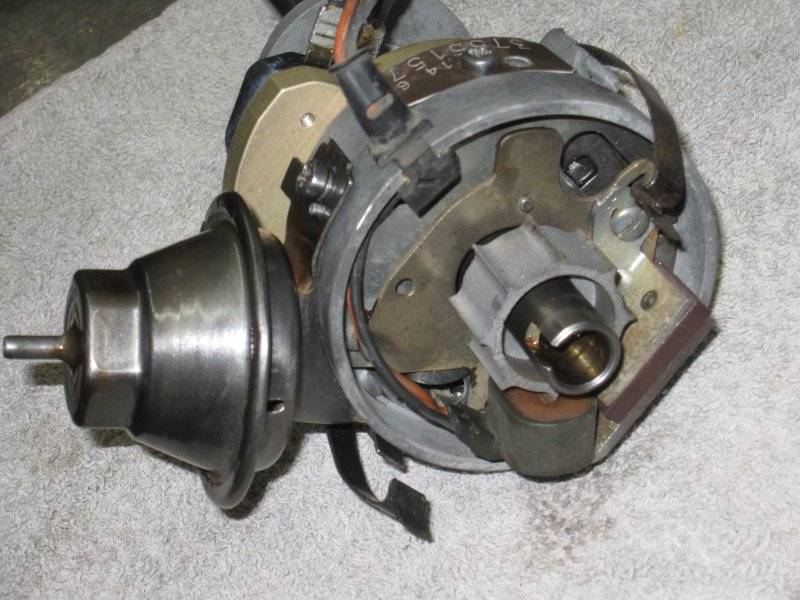

Thanks. Points and condenser are an option as I still have an original dual point distributor and an NOS dual point, both with dead condensers.

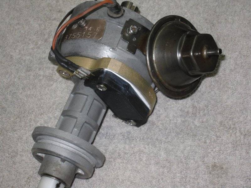

Your original prestolite dual point is a high quality unit.
