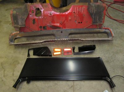

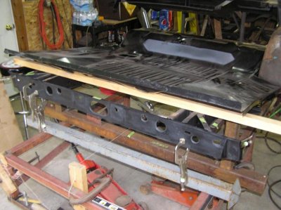

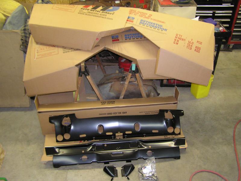

more parts
Hear are a few more parts I bout over the last couple of months.

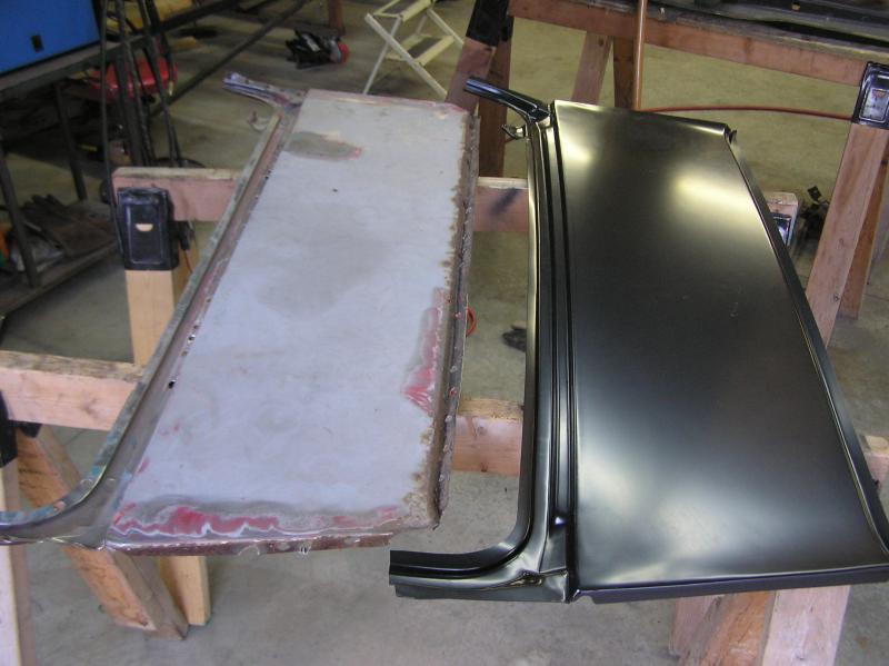

New vs old
I think I'll use the new!:grin:
Ahhh yes, the corners. I remember those...............
You too Barrs..... O GREAT! Something to look forward to!
Looks like some great stuff and even though the new is better by far, ive sure seen worse old ones lol You are on the right track for a road side cruise! That firewall looks just about new and ready, pretty cool parts you grabbed!!
Don I had issues with the deck lid filler panel being too narrow. Compare new vs old widths. AMD was able to compensate me for the descrepancy since they knew the part was off. Look at my thread 4 the fix.
Thanks for the heads up Paul. I will check this!

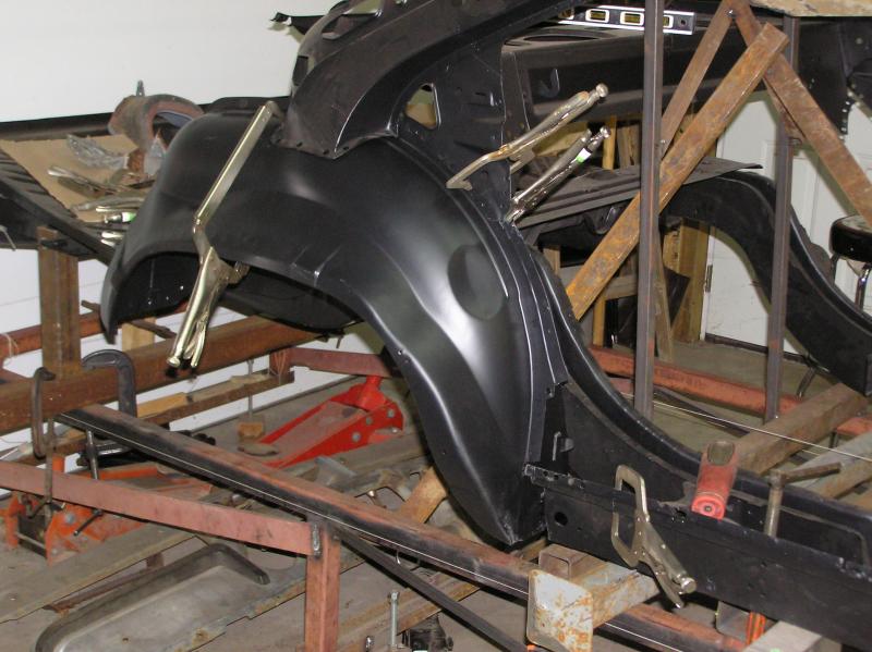

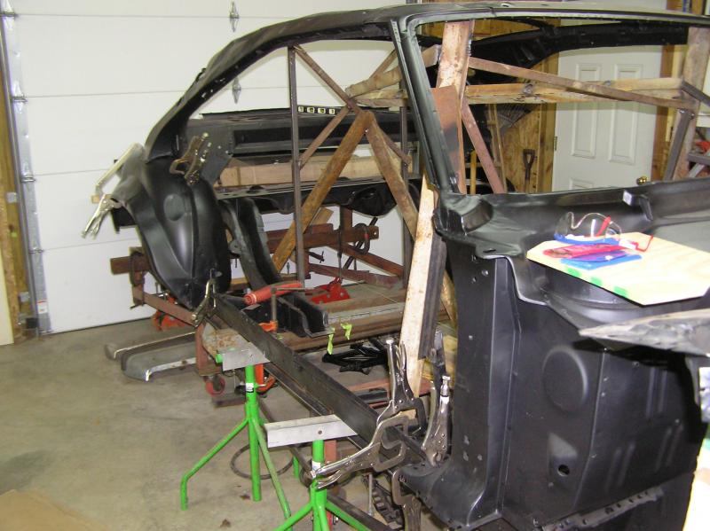

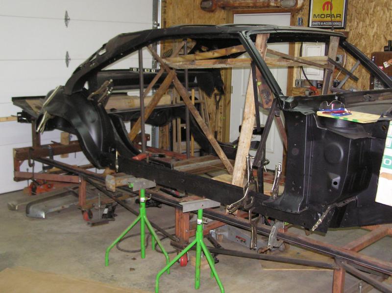

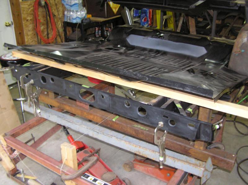

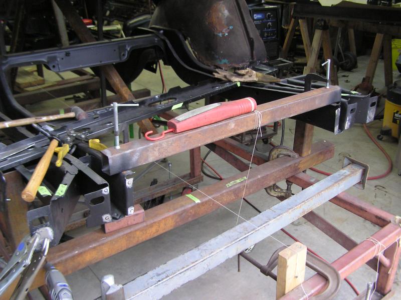

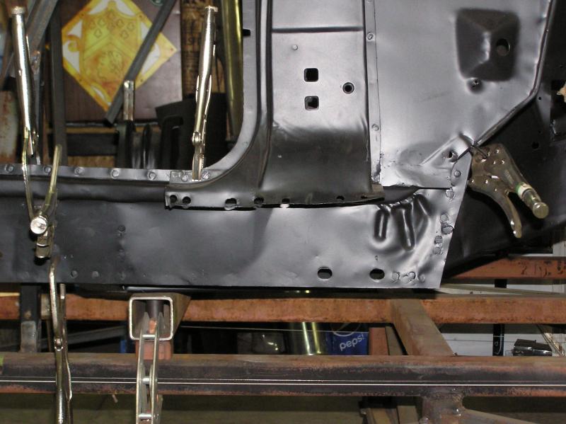

crossmember and wheel house mockups

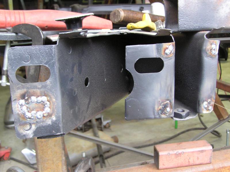

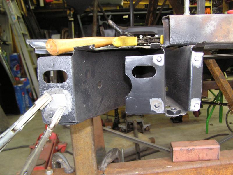

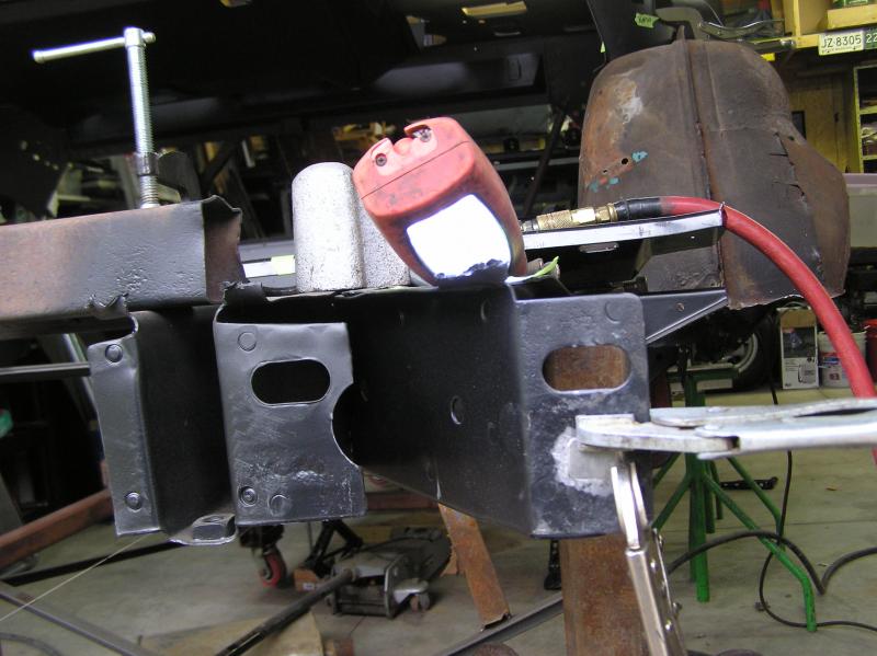

Patched a couple of spots on the rear frame rails
then mocked up the rear crosmember
Also mocked up the wheel houses and inner rocker
Looking really good there Mopar4Don . . . now would be a great time to de-hump the outer-inner wheel well if you'd like to stick a big tire under it ! ! !
Love your work and thanks for the updates ! !
Mine was narrow at the front, I've seen some cut down the side of the bend, open it up and weld the gap shut to close the gap but I just hammered the bend over a bit. Good luck
Mine was too narrow as well. We were able to flatten out the drivers side and rebend the flange in my brake.
--Khan-vertible
Hi Kahn. Your right now is a good time to dehump the wheel wells. I have been thinking about this ever since we spoke, and I think I know how I want to do it so stay tuned (might be a few months)
