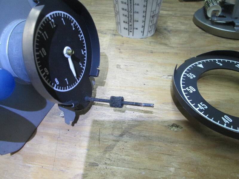

And if anyone knows were to buy that small chrome nut on the end of the time adjust shaft, let me know as I misplaced mine!

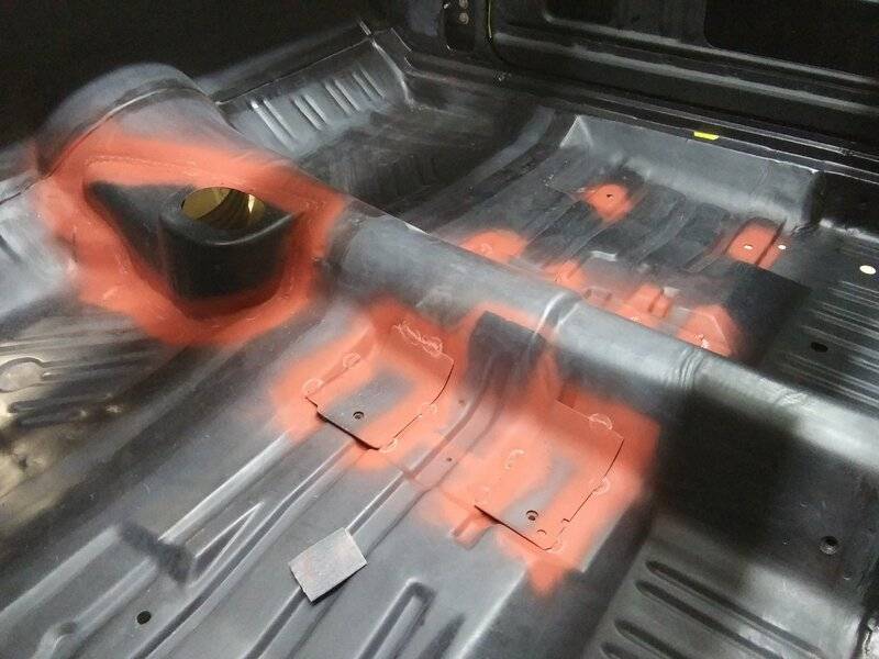

I welded in the 4 speed hump and bucket seat brackets

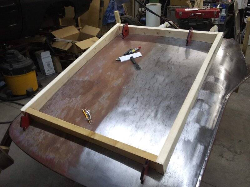

Once I had all of the metal patched I made a wooden form to support the roof when working on the back side

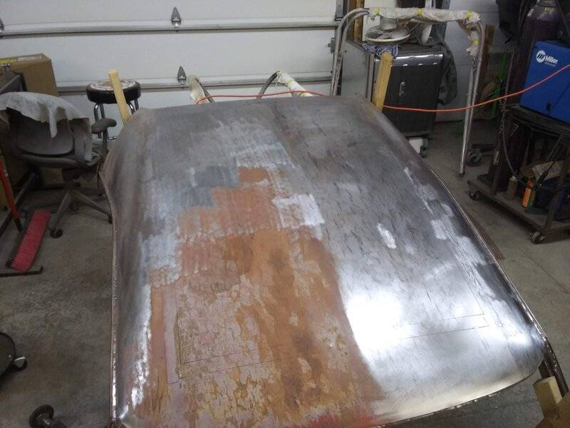

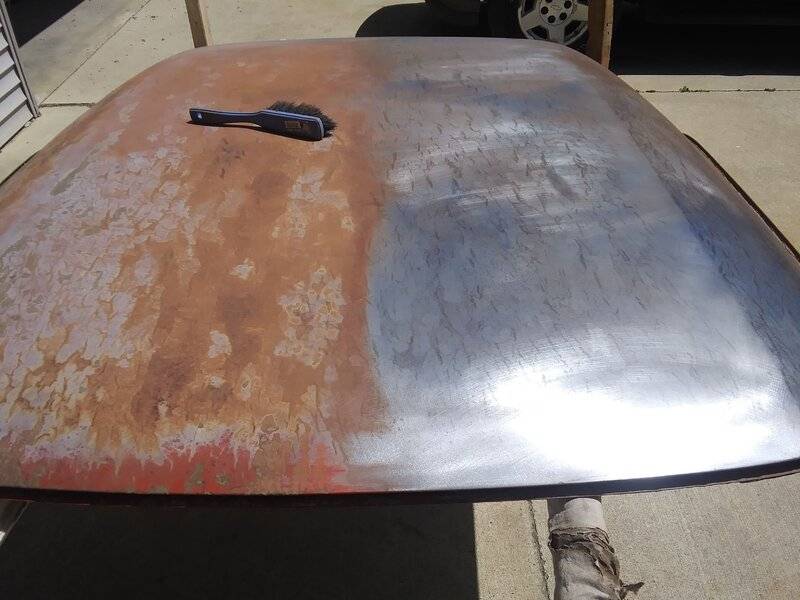

So I finished stripping the top side
And this is what I used to strip

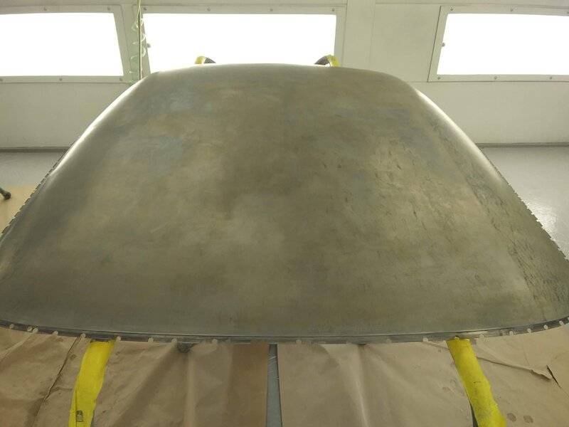

Next I separated the skin from the roof structure. There are a lot of spotwelds in the drip rails and along the front

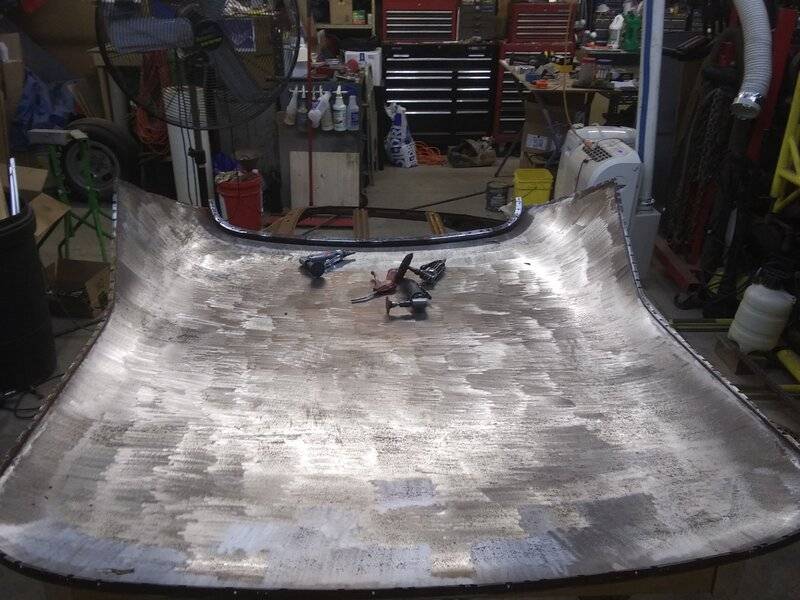

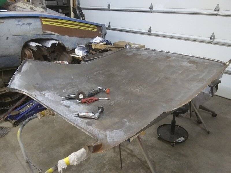

Then I flipped the skin over and started stripping.
Just to review the stripping process.
I did not want to blast because I was afraid of warping.
So I decided to strip it with one of those stripping discs. I was a bit concerned about heat build up which could lead to warping. But I kept it cool by putting my 2 foot shop fan on it and also would air blast it as needed. It turned out good. I used up 3 stripping discs.

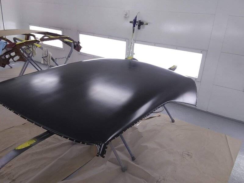

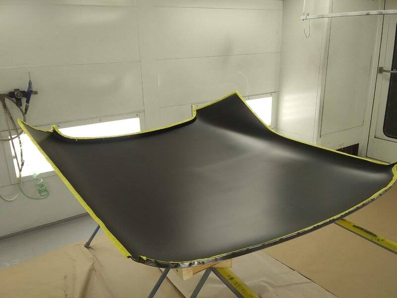

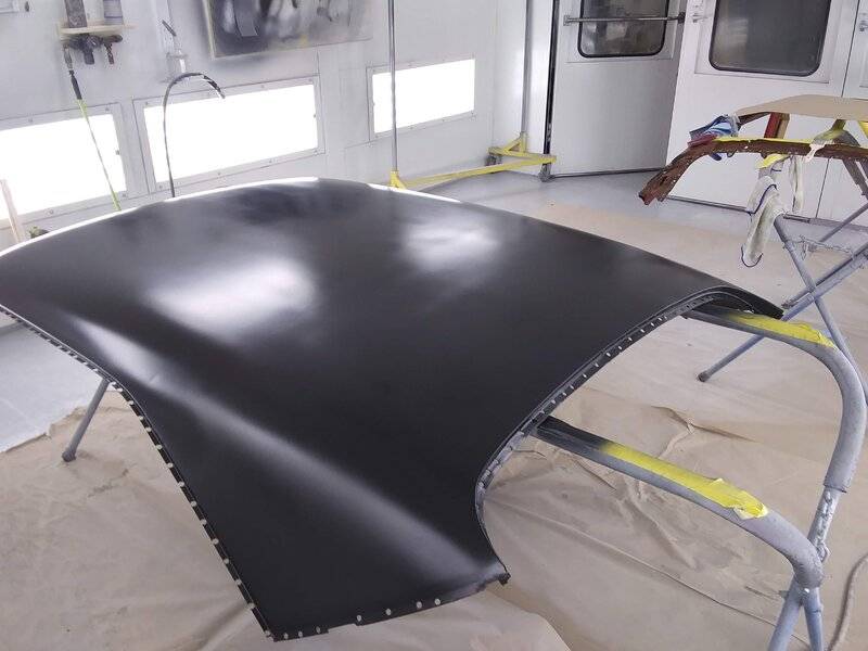

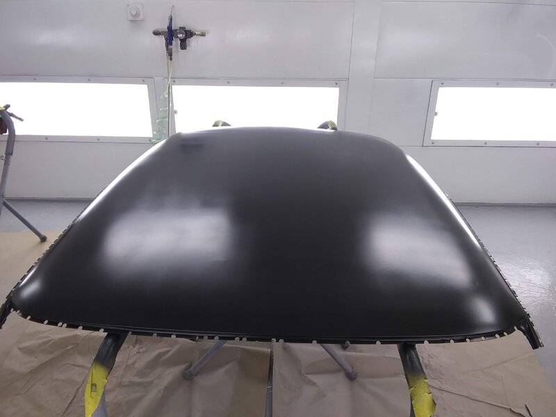

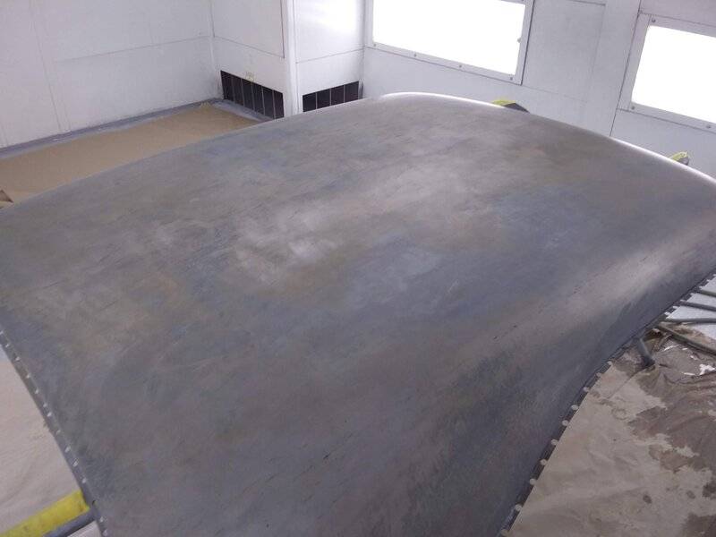

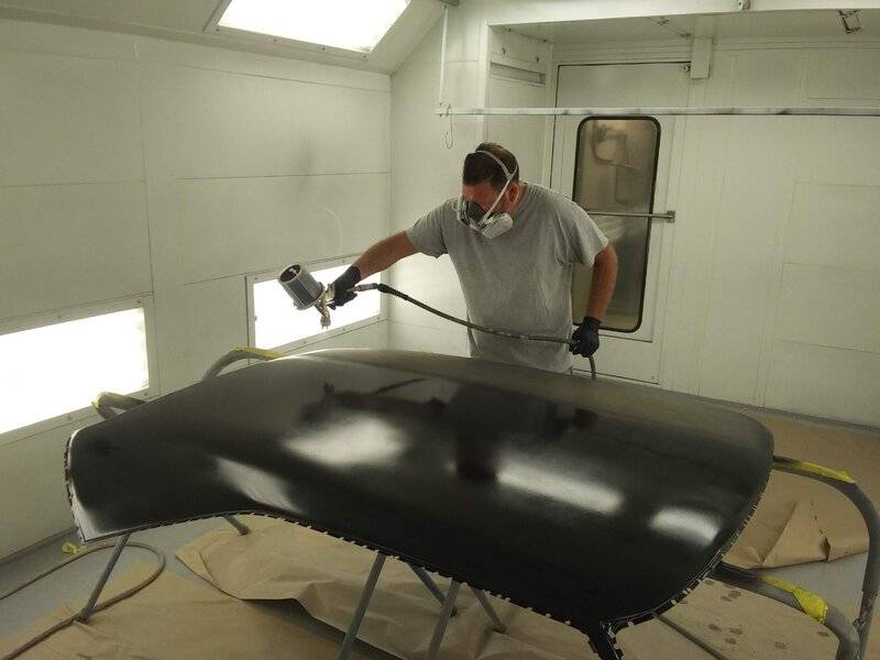

Next I got the roof skin in the booth and rust preped it then sprayed some epoxy

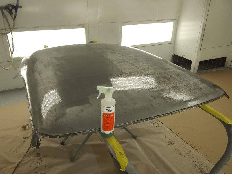

Flipped it over then repeated. Here you can see the Auto Tech rust prep I used
from there web site http://autotechmfg.com/?cat=6
Rust - Prep
Fast Acting Formula Kills Rust & Paint Ready in 20 to 30 Minutes!
A new twist to an old product! This fast acting formula kills rust on contact and converts it to a dry, paintable surface in 20-30 minutes, as opposed to the normal 8 - 12 hours required by other products. Also, this unique formula is actually two products-in-one: it kills/converts rust or, if sprayed on a bare rust-free panel, it etches the surface like a metal prep and creates the perfect surface for paint, primer or filler! Rust-Prep works by reacting with rust to form a chemically inert ceramic-like strontium phosphate film that becomes part of the surface. When primed or coated, adhesion to the surface is increased because the zinc strontium phosphate film is cellular and actually creates a locking effect at the paint interface thus going way beyond ordinary adhesion. And the zinc phosphate film results in superior anti-corrosion and welding conductivity.
directions on how to use: go about half way down the page. http://autotechmfg.com/?page_id=77
Then Ralph sprayed it
A couple of notes: I did use the rust prep on the bottom side, But I did'nt get any pics.
And the roof structure you see in the background worked really well for transporting. Just threw a couple of clamps on and put it in the truck.
Rust - Prep
