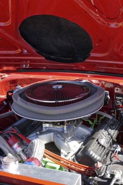

Do you have something like this under your hood?

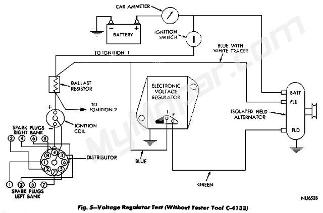

Also on my wiring diagram it shows the blue with white tracer and another blue going to voltage reg and the blue wire and brown wire plugs into the ballast resistor?

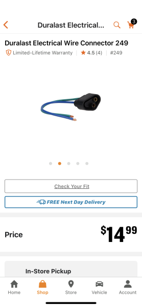

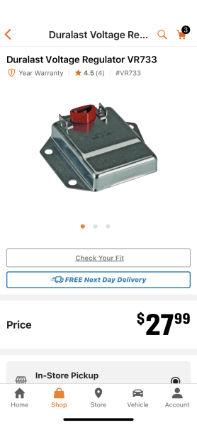

I found these at my local autozone and will go get if this will work. I know it’s probably Chinese bullshit but if it works for now I will still order the MOPAR one. I’m sure I’m frustrating with this forum but I just wanna say everyone who has added anything to this forum I truly appreciate your patience Thanks

The stock early type regulator in the photo of post #20.
When the ignition power is on the green wire from the regulator to alternator should have voltage on it (to energize the alternator field so it makes power when the alternator turns.)
With that setup the other alternator field connection needs to be grounded.
Thanks, ok I’m just gonna ground the other field but I’m gonna make sure that it’s not energized when she’s runnin. Before I install the new 70’s voltage reg and pigtail I just bought

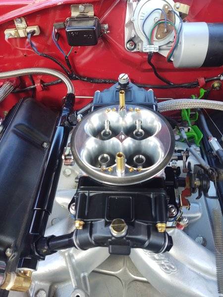

Do you have a pic of your firewall we’re your ballast n regulator is?
I just wanna know my wiring to the ballast and regulator is correct because at first the blue & blue/white tracer plug was on my ballast and the brown & blue wire was on the regulator. My wiring diagram said that was wrong and it should be the other way around so that’s what I did. I haven’t fired it up yet because I’m afraid of burning up the new harness and bulkhead and new dash harness
I certainly do
but know the regulator is electronic but looks OEM
and the Ballast resistor had the resistor removed and was straight wired with a piece of 6 gauge wire
I was interested in keeping the stock look at the time I did all of this but now I am way beyond stock
I certainly do
Thanks I straight wired my ballast also for my sniper system. I’m installing electronic regulator and pigtail tomorrow along with a new battery. Will post tomorrow with my results. Thanks again for the pic it reassured me that switching them wires was the right thing to do.
