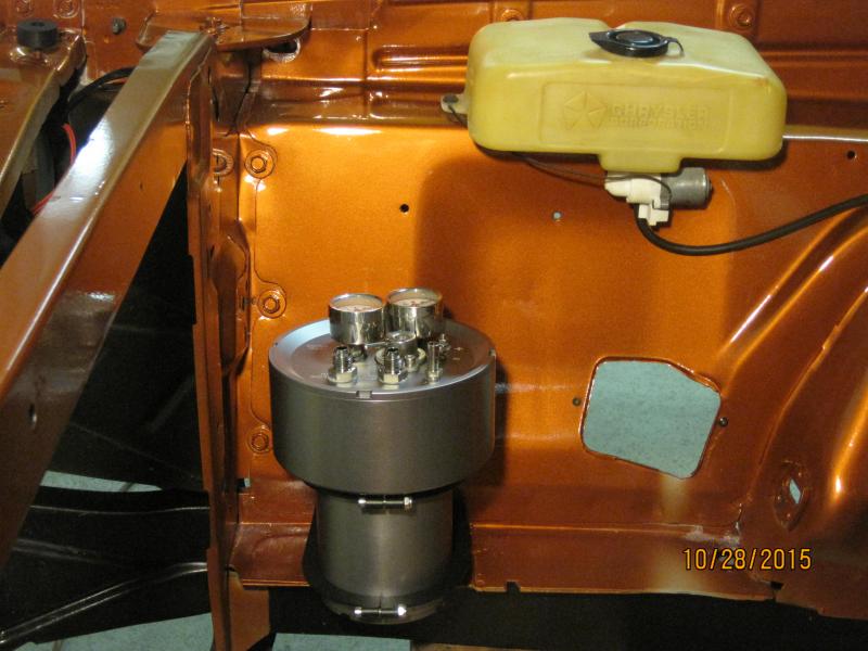

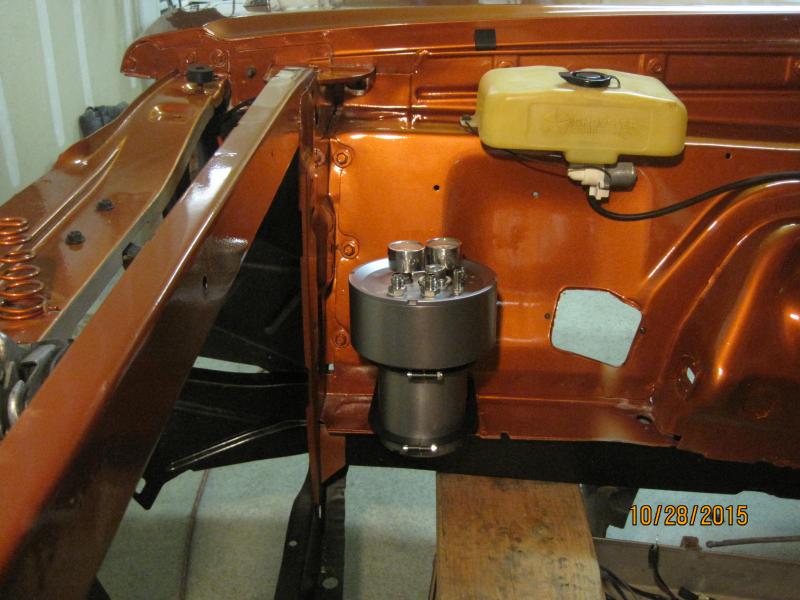

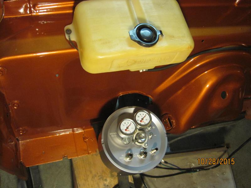

FCC just delivered
Came from work today to find a present at the front door. The FCC from FiTech arrived. It's a good looking unit and not nearly as tall as I had imagined. The kit comes with two brackets, 5' of FI hose, fittings and hardware. Sweet!
Originally I figured that the horns and horn relay would have to be moved, and I still may relo them to the other side of the rad support. This is just a mock up, I'm still a long ways from installing the unit. Once the engine along with the AC is installed I'll have a better understanding of exactly where to mount this.
Looks really nice, and not as big and clunky as I imagined it!
I agree you should get some of the major components installed and then figure out the best place for it. With a slight offset, might it even be able to fit UNDER thee stock battery location? Just brain-storming...
