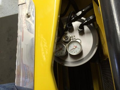

I agree you should get some of the major components installed and then figure out the best place for it. With a slight offset, might it even be able to fit UNDER thee stock battery location? Just brain-storming...
I was positioning it in a number of different places last night. There's a small pedestal between the head light buckets and rad support that could work. It even fits inside the front wheel well for the ultimate disguise, but I think there would be too much road debris on a daily driver to make it practical. I like your idea of under the battery tray.

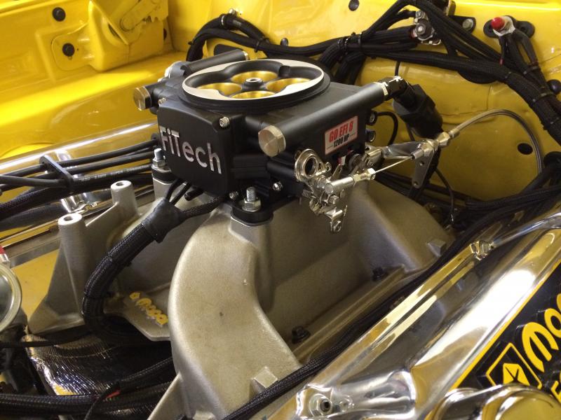

I spoke with them last week about their 8 injector version. On paper, I'm sold and will be ordering next week. I will be putting it on a dyno by the end of the year so we'll see how it does.

Well, I'm pretty excited... Opening this stuff is like Christmas!
Man, if it runs as good as it looks ! You gotta be gettin antsy.

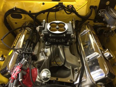

Making some progress

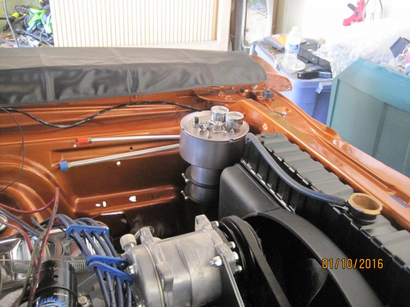

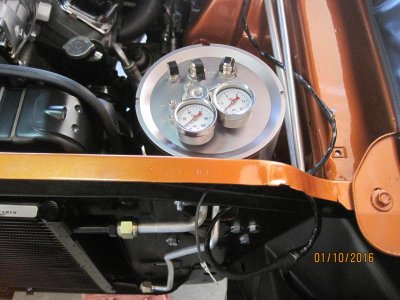

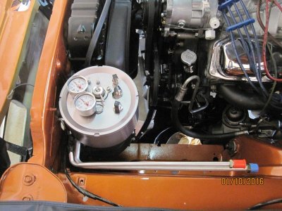

Finally got my engine back before Christmas. The drive train is installed and even though the initial fire-up and break in will be done with the carb, the FCC was installed this weekend. Originally I planned on mounting it on the passenger side to shorten the fuel line routing, but once the radiator was in I ran out of real estate. Someone with fab skills can probably craft a mounting bracket to mount on the inner fender. Instead I mounted the FCC to the driver's side radiator support. The downside is that the battery has to go; so it's off to the trunk with it. And by stroke of luck the Classic Air Perfect Fit a/c hard lines wind right around the unit.

Specific to FiTech, I returned the FAST system and switched for a number of reasons: didn't have to monkey with my fuel delivery, it's returnless (still need to vent), fewer wiring hassles, and it's 1/2 the cost (when you figure in the Phantom Stealth in-tank fuel pump I returned as well). And FAST doesn't play well with my brand new Pertronix distributor. That said there's quite a debate about storing a gallon of gas in the engine compartment. After installing the FCC, I'm a little ambivalent. On one hand it's a cool looking unit with the brushed aluminum and gauges on top, but it takes up a lot of real estate. in the end, once I hook the system up and it works like it should, I'll probably wind up loving it.

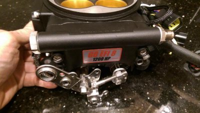

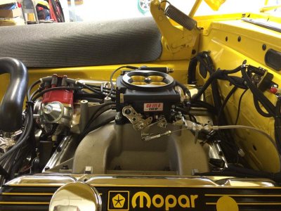

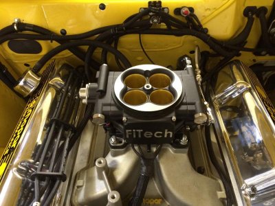

IMG_1505.jpgIMG_1506.jpgIMG_1530.jpgIMG_1533.jpgIMG_1534.jpgIll send video and pics of my 1200 setup. Its a night and day difference from the carb..
And there service is on top of it. No issues with install at all.
