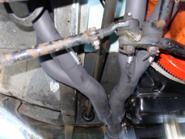

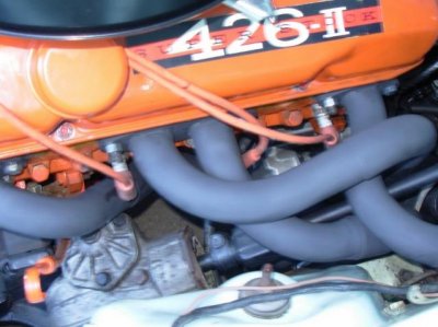

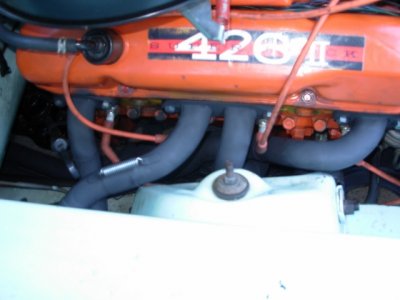

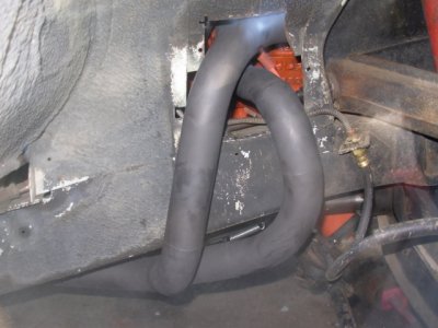

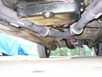

I just tested the new headers I built on my 64 Dodge street car. The car only ran 14.0 at 93 mph. I was pissed, I hate headers on my street cars. but I wasnt gonna live with having a 14.0 car. It had 440 magnum manifolds with 2 1/4" exhaust and flowmaster mufflers. I built stainless steel 1 5/8" - 1 3/4" to 2" Tri Ys and a 2 1/2" exhaust system with X pipe. The engine is a stock 73' 440 with 516 heads and an A&A cross ram with two 500 edelbrock carbs on it. I took it back to the track last night, I was shocked at the difference, it ran the best of 13.29 at 101 mph and it was spinning the tire. I have a set of the Hurst Cheater slicks on it, there just not good enough on a bad track, its was street night. Im porting a set of 452 heads right now to put on, my goal was to get it into the 12s as a street car.

Nice job on the Tri-Y headers... But why did you have to go thru the side panels? Just curious..
The hole was already there actually, I didnt cut it. I couldnt get the right lengths on the passanger side going on the inside of the frame rail. I also dont like to use tight radius bends, actually I wont use tight radius bends. The driver side is all inside. The headers are actually perfect lenghts, Tri Ys on one of these cars is very hard to do, and make a nice header. I wanted these to be perfect as I have future plans of making this car a NHRA Stocker, probably a 426" street wedge. I designed the headers for 450 - 500 hp, which is what a good 426" street wedge Stocker engine should make. Comicly this job was one of those I thought id never finish jobs, and it was my own car.
