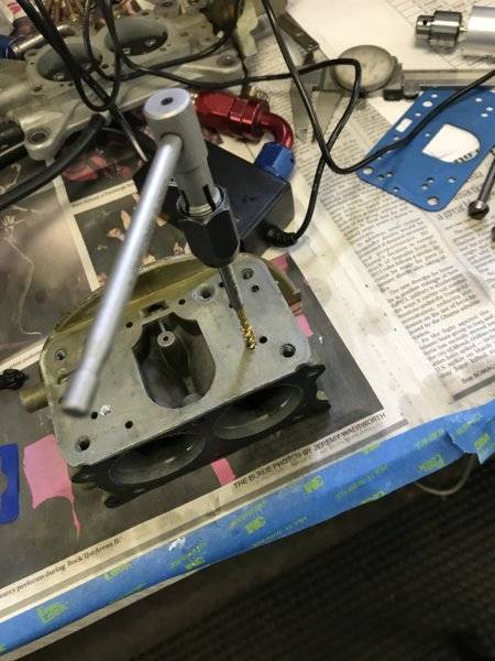

Depending on how far you want to dig into this thing it can be very dialed. Your gonna need some 10-32 set screws and a 10-32 tap along with a numbered drill set. If it’s non adjustable and you really wanna tune it add 6-32 and 8-32 set screws to the list along with respective taps. Holley carbs are Infinitely tunable if you have the tools and knowledge to manipulate them. Does it have adjustable bleeds or is everything set?

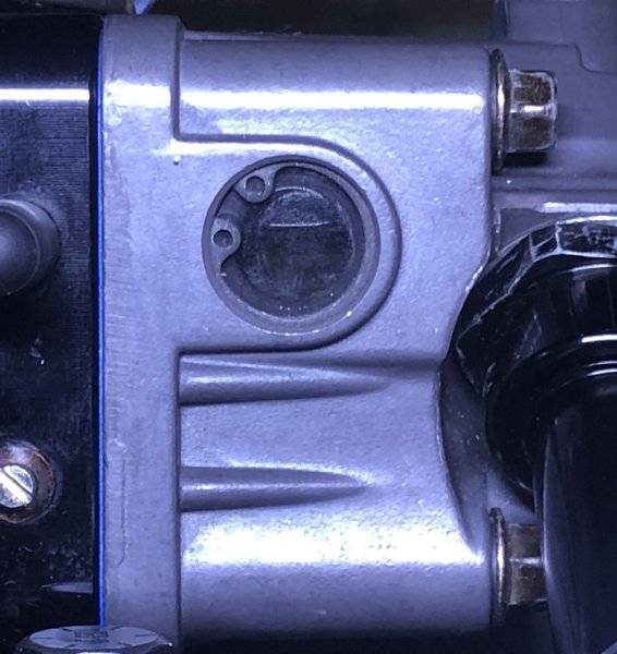

Reporting back on the float level change.
Bumped it up to the level in the picture. It is helping with the lean out on acceleration but I can tell that all it is really doing is richening up everything. So now my cruise is rich again. I’ll be cruising at 11af and when I give it accelerator I can see the gauge start to rise up to about 14 and then it falls back to 11 when I stop applying pedal.
I’m not certain that raising the float is actually what I want as it seems like the float level is just masking the problem. I feel like I should be able to set my jets from proper cruising af and also have enough fuel when I need it for acceleration.
It doesn’t have adjustable air bleeds nor adjustable PVCRs. I am prepared to actually drill out the holes a tad to get more flow in there. Never thought about tapping them.
I just watched a video on the transfer slot. Looks like the only adjustment there is for that is my curb idle screw. From what I can tell, If I lower that screw down so as to reduce the transfer slot opening then I might have to drill holes in the butterflies to allow more air in and transfer some of the idle work back onto the idle mixture screws?
That’s where the 10-32 set screws come into play. You add a restriction to the transfer slot feed and it will lean your cruise. You need more initial timing also than 12 degrees.
