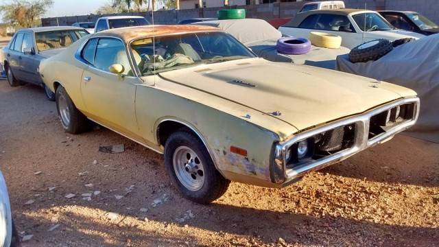

This is the car when I found it. It was sitting in a mans yard for 10 years. It really is a hooptie, just an expensive hooptie after brakes, suspension, and steering rebuilds. Later today I will get a pic of it now. I have had it to 130 MPH on the open road believe it or not.

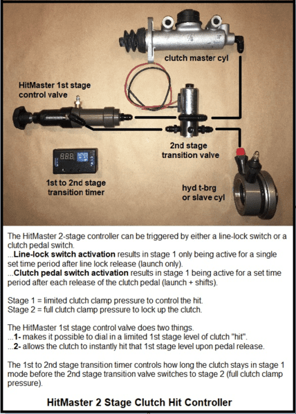

With the 505 stroker, you should really look at a serious clutch disc and pressure plate and the Clutch Tamer or if Hydraulic clutch, the HitMaster, and consider that in the clutch package you buy.
My street/strip disc and 2,900 pound pressure plate are great for what I've been doing, but I don't know if they will be up to the task w/the HitMaster.

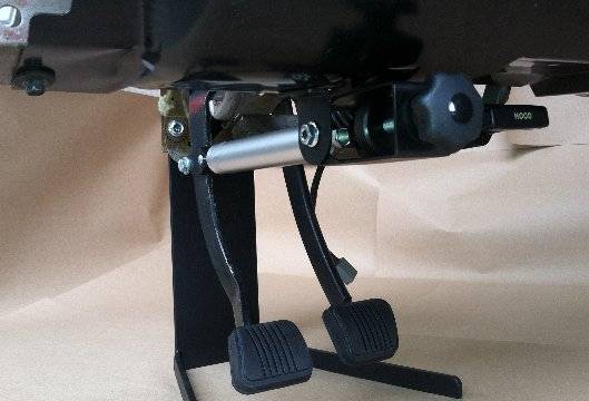

Does the unit with the hydraulic cylinder only work with a hydraulic clutch?
Grrrr!! :BangHead: lol...
Have you looked at the linked pages?!
ClutchTamer: no hydraulic throwout bearing required!
Description:
What is the ClutchTamer ?...
...A small hydraulic cylinder that takes much of the inconsistent human element out of precisely controlling your car's clutch pedal. It's adjustable for exactly where in the clutch pedal's travel that it becomes active, and adjustable for rate of release from that point on. The cylinder has characteristics similar to those of a 90/10 shock, pulling it's rod out is easy, only the return stroke of the cylinder is controlled. Because the ClutchTamer attaches to the clutch pedal itself, it works equally well on both hydraulic and mechanical clutch release systems/linkage.
With our ClutchTamer installed, only the final part of clutch pedal's release is slowed down, not the whole release cycle, while the rest of the clutch pedal's travel works like normal. If you are using the clutch pedal during shifts, the slipper will soften drivetrain shock during the gear changes as well. Casual driving is NOT affected, no need to dis-connect the ClutchTamer for daily driving.
The Clutch Tamer slip controller allows you to choose a clutch with more capacity than you would normally choose. Typically that clutch would be too aggressive, but the addition of the first stage of the slip control provides the ability to apply only partial pressure initially, allowing slip. The second stage allows additional pressure to come in over time to insure lockup farther down the track
HitMaster: Hydraulic throwout bearing REQUIRED!
It gets confusing. I have 2 cars right now. The '73 I am working on in this thread is a big block 4 speed car. My other car is '72 a small block automatic car, that one is getting the 505.
The Hitmaster looks like it is something to consider in the future. Thanks for bringing it out.
