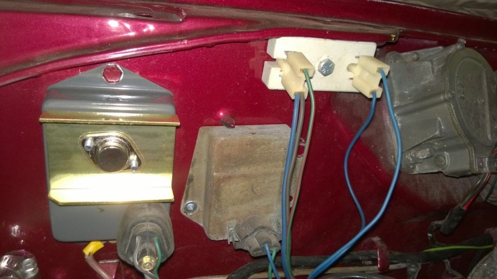

Here's something else I want you all to look at for me please. This thing came already installed with Mopar electronic ignition, with a "double decker" ballast resistor as shown in this pic. I always wondered why, especially with what seems to me to be extra wires?
Yes, the voltage regulator looks like hell. Been meaning to replace it.
Do you all see anything odd here?

that's the mid 70s ignition setup. The first Chrysler electronic ignition had a two prong ballast. As long as you are getting enough voltage at the coil then it doesn't matter. 9-10v is good. Have you checked voltages in the ignition?

I'll check voltage at the coil, good idea. I'd swear this problem is electrical, but what the heck do I know.

I'm going to swap out the plugs, replace that ratty voltage regulator (even though I get the sneaking suspicion it works fine) and see if I have proper voltage at the + of the new MSD coil.
I'm checking that when the car is running, right?
