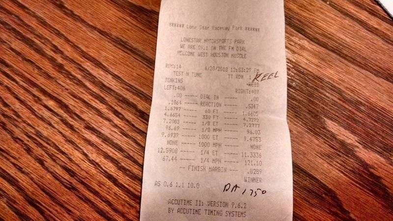

Drove 80 miles round-trip,ac blowin cold, overdrive engaged,,11.33@121, full exhaust, just drop the air pressure down to 20 psi and make a pass. DA was 1750 ,4100 lb pig.
