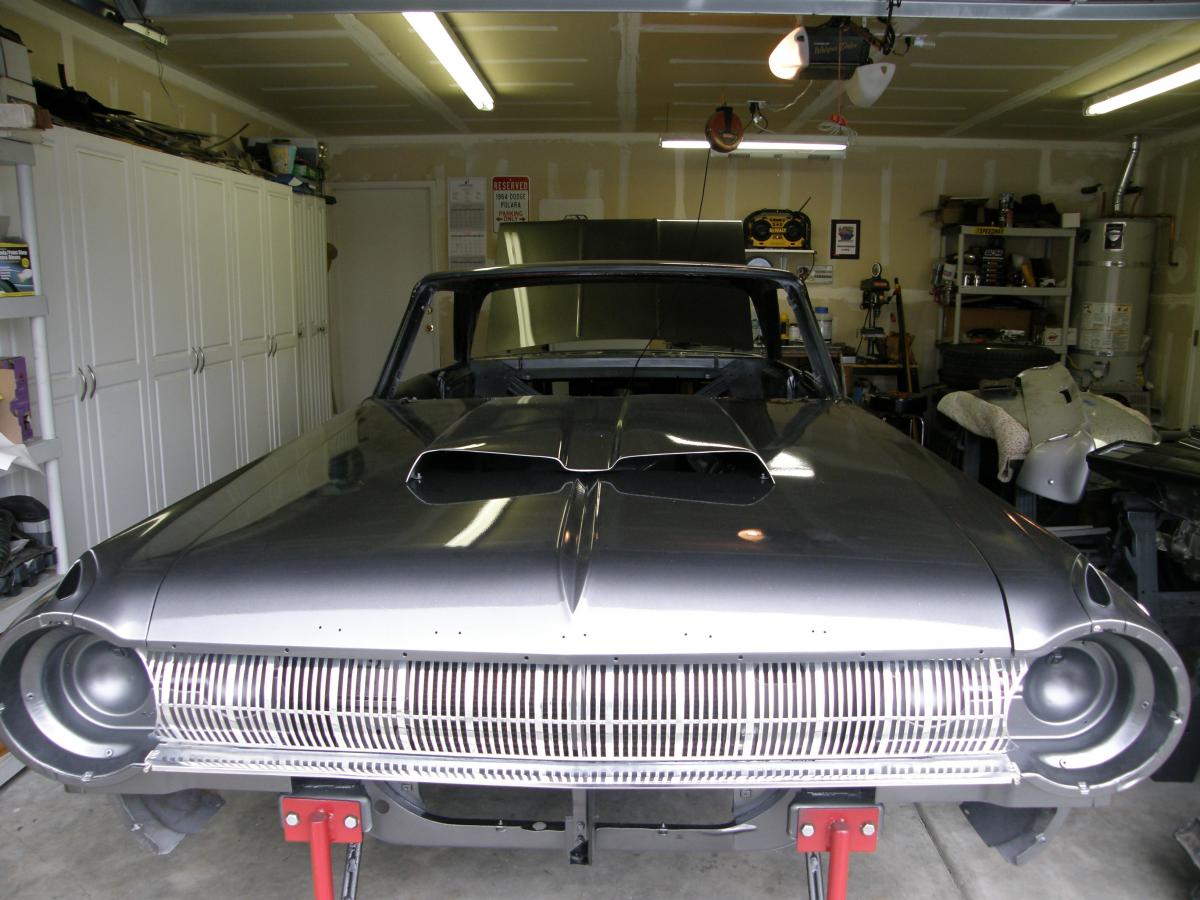

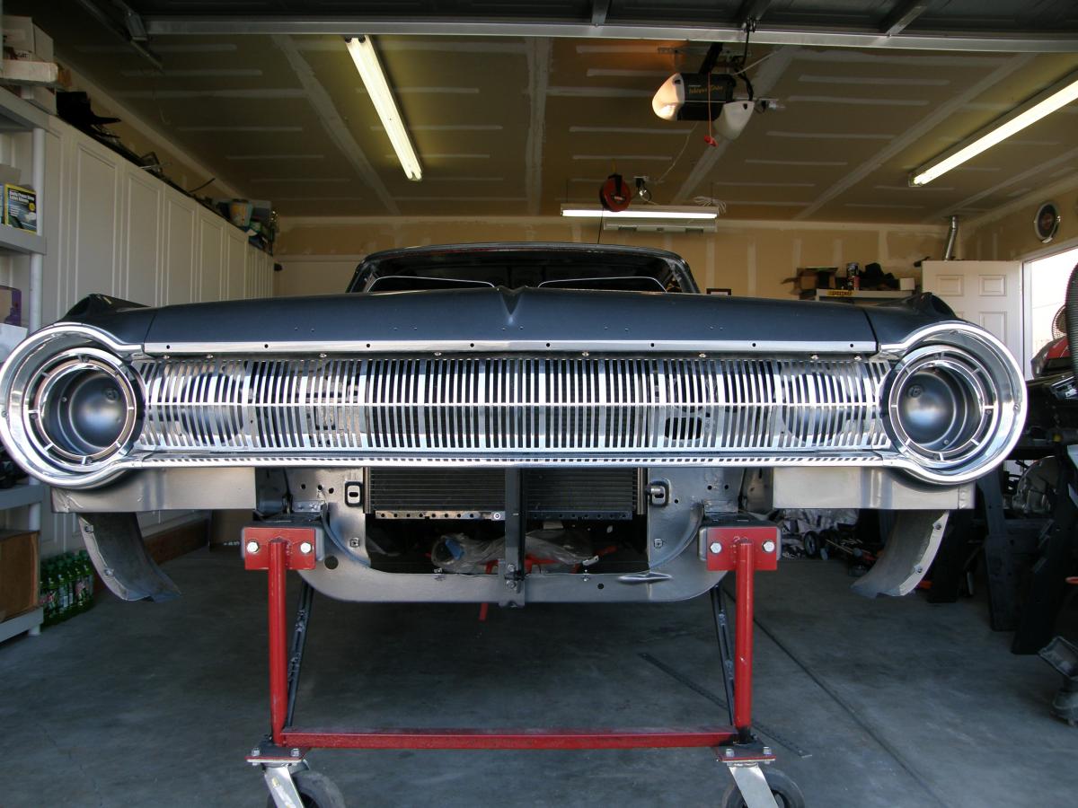

Can you say superstock??

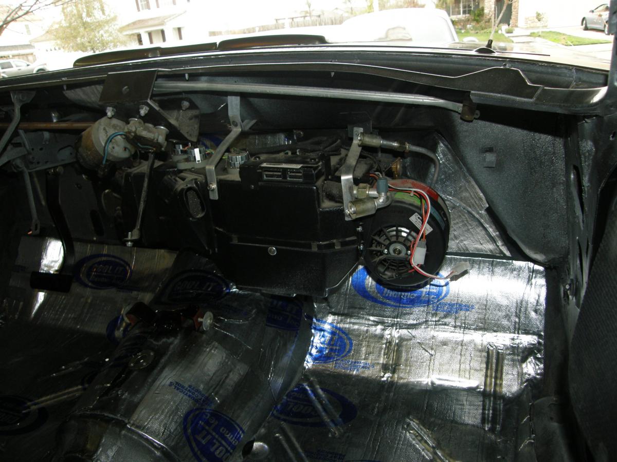

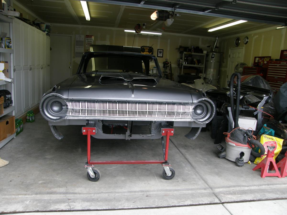

Heres the wiper motor, vintage air, and my best attempt of a superstock grille.

5.7 that grille looks great. Makes me want to do mine. Did you cover what you did here in this thread somewhere?
Hitit, there is some pics of what I did for the grille way back on this thread, but none showing the actual welding, cutting or fitting. Most pics are of it as I started and cut then tape pieces together then fit to the car. Check it out, maybe there is something that I don't remember right now. But I do remember this, polishing was a pain in the ***.

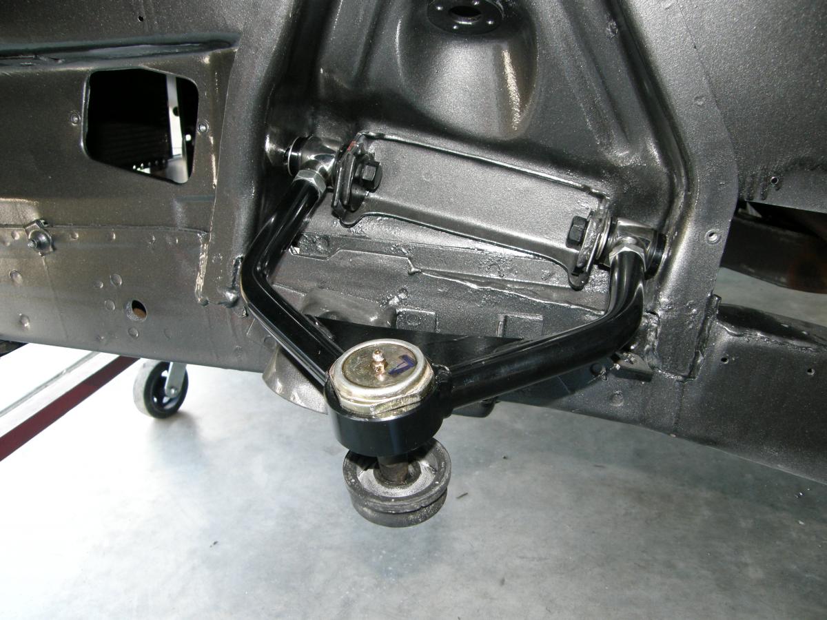

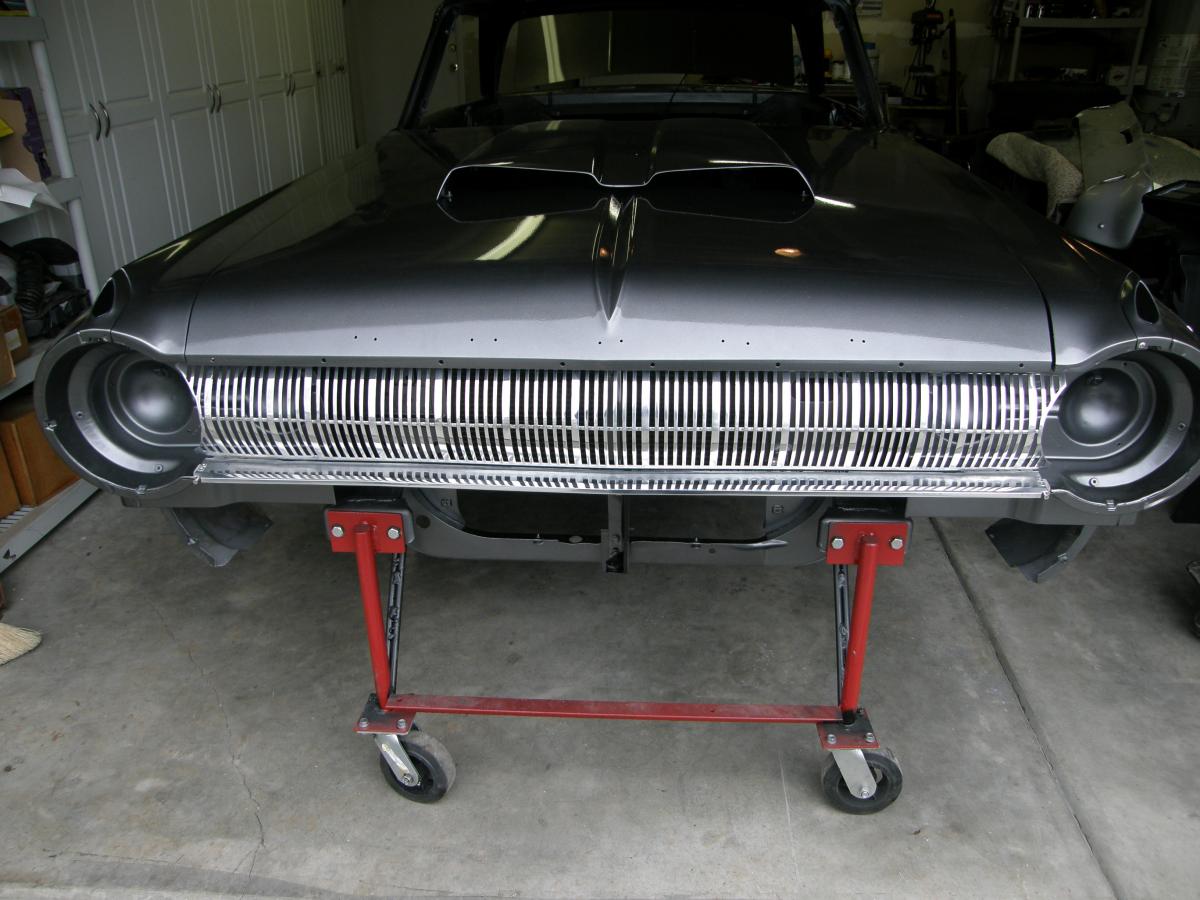

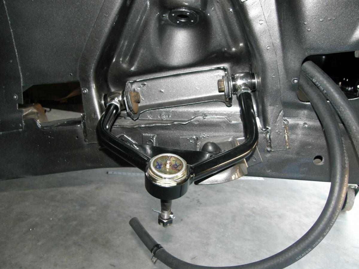

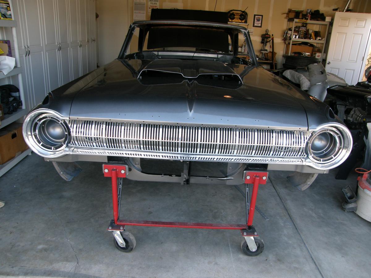

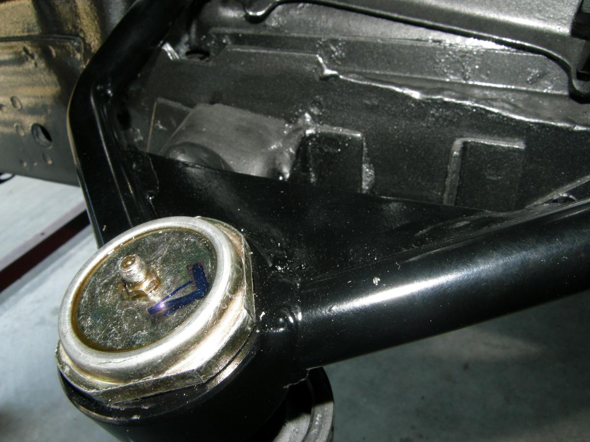

Here is some pics of the completed grille for that superstock look and the Cap upper control arms that were modified for strength cause I have heard od too many problems with welds breaking, enjoy!!

Hey Zack, are you planning on wetsanding and buffing your paint?
He only buffed the hood and trunk lid. He for got the roof so I'll do it. No wet sanding a single stage metallic, or at least that's what I have read, heard, and been told. The roof doesn't look bad at all, but you can feel the difference between the above mentioned panels.
yeah with a single stage metallic you can sand away the metallic and ruin the paint job. as with a clearcoat becomes a barrier over metallic for better uv protection. and would give it more depth and could wet sand flat and buff to a glass finish
i like your progress. tin whats happenin' with you?
I went with the single stage acrylic enamel cause it most closely resembles the the factory paint done way back then, plus, my budget did not allow for the really good stuff that I wanted, so I can live with this. I figure a few coats of wax will protect it, and it wont be driven (on purpose) in bad weather, also parked in the garage with a car cover.
thats cool there's nothing wrong with the paint job you got. i think it looks great you can ask your painter but hold off on the car cover for at least 90 days. this gives your paint a chance to cure and let all the solvents evaporate out of it keep up the great progress
