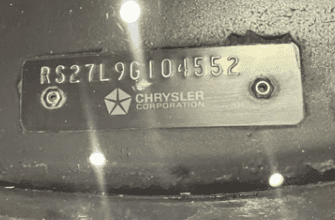

This is why:
Screenshot 2025-01-27 at 11-51-10 Legal issue with VIN on a B-J car today For B Bodies Only Cl...png
The number is stamped off center on the VIN tag. That, and the "hidden" body number on the core support is stamped "9G304552" instead of "9G104552."

3. The VIN tag had the number stamped off center These mistakes/mistamps sometimes happen on the production line especially back in the 60's
4. The core support had one digit mis-stamped but it appeared to be an original factory stamping See above

My opinion is that while there is cause for suspicion due to the multiple issues, I would have to see more evidence to believe that any fraud has been committed. I think the car is probably genuine and is the victim of sloppy attention at the factory upon assembly, sloppy treatment by it's early ownership, sloppy restoration by whomever cleaned it up, and sloppy detective work by whomever cut the VIN tag off of it.
But now that the car is in the position that it's in, the entire situation needs to be brought to light. Pictures of the engine and transmission stampings, the trunk numbers, as much prior ownership history as possible, etc. so that if the thing does prove to be legitimate, that its value isn't forever tarnished by an overzealous inspector at an auction site.
