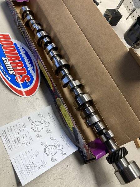

Are you going to run a Mellonized oil/dist drive gear rather than a bronze one?
Those specs are real real close to what’s in my 505. I installed mine at 108.
110 C/L installed height is what the card spec’d. V/P clearance was too close for my comfort though.what was the installed C/L of your cam straight up? Did you install for more low end?
No I lowered it.So in theory you move the powerband UP in the RPM range a bit, correct?

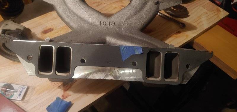

Also getting started on port-matching my Indy intake to the heads. Will be cleaning up the plenum as well, more pics to come as this job unfolds.

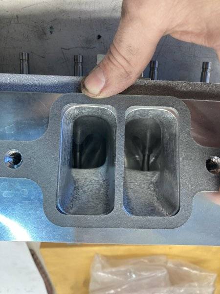

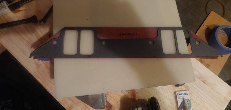

Below is a look at the 270 port against what is a max-wedge gasket. I can only assume that the gasket is pretty close to an actual MW port. So the 270 is slightly shorter, but with todays technology, I bet it outflows a factory MW port by a ways.
Superformance gasket and regular Max wedge comparsionGet some Superformance gaskets, max wedge, they are accurate size & the best gaskets ever, Hughes sells them , you will thank me later![]()
