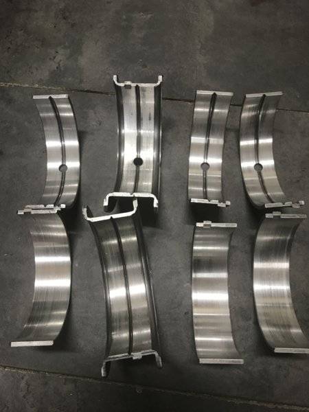

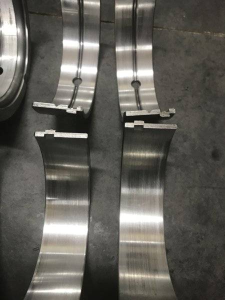

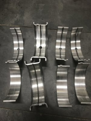

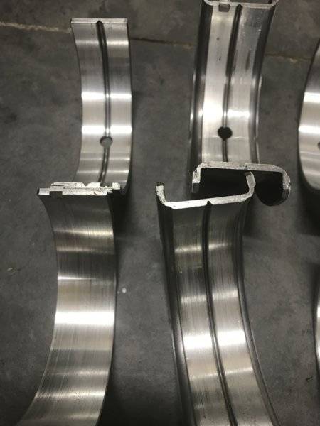

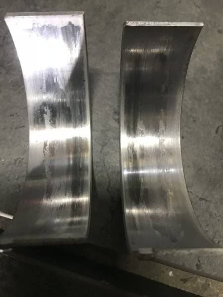

Well the results are in.... and so are the new bearings... decided to not do the rear main bearing since these all looked like this.

The oil goes through the mains to the rods. Did you check the rod bearings?

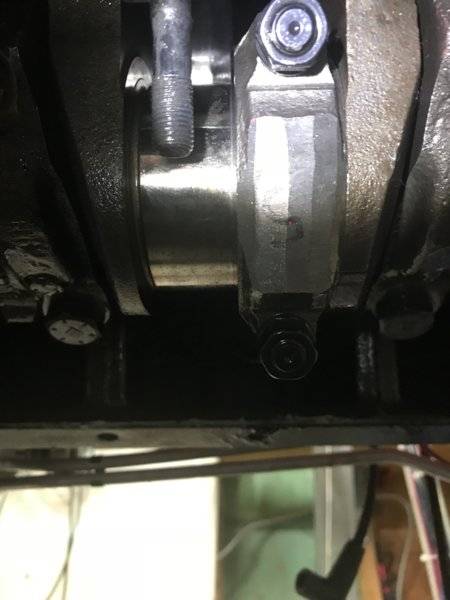

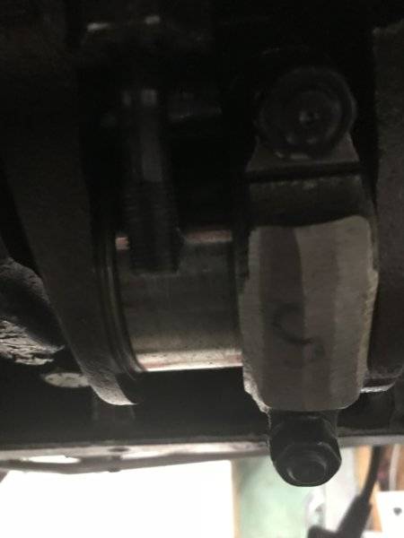

Those are next on the agenda.. I have to do this in spurts since its still on the stand.. Hurts the old neck to stay down that long.. But im going to get them checked out tomorrow.
Well not so good news on the rod bearings. Only pulled one cap but it pretty much tells the story.. Looks like its coming off the run stand and going to to have to check it all out. But the crank looks like it survived pretty well. Since i'm pulling the engine off the stand I will be replacing the rear main as well. Just didn't want to mess with the seal and lose my perfect non leaking rear main..

damn sorry for your troubles but it 's all part of the build. not like we like doing things twice but sometimes it happens. make sure rods and crank check out before install.
