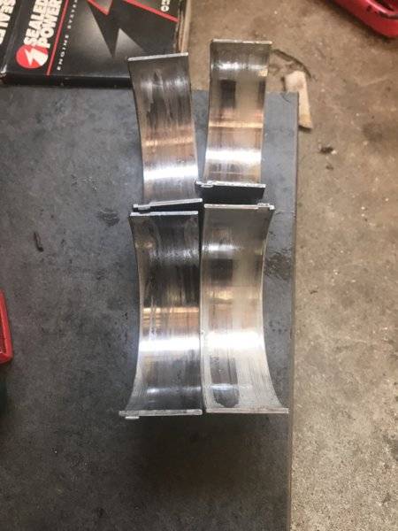

That first set of rod bearings was number 6 the second set which was number 5 was in the same shape. Since this is the rod journal closest to the number 4 cam bearing. I assume the others that are further away will be worse. I hope not but thats just my thoughts.
yep your thought is correct and of bearings are bearing and without lube you get heat friction and all the rest of the bad things. i hate to say this but you already know what i am going to say and that is complete tear down. yes it sucks but tear down is enough not two or three times. really what choice do you have need to know.
Yea, I have already resorted to the fact that it has to be taken apart. Funny enough I was already looking at crank prices.. Good god forged cranks are expensive.. Lets just hope its not damage beyond the bearings..
Yeah they are! For the short amount of time run, fingers crossed. Mostly look for any bluing, would mean temper taken out from heat. Slightly scored? Those bearings are sacrifice, compared with the crank journals, hopefully okay. Maybe some clean up on all the crank journals, new bearings, and good to go, unless bad enough it needs to be ground.
Some agree, some don't, oil flow is good, but oil pressure is as much, if not more important. Not enough pressure...you have the results in your hands. Oil pressure 'forces' the parts to separate, the oil keeping the parts apart. Guessing you did pre-oil. Should be done minutes before firing off.
Done rattling off. Good luck with it! Can happen to the best of us.

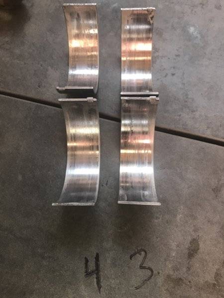

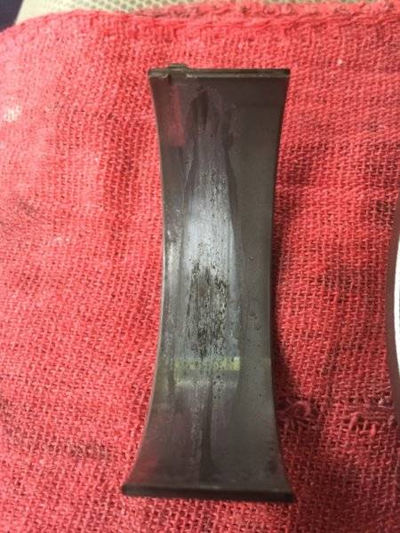

I just replaced the bearings in a friend's 7.80 dragster. The oil filter line came out of the AN fitting. Turns out the builder used a PTFE fitting with stardard line. Ths happened at 330ft on an 1/8 mile track. Since the motor was behind him he never noticed. Made the full run and drove back to the pits before someone told him it was spraying all over. Yes he should have looked at the gauge. This was #1 rod. #1/2 looked like this the rest not to bad.
Swapped them all on my back. Crank was fine.
Doug
View attachment 645776 Swapped them all on my back. Crank was fine.
Doug
Well seeing that bearing gives me a little hope that my crank is fine.

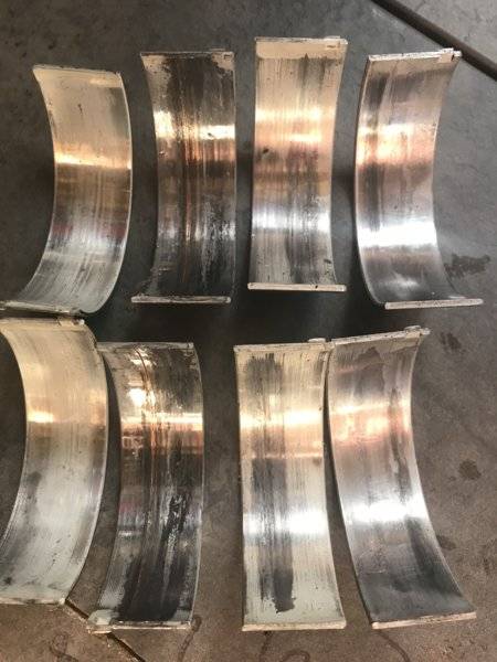

Ok got to 7 and 8 in the pictures they are from left to right 8,7,6,5 seven looks to be in the worst shape. The crank was perfect no bluing scarring or grooving.
Here are 4,3 left to right.
2,1 coming soon. Last prayer needed.. I think.. :) IMG_0610[1].JPG
damn lucky my friend what about the top end. cam lifters etc are they good.
Those will be next I have a good weekend coming up so will have time to check it out. Really hoping I didn't wipe the cam out.
Ouch all of these bearings came out easy. Just need to inspect the cam and lifters hope it all looks good worst case a set of cam bearings will be purchased.
bbrr looks like the mopar god may have been watching out for you. have a great weekend update please when you find out more.
